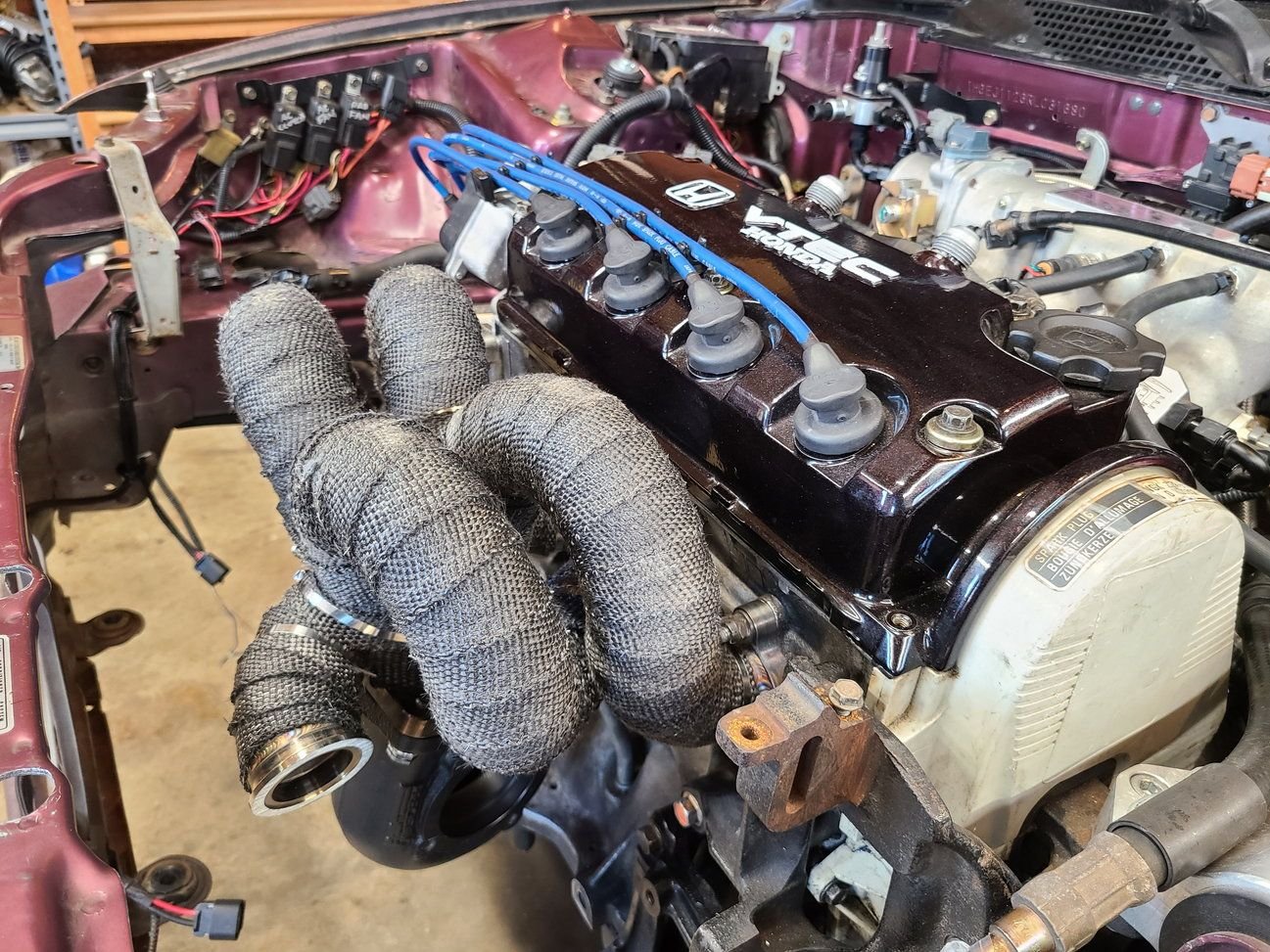

I just wrapped mine. From prior experience wrapping the downpipe, the only drawback I see is that it will discolor your stainless steel exhaust manifold, if that bothers you. I'm doing it to protect the AC components and reduce heat in the engine bay. I can't comment on improved spool.

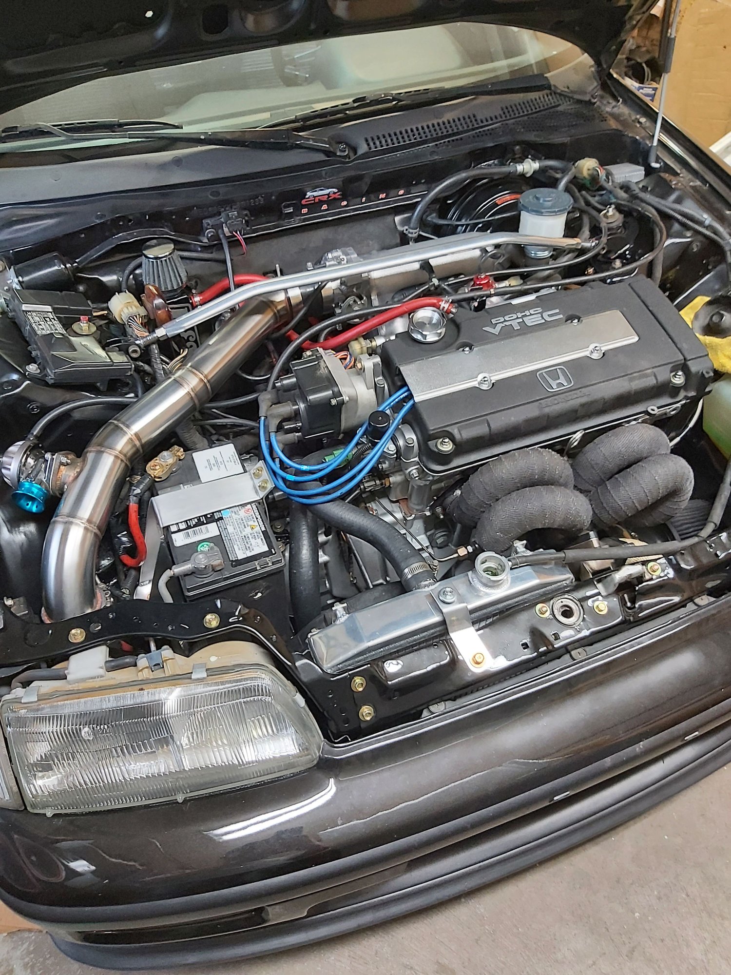

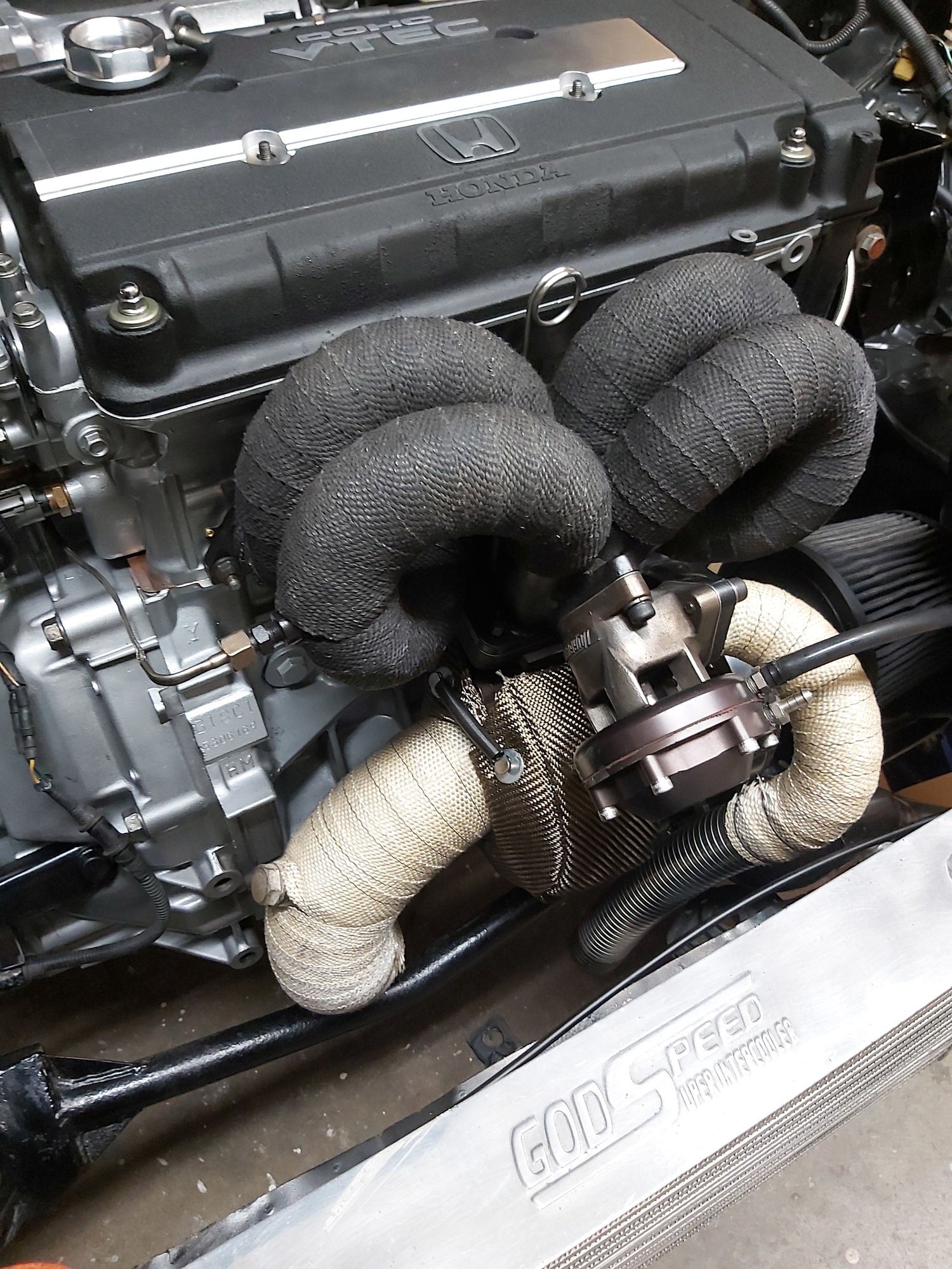

Using the wrap is like night and day temperature wise.. I can get off a hwy pop the hood and grab my exhaust manifold with my bare hand. Spool increase time is very minimal but there is a gain, at least on my setup there was.
Soaking the wrap in water was the way to go about getting nice tight wraps, wrapping it dry is sorta difficult to get it tight and looks kind of shitty but not terrible.
I also used the nicest I could find of cheap $30 ebay special turbo blankets and that also helped alot and looks great. Just make sure to do a good few 5 min heat cycles drives with it on to break it in. It will smoke! But after 3 short drives it maintains in tact and stops smoking.
For wraps, they look great when done right, personally never had any cracking issues - I would almost think it helps a bit from cracking since the temperature fluctuations will be slow when cooling down. Radiant heat coming off the exhaust is cut down to nearly 25% and overall a no brainer for the benefits.
