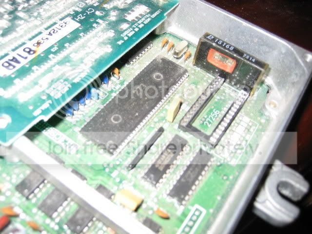

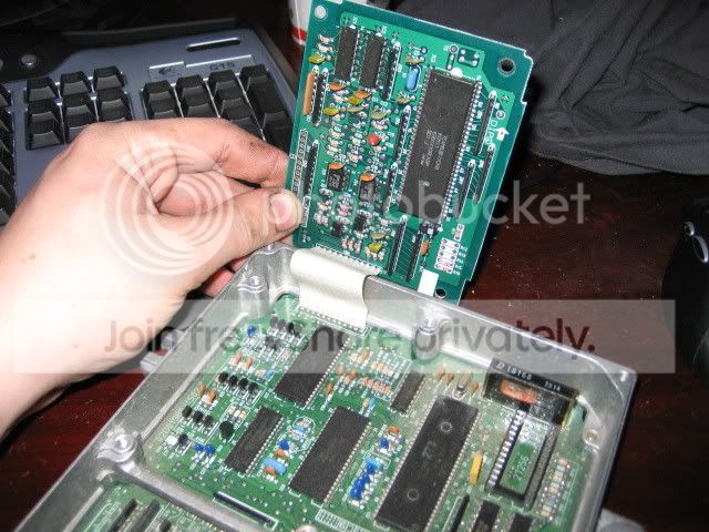

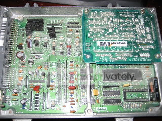

Please bear with me, I have NO knowledge AT ALL about ecu tuneing. Every time I search for Chrome all I get is people talking about basemaps and similar stuff like that... I have NO idea what kind of HARDWARE I need. I don't think software will matter because I'm takeing it to have it tuned.
Here is my ecu. Could you please tell me if this looks right and also if there is anymore hardware i will need to run something like Crome pro.

Apparently, for use of an external rom, I need...
"The provision for an external ROM was made in the board design, and it can be activated by adding a 74 HC373, a resistor, two capacitors, J1 and a socket for the ROM itself. <- This mostly refers to the USDM ECU's. I have not seen evidence otherwise for JDM as most already have external ROM's present. Not sure for EDM ."
from http://www.pgmfi.org/twiki/bin...aECUs
How do i tell if the modded ecu I have hasw all of that stuff done to it?

To sort out some of your confusion, crome/neptune/hondata all require the basic chipping stuff (resistor, capacitors, jumper, the small chip, 28pin socket). They all use the stock ecu, and if that is the picture of your P72, its best set up for crome atm, but will work with neptune or hondata.
With crome, you find a tuner, put in a basemap, hook ecu to laptop, and datalog. You'll usually want a dyno to test it on, but you're set atm for pretty much any tuner.
BTW don't run the car with large injectors and just the stock ecu tune. You will dump too much gas into the cylinders, and wash out the rings (no ring seal, tons of blowby, etc).

Yes, that is MY p72 itself. If I'm set up for my tuner as is right now, thats what I needed to know. Awesome
