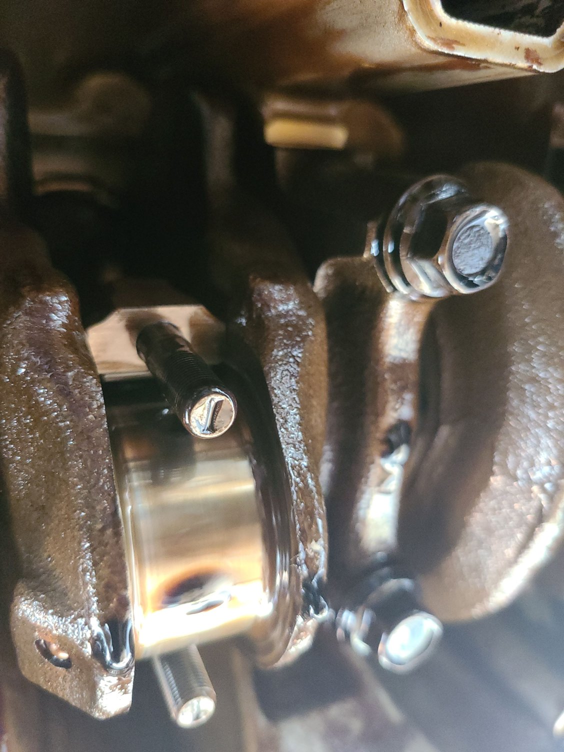

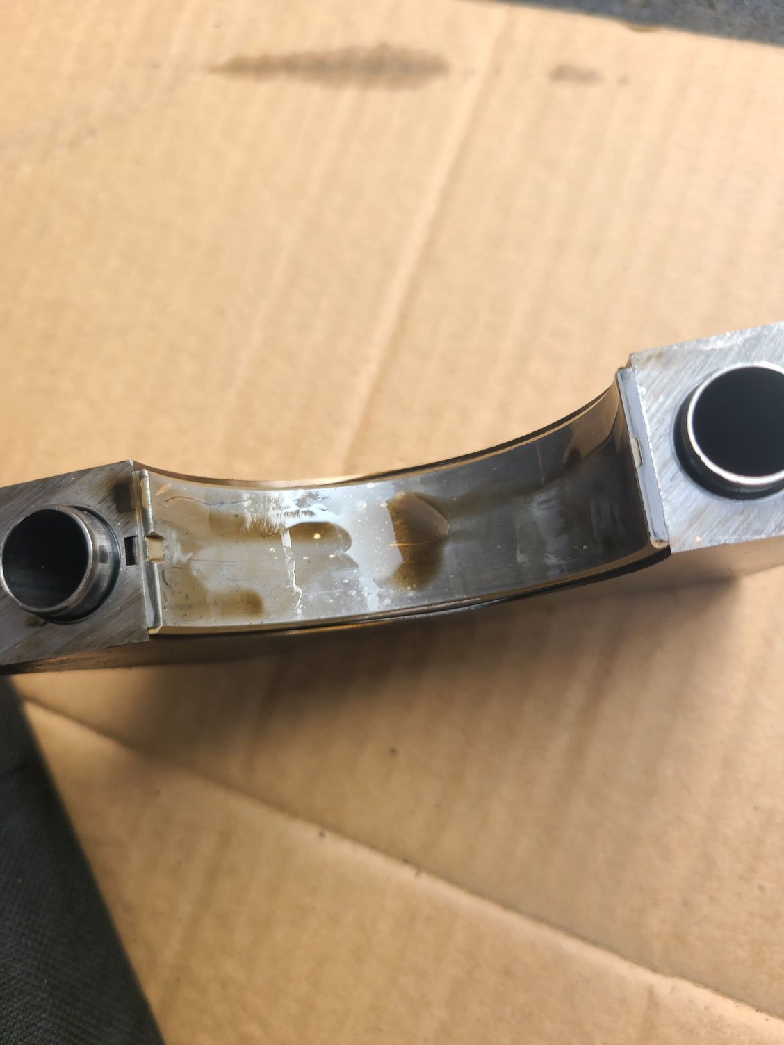

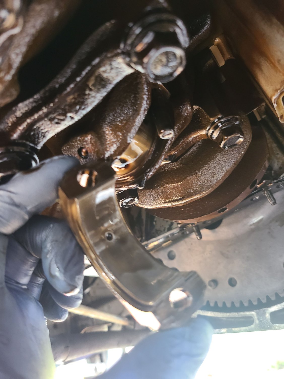

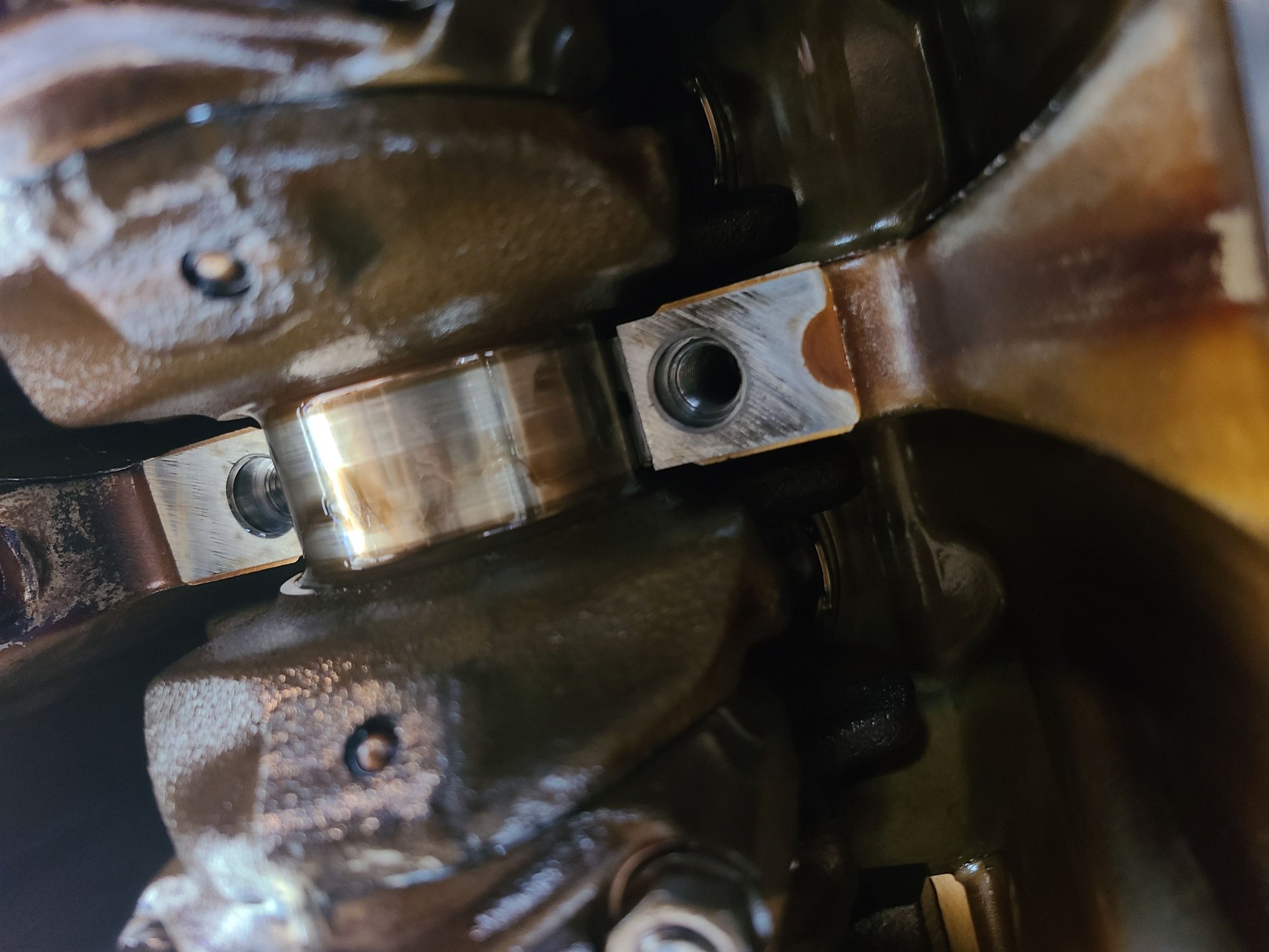

Took some pics of the rod and crank bearings and they are pristine, minus a few minor scratches. For an old b18a with prob 200k+, they look almost brand new lol. I don't know the actual mileage, I bought it used. Journals on crank are smooth. Should I check all main bearings? It's looking like it's not a bottom end problem.
