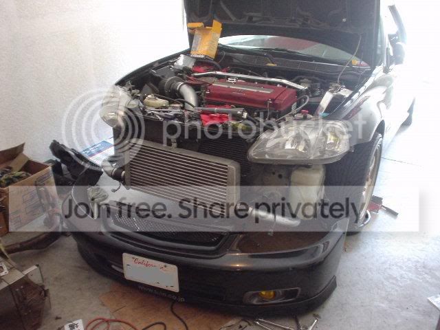

Nice. I'm gettin ready to boost my motor on the car in my avatar. Hopefully I can clear the foglights like you did and not have to remove them

12SEC CIV - did you also keep your oem bumper support as well?

Its possible. I used the OEM fogs and mounts too. I had to remove the inner brackets though. For this particular intercooler you'll have to modify the bumper support.

im running a drag kit intercooler with both my bumper support and the oe fogs. you have to take the bottom longer bracket for the fogs and unscrew the one screw and bend it straight upward, cause its like directly in the way of the piping. once you do that, it fits like money
