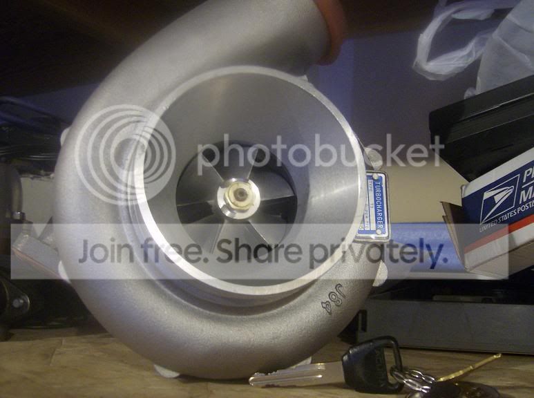

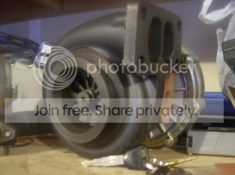

hmm sounds like thats a different one than i have, this is a ssac turbo, here are a couple pics...this one has a p-trim wheel also.

The difference is in a turbine housing. They sell both styles, you know.

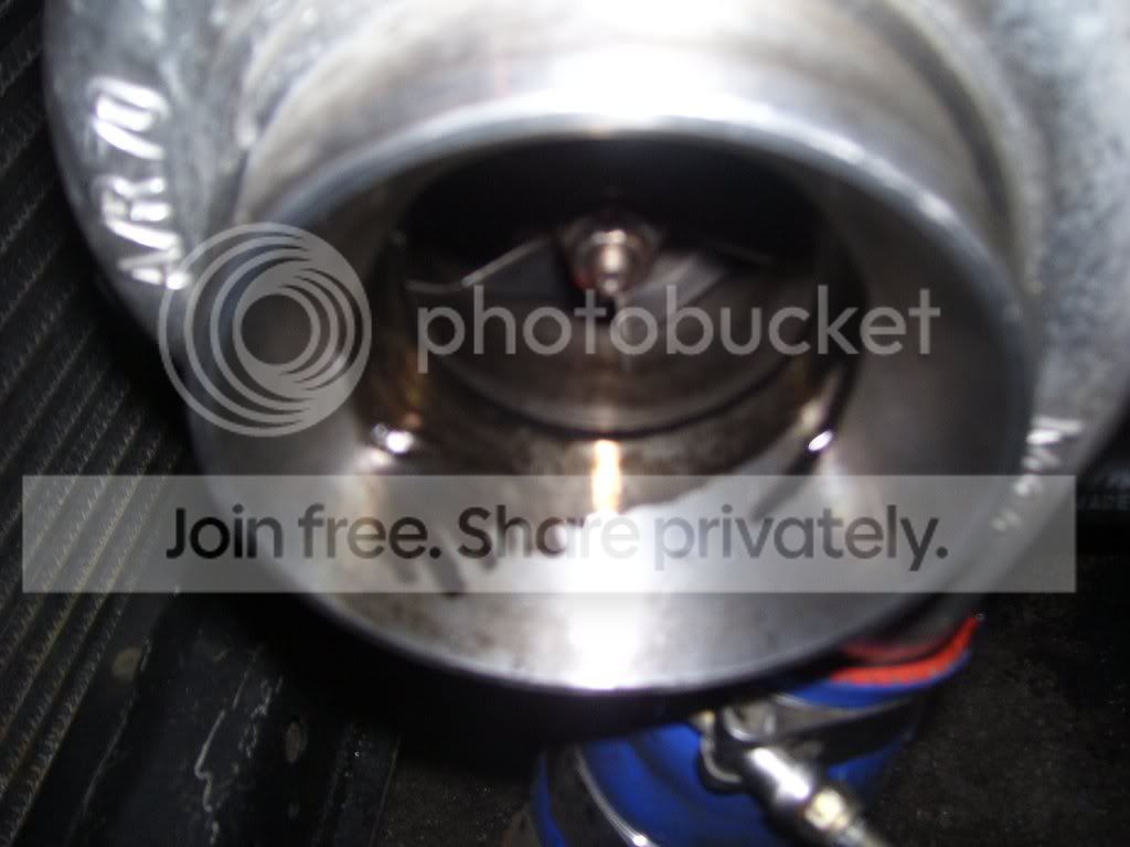

is that oil if so did you run a oil restrictor
