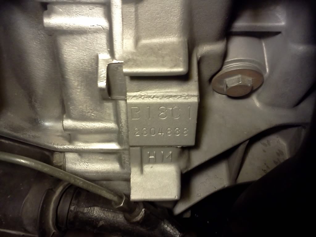

Motor setup:
-B18c1 block Golden Eagle sleeved to 84mm
-Ls/B20 crankshaft balanced and polished
-Clevite race bearings
-Eagle rods
-Wiesco 84mm 10.5:1 cp
-GE headgasket
-GE head studs
-B16 Head,cumbustion chambers opened to 84mm and polished
-Supertec valve train
-OEM GSR water and oil pumps and also timing belt
-Victor X
-68mm STR throttle body
-AEM fuel rail
-Aeromotive FPR
-ACT Xtreme street clutch
-Neptune ecu with launch controll and shift light.
So this is how it started.
