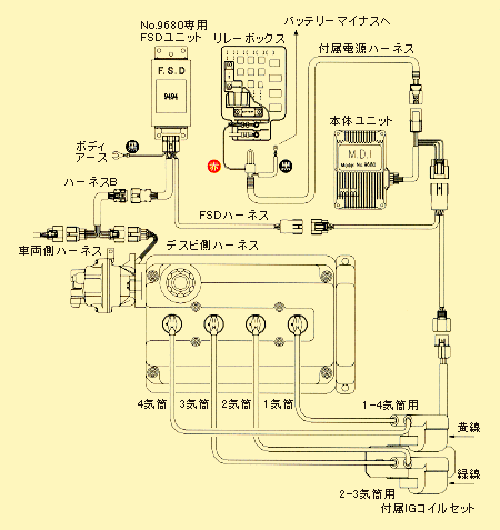

Nagaidenshi markets a multi coil setup for Honda's over here that uses a OEM single coil output to drive (4) coils. Too bad it has a typical JDM price ($825). For this price the setup should have also included a new Hall Effect sensor so the distributor can be completely removed.
There should be some way to make a COP setup with CBR coils work with Hondata, Uberdata and other OEM type setups.

Yes Dee, I have heard of that. Jeff Evans was telling me about it when I saw him at SEMA AC not too long ago. Problem is, the price

I have to money to "waste" but I'd rather have a product that totally removes the crappy distributor. I will find a way to use COP with a single coil output.
Oh yeah, the MDI ignition has been on the market for at least 3 years.
