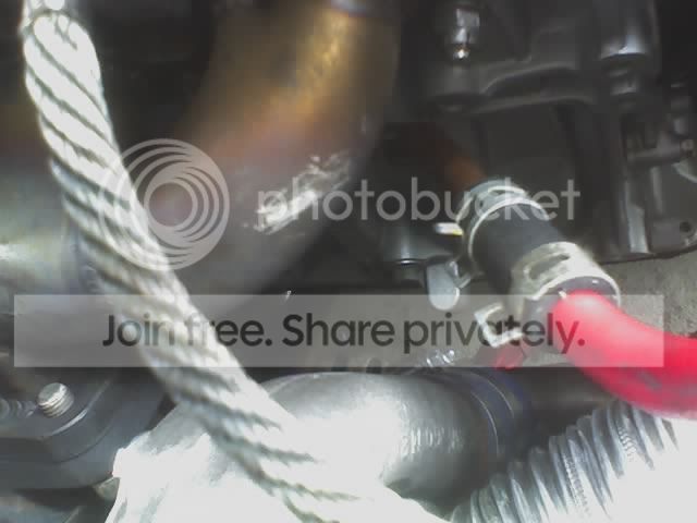

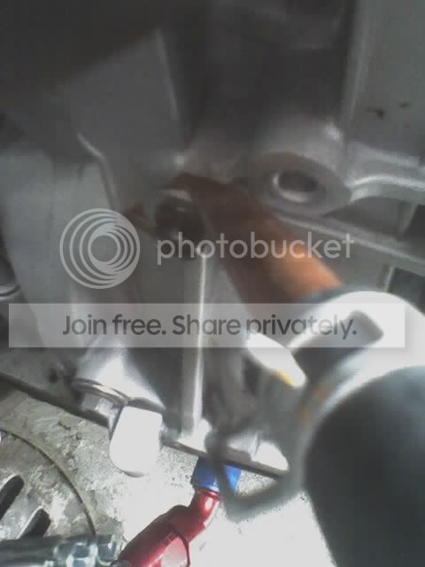

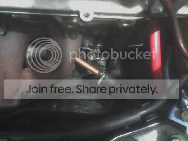

Old Jun 16, 2006 | 08:04 AM
  #236
raene's Avatar
Joined: Oct 2000
Posts: 4,440
From: Surrey, BC, Canada
Default Re: (GaRn)
I haven't tried it on the head, works well on the block.
This kinda shows how mine is made I'll try and remember to get pics if I ever leave work.
Old Jun 19, 2006 | 09:05 AM
  #237
raene's Avatar
Joined: Oct 2000
Posts: 4,440
Default Re: (raene)
OK here's some real pics. The red hose is an air line that's been shaved down to fit inside the tube. The hose overtop it with the two clamps is just a brace to hold the two halves together, I'm a ghetto bastard. First pic's my brother's n/a LS/VTEC, the next is my turbo LS/VTEC.
