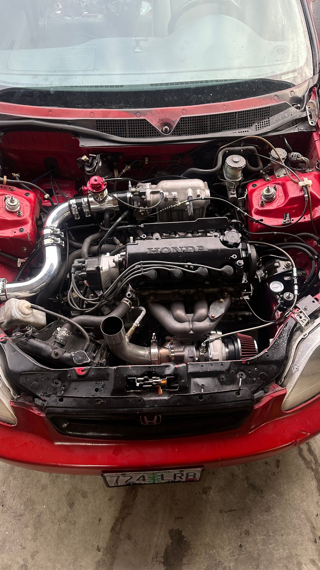

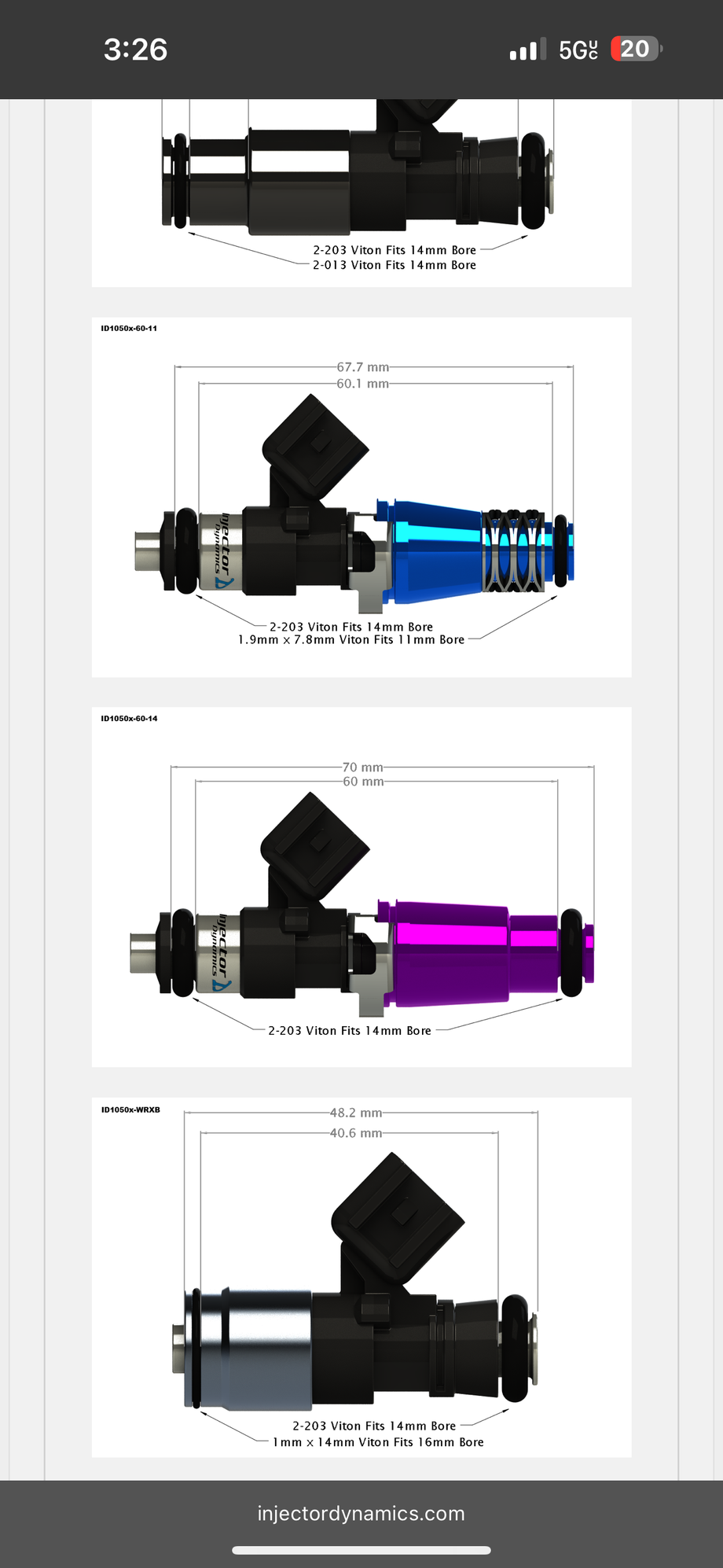

Anyone running the ID 1050x? From the provided dimensions it doesn’t look like they’ll fit but my tuner is saying they’re gonna work. Specifically running the 1050.60.11.14.4
running out of fuel at 4500 rpm and low boost on the stock injectors. Tuner recommends the ID1050x so I ordered but I’m worried they won’t fit.
setup is super fun so far but it’s nutered, I want to be able to ring her out and make some real power.
d16y7 speed factory no notch rods, YCP vitara pistons, acl bearings, machine work, stock head, y8 intake, gt2871, Walbro 450, an6 fuel lines, stock injectors haltech ecu and wideband, aem style rail
