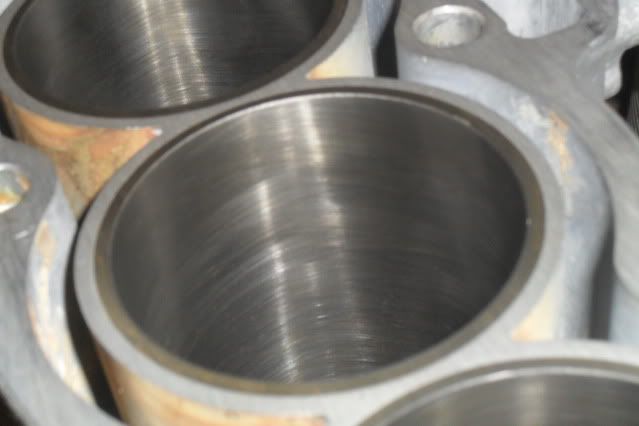

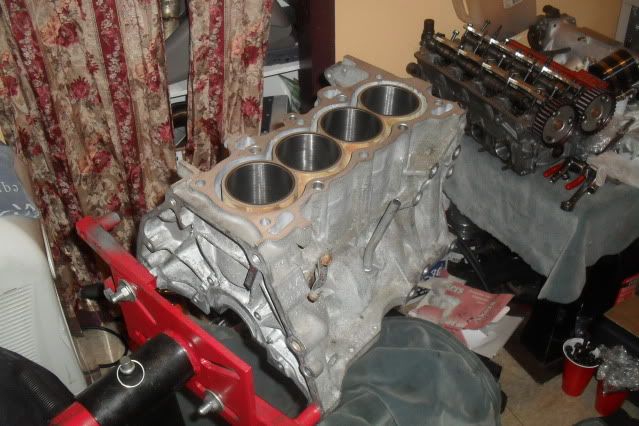

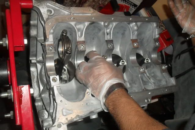

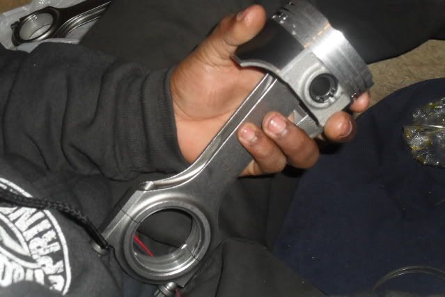

The engine is in horrible shape, it would have never run properly and the machine work done on it is questionable at best.

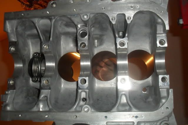

My girdle or cradle w/e is a total mess & the rods I don’t know what wrong with those. It was either a poor attempt on balancing or just or the girdle was notched with the rods installed or something... I don’t know.
I never expected that the source of all my problems would be the cylinders themselves. I figured since they where professionally done that shouldn’t be the problem. My error on that I should have taken the motor apart to double check. The P2W at .0085 is the equivalent on having all four rings blown. Looking at videos of cars with blown rings on you tube and its the same exact thing that is happening to me. The 156 comp results just threw me off

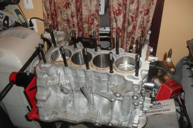

Anyway I am kind of disappointed that the same exact time last year I was buying pistons and breaking apart my block, and here I am doing it again. Its whatever at this point but I hope it doesn’t take me another year to get this running.
Parts are trickling in again i guess, I got the 75.5 pistons in today and bring the motor to a machine shop on Friday to bore it
so the rods were making contact with the girdle?
i can't really tell from pic
are you re-using the rods then?
and the 75mm vitaras were loose in the bore? or cyl's out of round?

The cylinders aren't egg shaped, just to big for the pistons. The motor stock ran fine, no smoke at all, I even gave the stock internals away and checked out fine. When I found out the p2w was .85 I just laughed even though I died a little inside.
on the girdle
What you see there on the girdle is a poor attempt on notching. My rods are also chewed up on random places which frankly pissed me off. I will post photos later

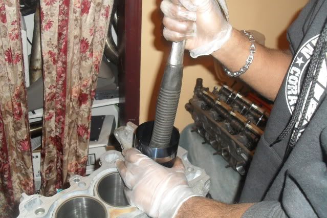

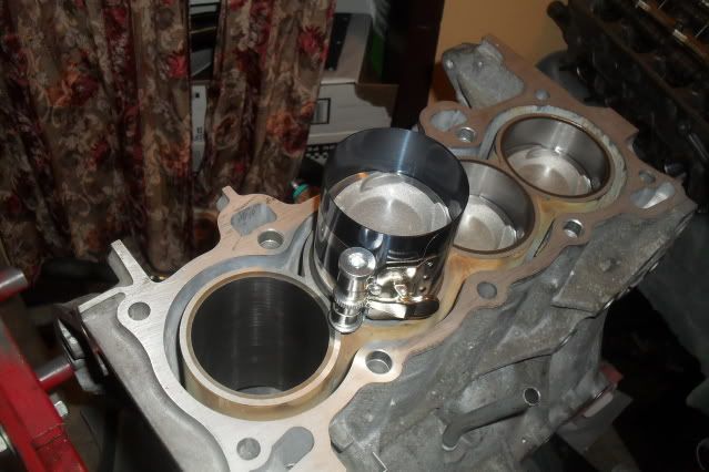

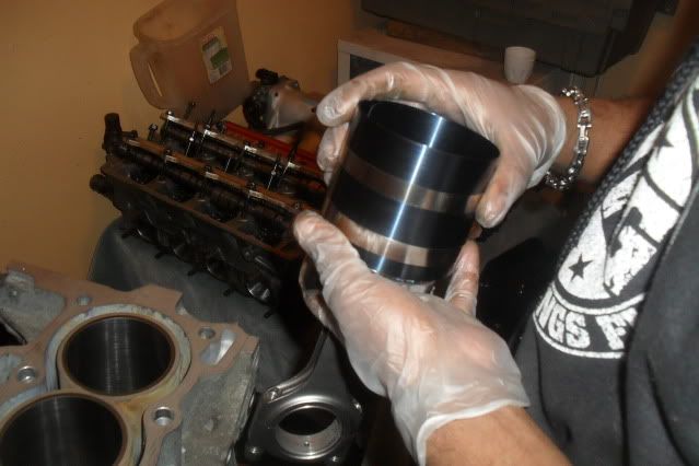

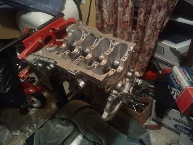

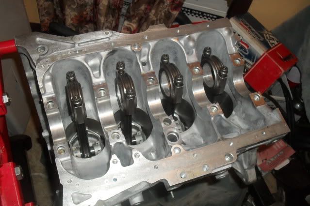

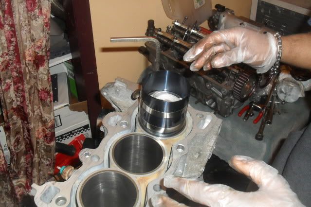

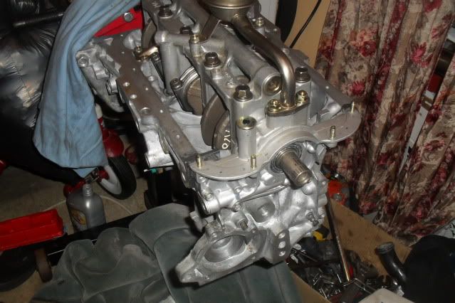

Well I am really not doing much right now on the motor, a friend that happens to be a master tech is building the motor .
Assembled shortblock in less than 1 1/2 hours

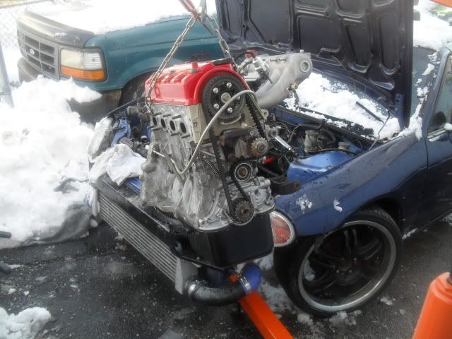

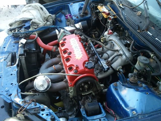

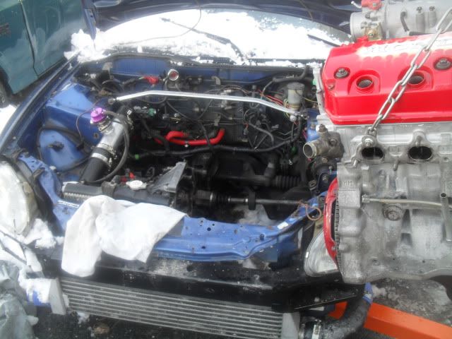

Well hello honda tech, its been a few weeks, going to be vague with this update because I don't feel like going into it.
Motor installed
I am having residual issues from my previous setup. The engine doesn't want to start and when it does, it doesn't stay running or run properly. I have gone through everything and I cant seem to get the problem to go away. On the photo below it has stock injectors on. They will suffice for break in with a 7psi/5k fuel cut.
So instead of freezing my *** off and flooding the motor by stupid trial and error, I am going to do what I do best. Just buy everything all over again, new dizzy, map, tps, iacv, Iat, fpr, fuel filter, all of THEM! Screw it the car is going to be 20 years old soon it will only help me in the long run.
Btw went back to the OEM FPR, the blox one cant hold pressure at all, not sure what happened to it.......AEM here I come
