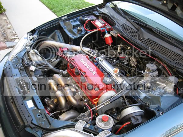

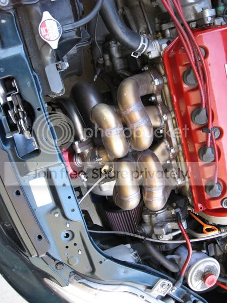

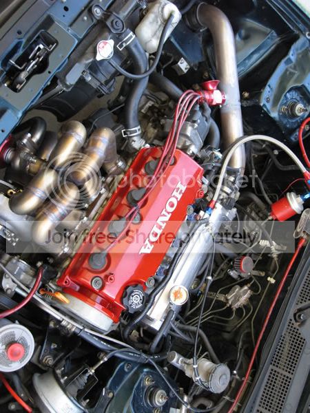

I would like to see pictures of your engine/ garage.
By the way I think you and JD are assets to HT and I pay attention to stuff that both of you post.
I plan to buy a rod bolt strech gauge on your advise
I built the engine, I did all the fab work, and I tuned it on the street with a wideband and a stethescope det-can. Forgive me if I haven't had the time/ambition to fill it with race gas and get it dyno'd. I could show you a picture of the $8,000+ y8 engine sitting in my bay, or the garage littered with dismantled z6 and y8 engines that I've accumulated over the years, but I suppose I have no "e-cred" without a piece of paper to show off. I for one don't base the size of my e-***** on dyno charts, but if you'd like, I can photoshop any dyno curve you want. Just tell me what you what the optimum powerband to look like in order for me to gain the maximum number of ***** enlarging inches.</TD></TR></TABLE>
<TABLE WIDTH="90%" CELLSPACING=0 CELLPADDING=0 ALIGN=CENTER><TR><TD>Quote, originally posted by katoeh2o »</TD></TR><TR><TD CLASS="quote">I would like to see pictures of your engine/ garage.</TD></TR></TABLE>
Dang, you're actually going to call me on that?!
. Okay, I just snapped these. I took a few of my garage too, but now that I look at the cluttered, junk filled mess I call a garage, I'm not sure if I want to post those...
<TABLE WIDTH="90%" CELLSPACING=0 CELLPADDING=0 ALIGN=CENTER><TR><TD>Quote »</TD></TR><TR><TD CLASS="quote">I plan to buy a rod bolt strech gauge on your advise
<TABLE WIDTH="90%" CELLSPACING=0 CELLPADDING=0 ALIGN=CENTER><TR><TD>Quote, originally posted by civdx94 »</TD></TR><TR><TD CLASS="quote">^^^ Is that a custom plenum on stock runners or an actual production manifold?</TD></TR></TABLE>
It's both, really. It is a custom plenum welded/ported to stock runners, but it's also a production piece. JG makes them. Or at least they used to. They've changed their design now and use a much larger plenum.
It's a pretty good manifold, but it lacks velocity stacks. It's also incredibly loud. It makes a high-pitched whining noise under load which sounds very similar to a turbo spooling. I wouldn't recommend it on a "street" car. The sound would drive me nuts, except my motor mounts and exhaust already make the car so loud and rattly that I can't even hear it anymore.
It also doesn't come with an IACV boss, which is why I had to mount my IAC valve on the firewall. That's what the little K&N filter is going to.
No no no, it's an RFL knock-off; $30 on ebay. It blows off pretty good. Today it blew right off the flange and shot across my engine bay. Good times. Also note the partially primered charge pipe and the 4gauge fused wire leading to no where
