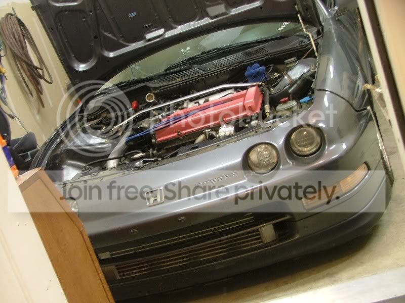

Default Re: Cutting OEM Integra bumper for FMIC? (jBj)
sorry for the dealy, hopefully ya check this in the mornin.. anyways hers some big pics:
and with the bumper off and IC mounted..
and with the front bumper on....
hope they helped ya out a little, anymore questions or pics needed just ask

the shop that did my fmic install hacked the **** out of my front bumper cover, and the fm still hangs below the bottom of the bumper. it all doesnt look bad and im planning on covering the bottom with a lip of some kind. im sure theres no right or wrong way to do this (within reason), so do whatever makes you comfortable/happy, without destroying your bumper or fmic...

Well I got 'er done and it turned out pretty good. With the help of a die grinder, exacto knife and a file. Took a couple pics but the sun was setting, maybe i'll snap another today.
btw-not an R ....just a new bumper.
