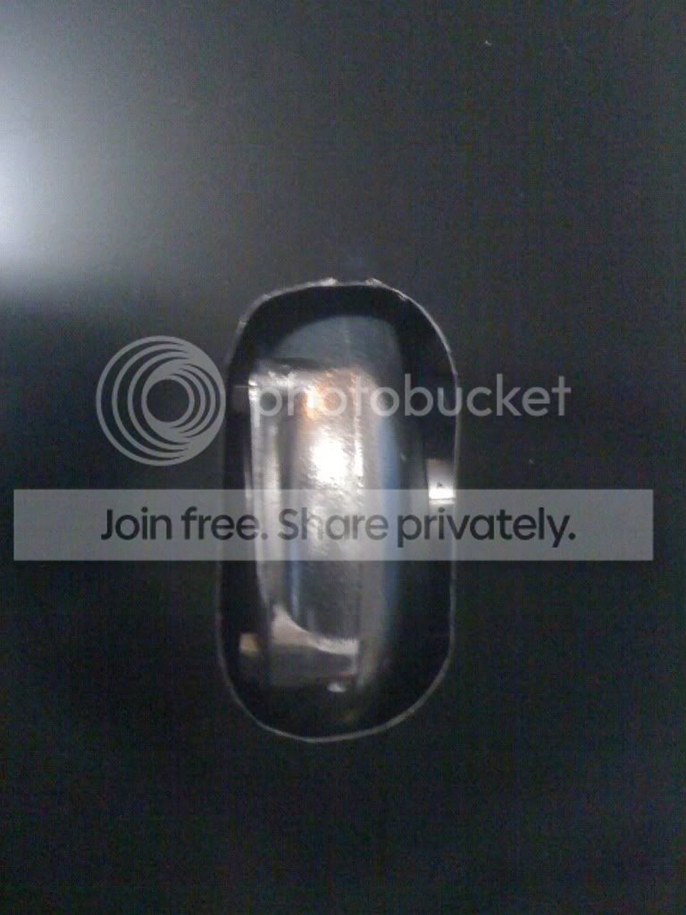

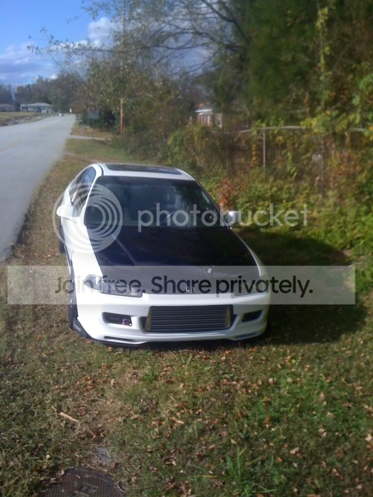

You don't want to run an SPA Top mount manifold with an HY35 on most civics or Integras due to clearance issues.
I know you want to see this
But you'll more than likely have this
which only YOU can be the judge whether or not you want that. No one is passing judgment, just showing you what you'll have.
