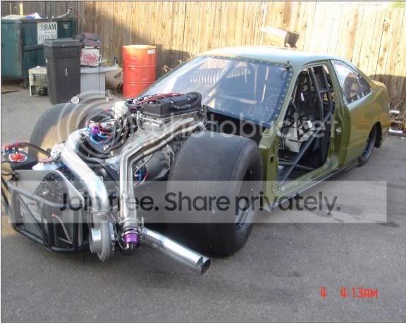

I'm not sure, I'm running 28psi on E85... The plugs were standard ngks (I believe 24) and they were being blown out. How can the small gap melt a piston? Not to thread jack but anyone else care to comment how small you can gap your plugs?
As far as the tuner, he built the first hondas in colorado to run 12's 11's 10's and 9's. Remember this car? He built and drives it... I think he knows what he's doing
