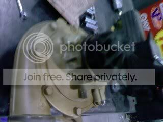

<TABLE WIDTH="90%" CELLSPACING=0 CELLPADDING=0 ALIGN=CENTER><TR><TD>Quote, originally posted by mat1 &raquo;</TD></TR><TR><TD CLASS="quote">will i spool the borg? can imake boost i realy want to use this turbo. plese dont fight
You <u>CAN</u> use it, but you're going to have a terrible powerband. I hope that you dont plan to ever drive it on the street...

how do you mean? iam going to get it rebuilt and use it. thanks for the help guys.

Ok...if this is even the smallest S300 offered currently (S362), you're still looking at a 600whp turbo. Your Vitara D is good for ~400whp. If you want a crappy powerband, go for it, but the results are going to be less than amazing. Nobody has said that you can't use it, but it is FAR from your best option.
BTW I dont see the point of asking this question if you're not going to listen to any of the advice...

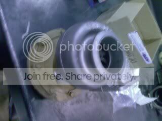

i bead blasted the turbine housing. it is not as big a i thought.
would running nos help spool it or not?
