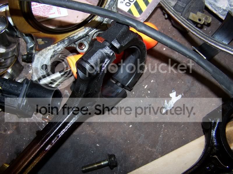

last thursday night, my buddy in his k20 eg coupe, another friend in his 06 STi, and another dude with an LS-VTEC CRX were cruising around looking for races....i ran the STi and for some reason the hatch wasn't running as well as usual and he got me by about half a car. We got on the highway and did some highway runs for a while, and i hit 7500rpm in 4th, then shut it down. We got off the highway to turn around and do it again. As I was getting into the throttle, I noticed a slight knock that at that time I thought was a rattle....I got off at the next exit and everyone followed me.
We all pulled into a gas station, and I popped the hood just to check everything out. I couldn't figure out where it was coming from and all of the sudden it wasn't making any noise...so I revved it up to about 3k and held it there. Sure enough, it was knocking. We let it cool off then I attempted to get it home. Keep in mind, i was about 26 miles from home.
45 minutes later we finally hit the road, and I stayed out of boost, and kept it under 3k. About halfway home the knock was really pronounced. To make a long story a bit less long, after 24.7 miles, it finally let loose. I started losing oil pressure, so i just downshifted to 4th and got into boost. Ching ching ching BOOOOOOM LOL. I left a smoke screen, chunks of metal and 5 quarts of oil on the highway LAWL. My friend in the k20 eg said the smoke was so thick that he had to pull into another lane and slow down to 10mph to see and avoid being hit by chunks of my bottom end. luckily it was about a mile from my house.
We finally got the car back to my house and yanked the motor out. It through the rod through the girdle and out the bottom of the pan, taking a chunk of sleeve out with it. 2 other bearings ended up being spun. So much went wrong that i'm not sure what caused what....but i think i bent the number 4 rod, and it just got worse from there (i had oil pressure almost the whole way home, until that last little stretch).
I already have another motor ready to go in, and my ported, polished head with valvetrain and cam wasn't damaged
Im just glad that it lasted for 9 months with 10:1+ compression and boost.
and now for the pics
BLACK = HOTTTTT

Are those the stock D16 rods?

I can follow the progress of the destruction. This was nothing more than a spun bearing. Bearing spins, heating up the rod and causing the tick. Rod end eventually gets hot enough that it stretches into an oval, leaving room for the rod to rattle around on the crank.
Hit boost, rod fractures at the big end, ejected out oil pan taking girdle with it. Rod jammed by crank into the sleeve, bent and broken, with the seperated part also ejected through the oil pan. The rest of the bearings and rods take damage due to twisting the crankshaft. You're just lucky that the rod went down instead of up.

why shut it off, its just a d series blocks are a dime a dozen, finding one without a spun bearing, or shot rings is another story. To be honest, even if it got into the head I wouldn't have been that upset, I have another one hanging out in the garage somewhere. The most that i'm going to have to spend is 200 bucks to get another short block, and thats if I get screwed. Most people around here sell running motors for around that.
and yes, it was a completely stock bottom end.
I</TD></TR></TABLE> It may have been a spun bearing, but I had normal oil pressure right up until the motor completely failed, which is what let me to believe that it wasn't a bearing. D series are notorious for bending rods and still running for a while....and even running somewhat normal at certain RPM's. bah, whatever, its over now. I just need to put it back together now, im having boost withdrawls

nice carnage and goes to show ya that d series are fun fast and cheap!!
