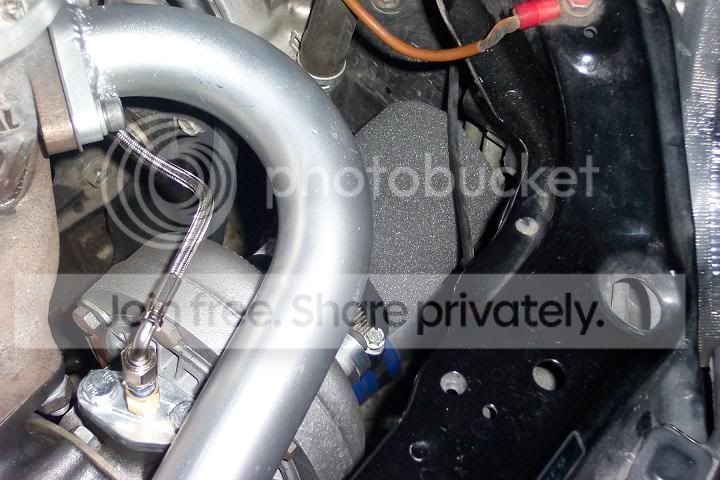

Be careful which cloth you choose though for your filter... I used a section of an old fleece blanket that I had laying around .... you can see it here...
But, it was choking my turbo and I couldn't reach full boost... it just wasn't allowing enough air through it for my turbo to funciton properly... I replaced it with a filter and solved the problem...
