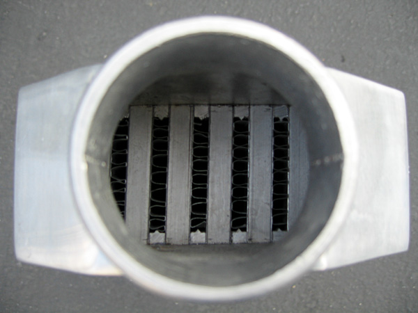

see pictures for referrance
in this order
Vibrant
Precision
Mishimoto
godspeed
cxracing

I had the CX racing unit, looks like the bottom one in the post above me. 3.5" thick core. Held over 25psi no issues, seemed to cool fine, over 350whp 8:1 sohc non vtec on 92 octane

My post:
Mishimoto Core:
MY CX racing Core (Same thickness as Mishimoto):
Mishimotos old tube and fins were even worse. Your paying an extra $100 for the name on a core that isnt as good.
