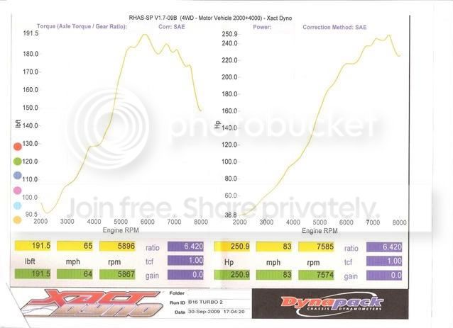

Okay I have a boosted 2000 Civic Si with,
Stock B16A2 Block
Bored .20 over
SRP 9.1:1 Pistons
Eagle H Beam Rods
Turbonetics t3/t4 .57 trim .63 a/r
Drag exhaust manifold
38mm Cheapo Wastegate - 11 PSI Spring
Greddy Bov
RC 550cc injectors
2.5" Downpipe
2.5" Exhaust
Drag I/C 6.5" height
Hondata S300
Walbro 255
The tuner was able to bring out 251 whp on 11 psi but these numbers sounds to low to me. He told me the bearings were going out in the turbo and it was causing me a powerloss but from what I've saw with others setups I should atleast be 270+ whp on 11 psi? What's the problem? Is the tune bad?
I'm planning on rebuilding the turbo, getting a full 3" from turbo out, and a new tune and I'm wondering if I should go back to this shop.
Heres my dyno sheet. Lemme know what you think!

Let me see a pic of the dyno plot. You can email me the calibration also.

from the dyno, looks like something is choking it off up top, it drops boost a bit, but should pull higher than that. numbers seem fine for a 9:1 b16 to me

For 9:1 CR, looks right for this turbo size and a Drag log manifold.

I think the turbo is robbing you of power... on a 11psi and a 57 trim... you should be close to 300whp...
Exhaust is a slight restriction... Replace the turbo and get a new tuner

seems a little low....my # might help stock b16a t3/t4 garrett .63 57 trim. ramhorn, 3inch down pipe and exhaust. made 325whp at 11 psi
Yea this is why I question my tune...
Even though you have a couple things upgraded you have 75 whp on me with same turbo and psi.

this could be a sign of turbo failure. sounds more like the thrust bearings themselves are wearing against the shaft. "blown seals" isn't the only way a turbo can die over time.

based on that chart showing boost....once it spools the pressure is steady....so it may be the tune.
