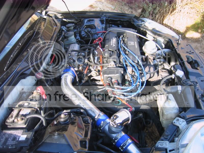

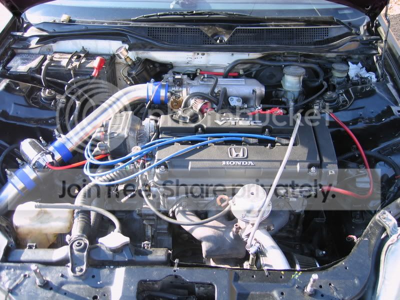

It worked!!!Problems all solved.Im not sure if the block off shield is helping but I think the old water pump wasnt circulating enough water through the system fast enough.I climbed a big hill of up to 3,000 elevation for 12 miles and it stayed cool the whole way.Thanks guys for all your input on this.Ill post a pic of the block off shield I made for my turbo.The plate mounts where the A/C condensor should be.

Heres some pics of the plate so if anyone else has this problem hope this will help!!!

so all the plate does is force the heated air to rise/fall instead of go staight against the block/head?

<TABLE WIDTH="90%" CELLSPACING=0 CELLPADDING=0 ALIGN=CENTER><TR><TD>Quote, originally posted by 95dxsir2 &raquo;</TD></TR><TR><TD CLASS="quote">so all the plate does is force the heated air to rise/fall instead of go staight against the block/head?
sweet, you let your girlfriend drive it boosted. </TD></TR></TABLE>
It forces more air into the radiator.

Yea,The hot air doesnt hit the block and head.For some reason,My car runs way cooler now and I drove it today in 100 degree weather.
