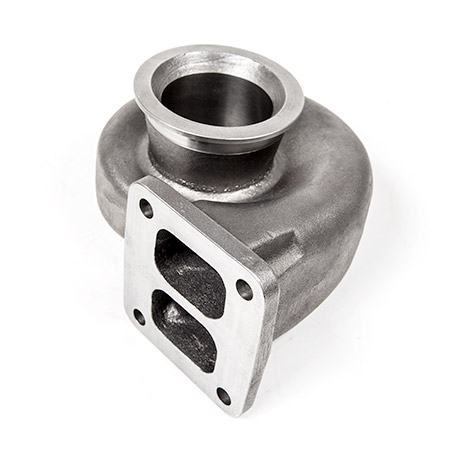

Old Dec 12, 2012 | 05:35 PM
TheShodan's Avatar
Moderator
iTrader: (14)
Joined: Jan 2002
Posts: 24,555
Likes: 242
From: City of Wind, IL, USA
Default Re: b16 project question
Originally Posted by b16projection
I do mean twin scroll dual ball bearing turbo as Im planning to use it in a build with a motor that will do just fine with how much boost a 6262 turbo can spin out
Ok. I'll make this quick..
True Twin Scroll Housing
Cross section of EFR Twin scroll:
Mitsubishi Twin scroll housing with a full channel exhaust separation is unique
Divided housing- mistaken for twin scroll due to marketing misnomer
This is simply a divided sectioning and is not a full divided channel which is what your Precision 6262 Ball bearing is.
Here's why for the output you are looking at why this is a bad idea for now unless top end only for your larger divided housing (which is why they are typically used on larger volutes)
Old Dec 12, 2012 | 05:39 PM

Old Dec 12, 2012 | 05:46 PM
TheShodan's Avatar
Moderator
iTrader: (14)
Joined: Jan 2002
Posts: 24,555
Likes: 242
The twin scroll still.
Umm.. my friend did you NOT read this? Your "twin scroll" naming convention doesn't apply to your PRECISION TURBO.
After this, i'm starting to think you're just trolling to cause a ruckus. Perhaps we should recommend that this thread not go anywhere if you're just not understanding here.
What's next? Nah nah, nah nah boo boo? What you say bounces off me and sticks to you like glue?
Old Dec 12, 2012 | 05:47 PM
wantboost's Avatar
Who is Mr Robot?
Posts: 21,474
Likes: 10
From: ATL - Where the Pimps and Players dwell
I have both divided and true twin scroll turbine housings...
There is a difference and precision does not use twin scrolls, only divided
