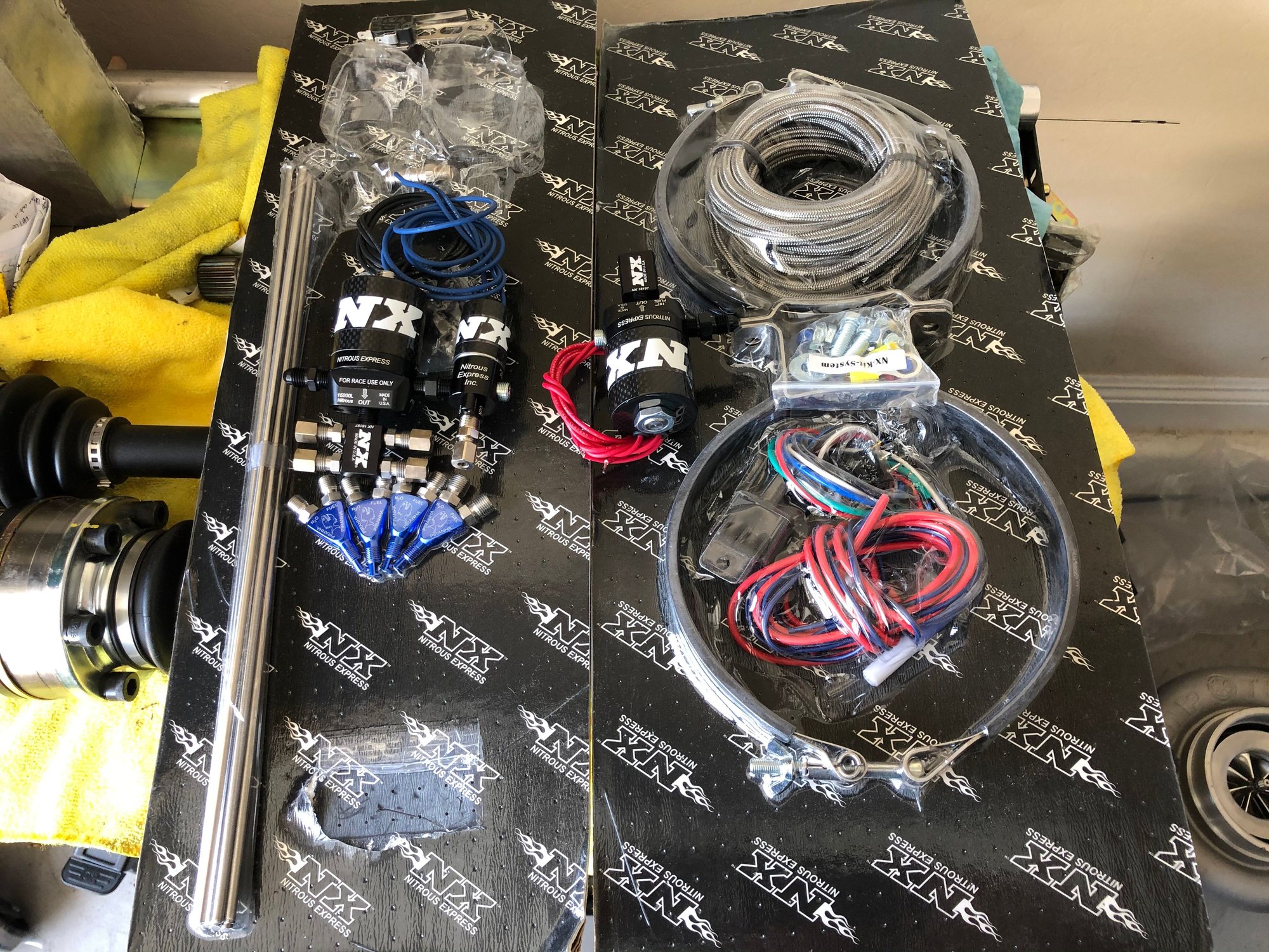

Here we go, so far I got the NX Nitrous kit, NX Purge kit, and some connectors and a relay. I also ordered some other fittings and a bottle pressure gauge.

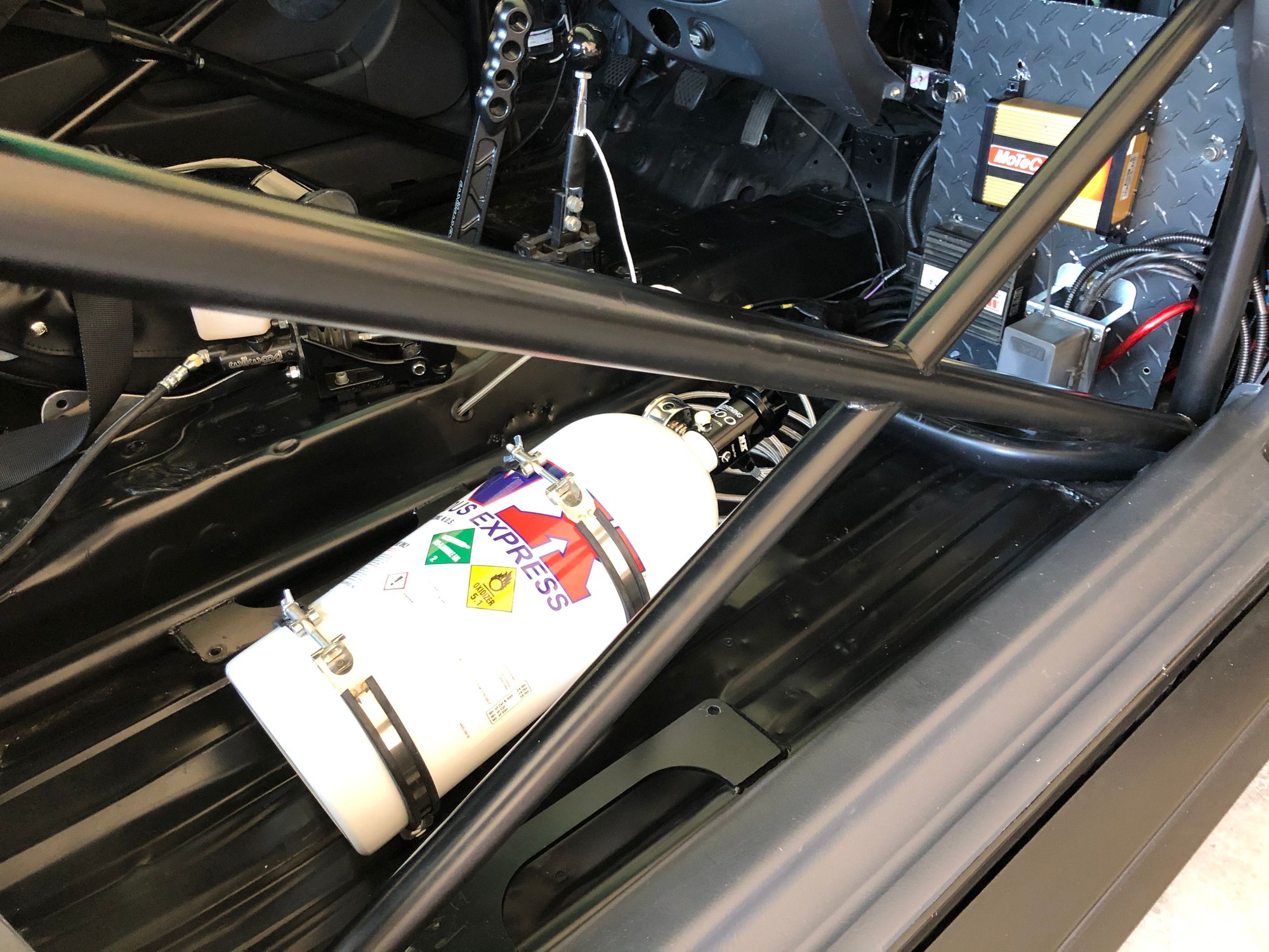

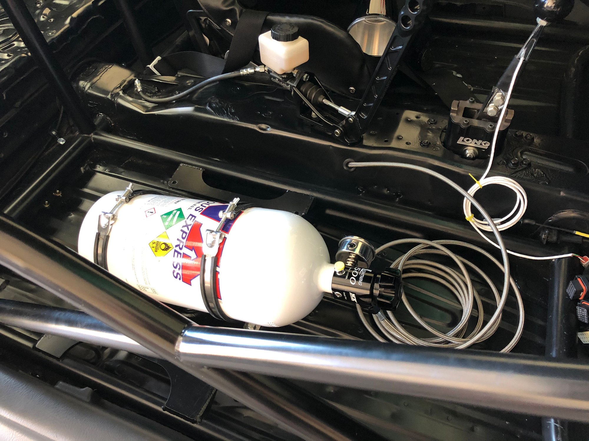

Today got a couple things done, I had to figure out where I was going to mount the bottle. Originally I was thinking of doing it behind the passenger seat but because it is bolted down it makes it hard to get to the bottle. If my son needs to turn it on as I get ready to make a pass, it will be hard to get to it. So I decided to place it on the passenger side floor next to me so I can grab see bottle pressure and turn it on or off if I need to.

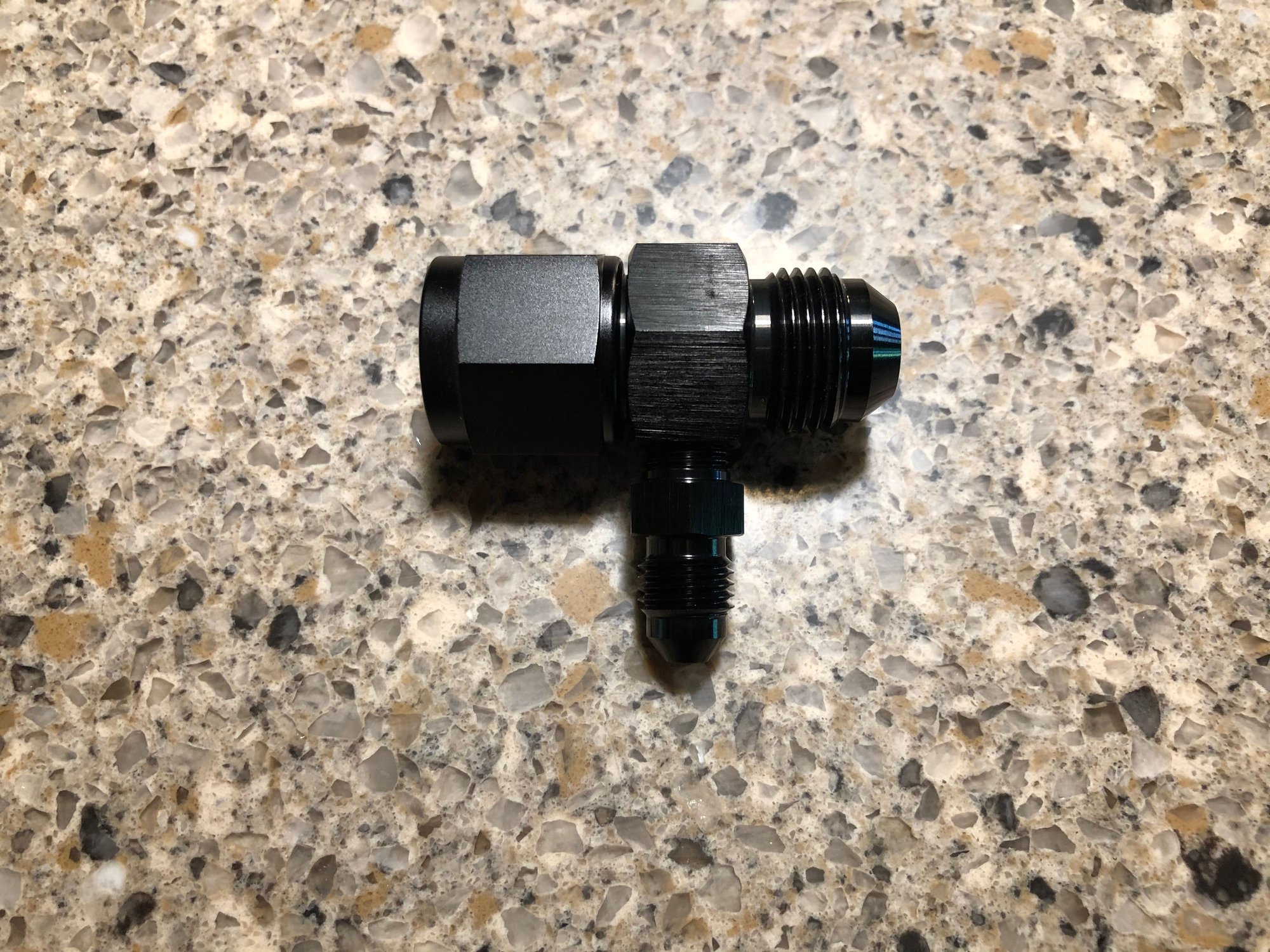

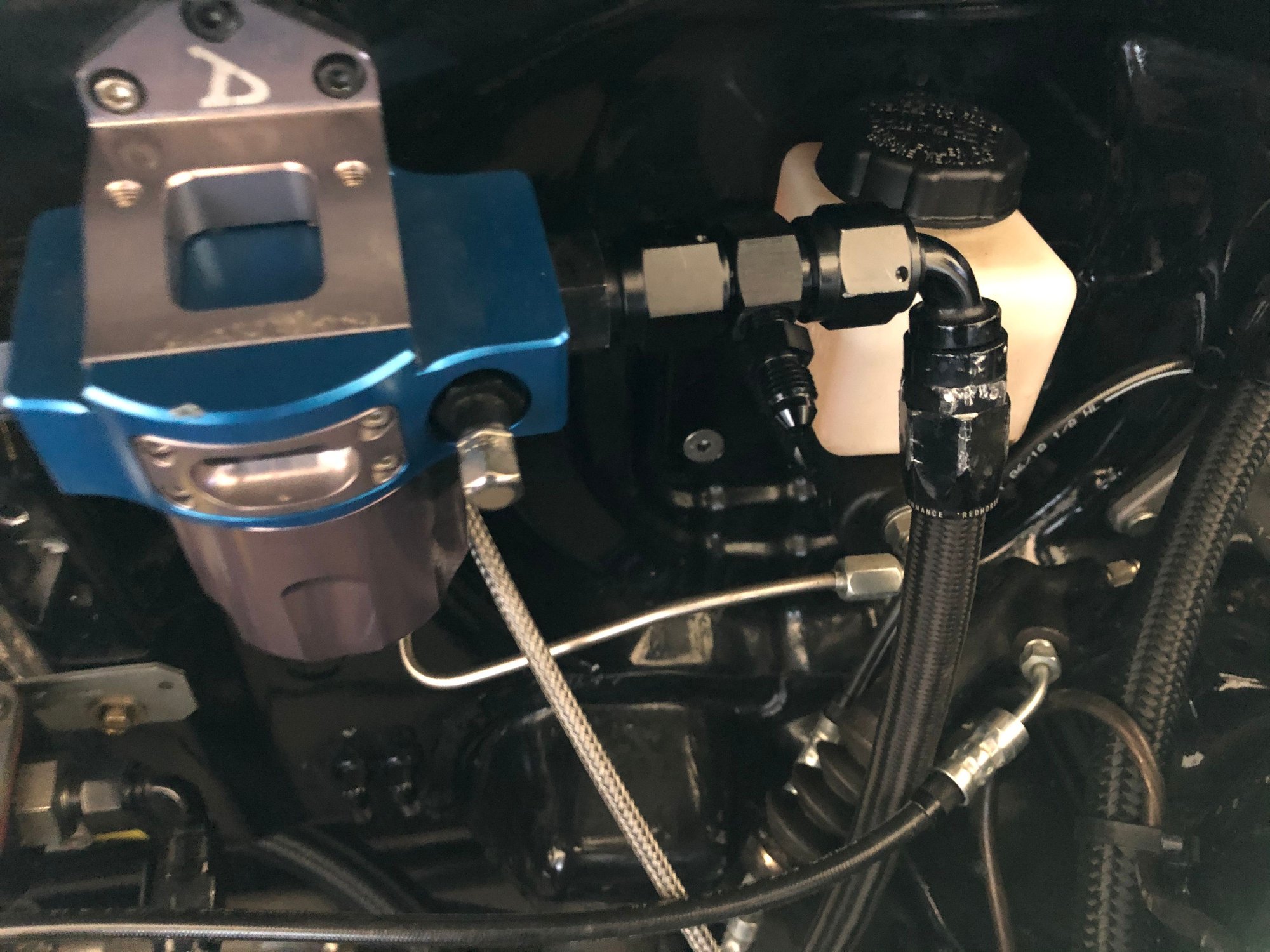

Here's what I did for the fuel: I ordered a -8 female swivel to a -8 male with a 1/8 NPT union. Then bought a 1/8 NPT to male -4 so now I can run a line directly to the fuel solenoid.

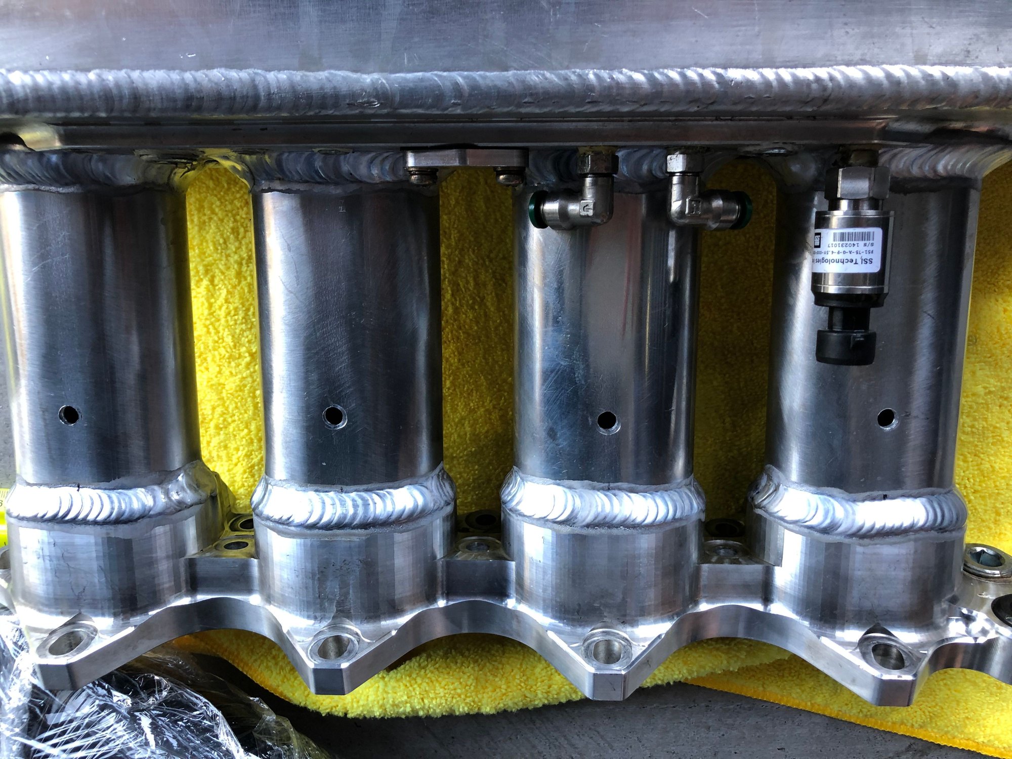

Today I was able to drill out the Nitrous nozzles holes in the manifold 1/4 inch. I also ordered the 1/16 NPT thread tap along with the 3/16 tube bender. On Friday I’m going to try and get the solenoid brackets finished and welded on.

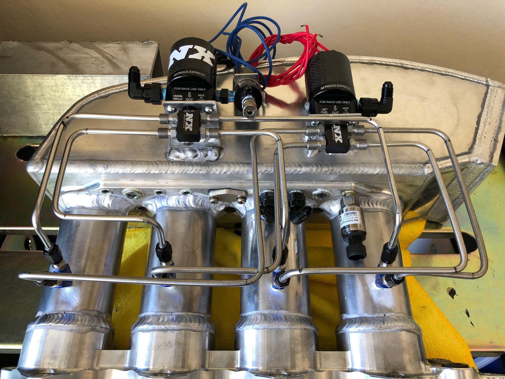

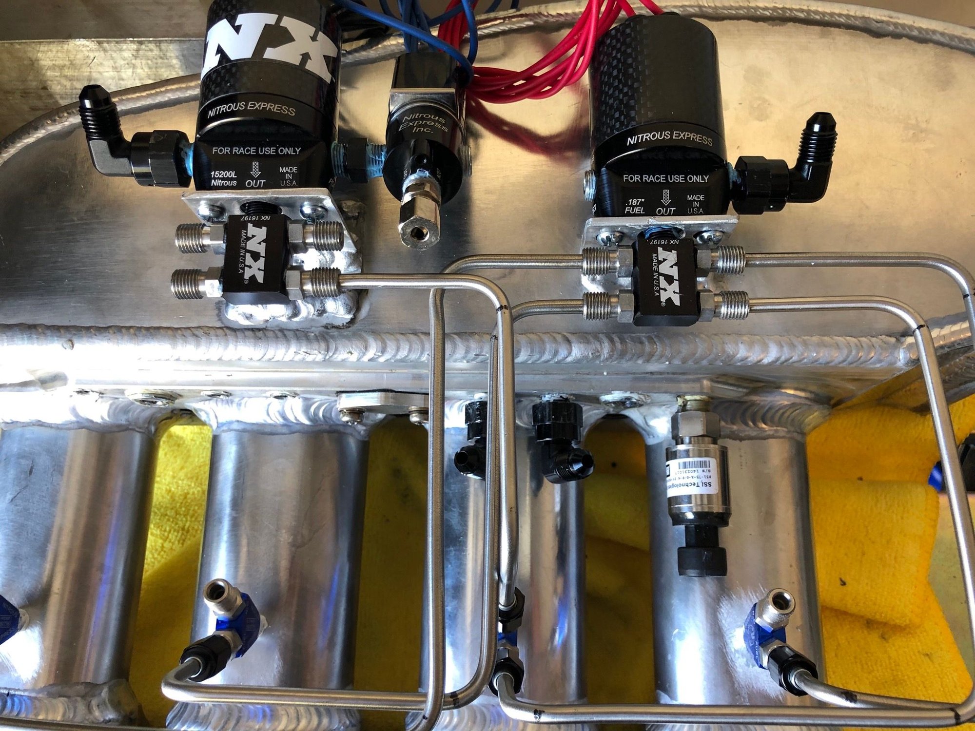

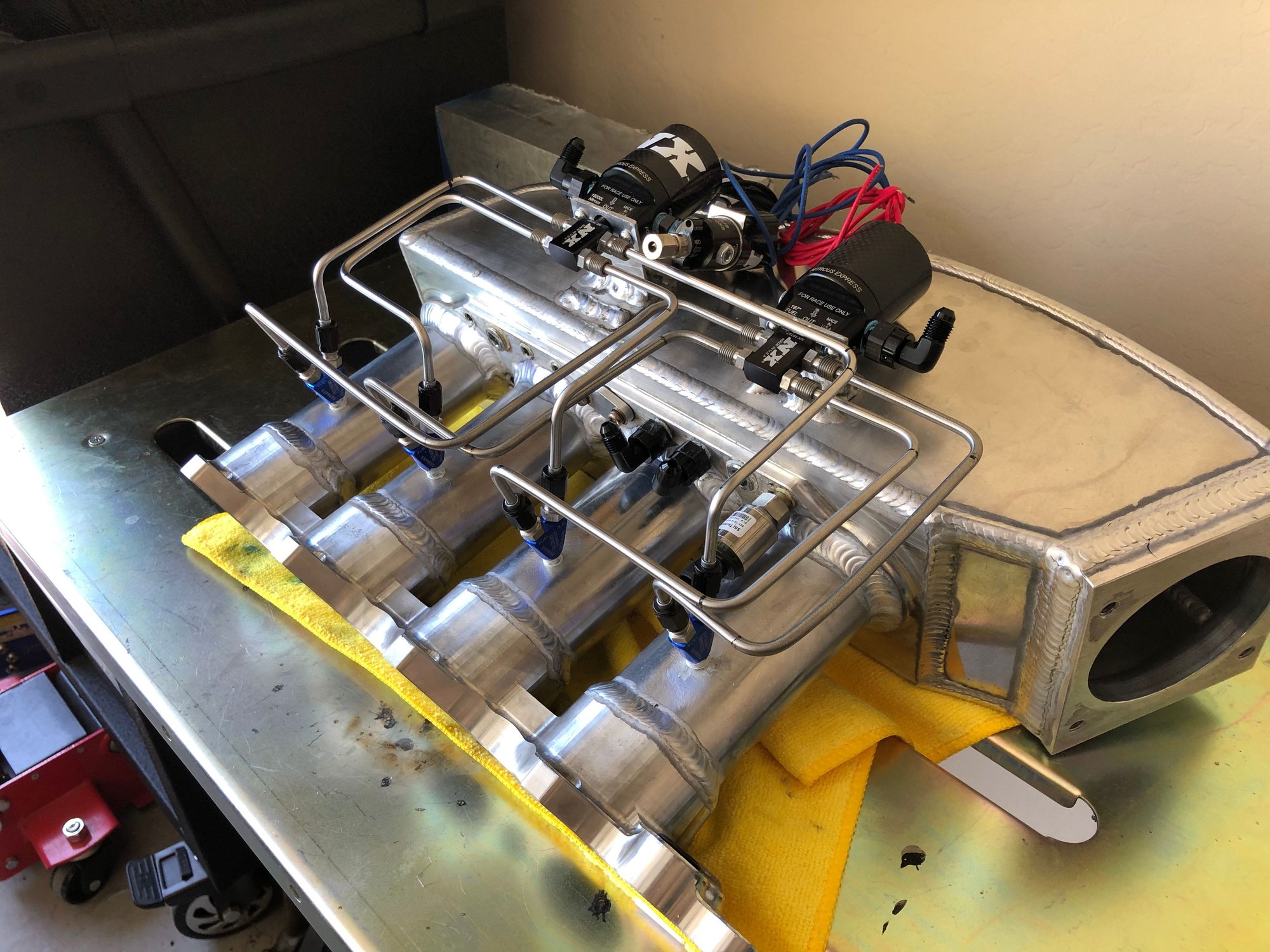

I made some progress with the setup but damn. Trying to bend these lines has been a real pain in the ***, I basically blew threw 3 lines and there was no fixing them so they are trashed. I am ordering a 3/16 tubing kit that will come with another 8 so I should be good to go, I used welding wire to get an idea for the bends I needed. Getting the lines in the tube bender and knowing exactly where the bends were going to be was the hard part. You can mark a line and be like this is exactly were I want it to bend but you then bend it and it's off. It took me some time to figure out that I need to account for about an 1/8 inch to compensate.
So now I have to wait for the new lines to come in so I can finish bending the other 3 and then from there I can finish the compression fitting to the solenoid distribution block and get everything basically finalized. I also test fitted the manifold on a motor to make sure it clears the oil filter and water tube but I hope everything fits with no modifications.

Looks pretty good. Doing it yourself gives you a lot of respect for those badass looking 2-kit setups on V8s with all the beautiful plumbing, doesn't it?
That is true, it's not that bad once you figure out where to compensate a bend when you mark it. But you won't be able to see any of this anyway since it's on the bottom of the intake manifold, there was zero room on the top side.
Bummer... That's too damn pretty to hide!

I totally am LOL, every time I saw a bend that I didn't like I was like f it, trash it. My son kept telling me it's fine no one's even going to see it but it just sits in the back of my mind and I can't let it go.
I thought about ordering a braided line kit and NX makes them as part of another entire Nitrous Kit but I was having no luck finding an actual line kit. Every time I would look up steel braided line kits it would pull up what looked to be a kit but it would end up being 1 36 inch line or some crap like that.
I am sure I could have had a place make them but I was like I will give it a shot with the hard lines. I ended up ordering another 8 hard lines for 50 bucks so hopefully I don't screw too many more up LOL.

I am somewhat OCD...i feel so bad that the beautiful masterpiece you built will be hidden. truly looks great

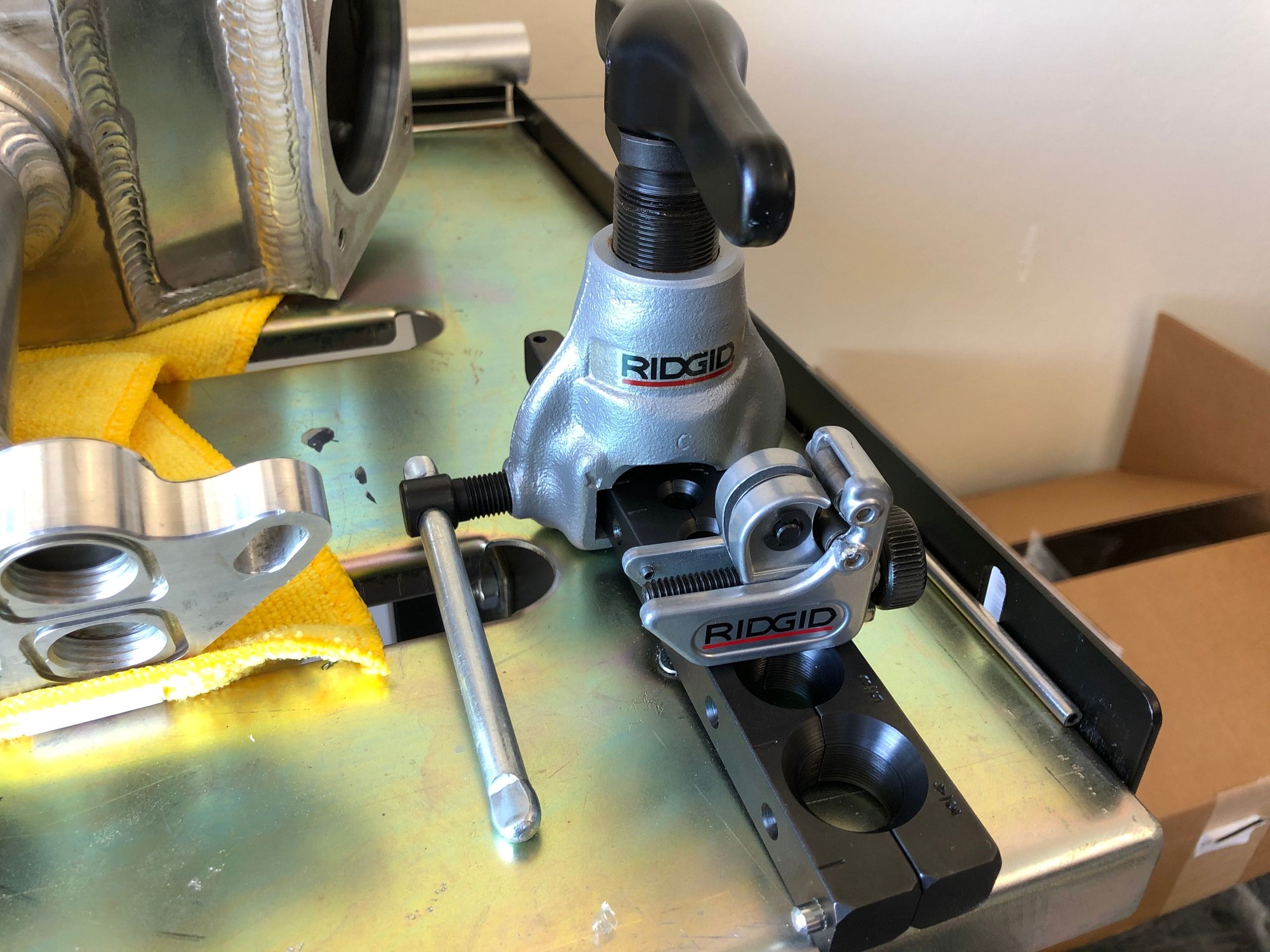

Well I got my extra lines from NX but they were not flared. No big deal I had a 37 degree flare tool I bought like 11 years ago so flaring the lines were no problem. I also bought some cool 1/8 NPT 90 -4 swivel fittings. I've been using push lock lines for a lot of things but awhile ago I did all -4 lines for the boost solenoids and now I am doing it for the overflow bottle line, the blow off valve vacuum line and whatever used a push lock. I figure it will look and function a lot better than plastic lines that can break or melt.
The only thing I have to do now is the compression fitting on the solenoid side of things and basically do a final tightening on all lines. from there it should be ready to go back on once I get my motor back in and I can have my buddy Brian start the wiring. This will be controlled by Motec, so as I get to it I will post some more stuff up.
