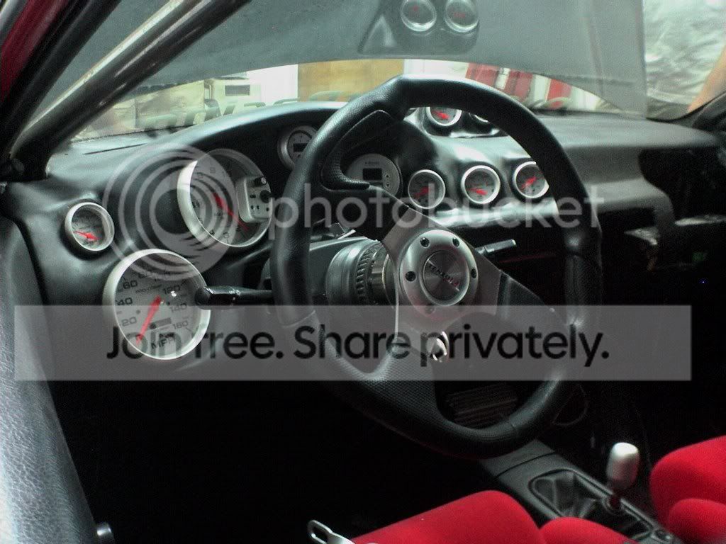

Default Re: (bigbadboy)
<TABLE WIDTH="90%" CELLSPACING=0 CELLPADDING=0 ALIGN=CENTER><TR><TD>Quote, originally posted by bigbadboy &raquo;</TD></TR><TR><TD CLASS="quote">any got some pics of the turbo smart EBC mounted???</TD></TR></TABLE>
about 25 hours into the dash alone
the dash was not completed 100%...more like 85%
he sprayed it flat black before i could do one more skim coat of filler and sand it to perfection. the turbosmart e-boost is on the right hand side of where the stock cluster would be...you can just about see it over the top of the steering wheel.
here's the link to the pix of my tangible genius lol.
it was in my friends car and now he switched to an integra dash in his ride so i believe that my max opus is now up for sale!!!!!!!! pm me for info!
