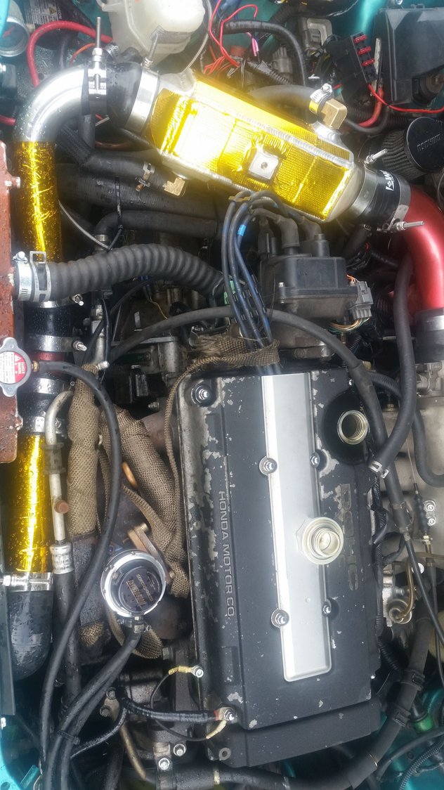

I used some DEI reflect a gold and it helped a fair bit with the pipes getting heat soaked. My piping crosses over my hot side and behind the turbo.
This is a WIP so please don't judge my bay
Seems like IATs/intake manifold are getting heat soaked easily. I'm wondering if eliminating the reservoir and/or changing the position of the pumps/modifying the plumbing would help at all. But maybe my sensor is more reading my IM''s temps instead of actual IAT? I will install my modified sensor soon but wondering if I should just move it elsewhere

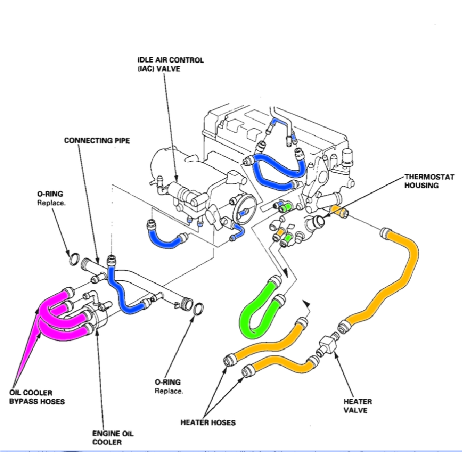

Some service manual fun. The B17/B18A manual has two hoses I can't seem to follow (denoted by the red arrows)
The B16A2 manual calls one of the SMALLER hoses a "water bypass hose" (the one highlighted with RED) whereas generally most people refer to the bypass hose as the LARGER one highlighted in GREEN.
