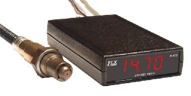

Ditch that AEM and get a PLX. Much quicker responding sensor and control box. Gives you way better data when logging. The Aem is slow and they always have issues. You can get the plx with the dm6 gauge for around 200 bucks. Zietronics and NGK are also great units.

Im trying to determine if its worth money to upgrade from my current PLX M300 (its almost 10 years old). It works fine, but I can justify better data collection. I also like the feature on the MTX that changes gauge color depending on AFR
