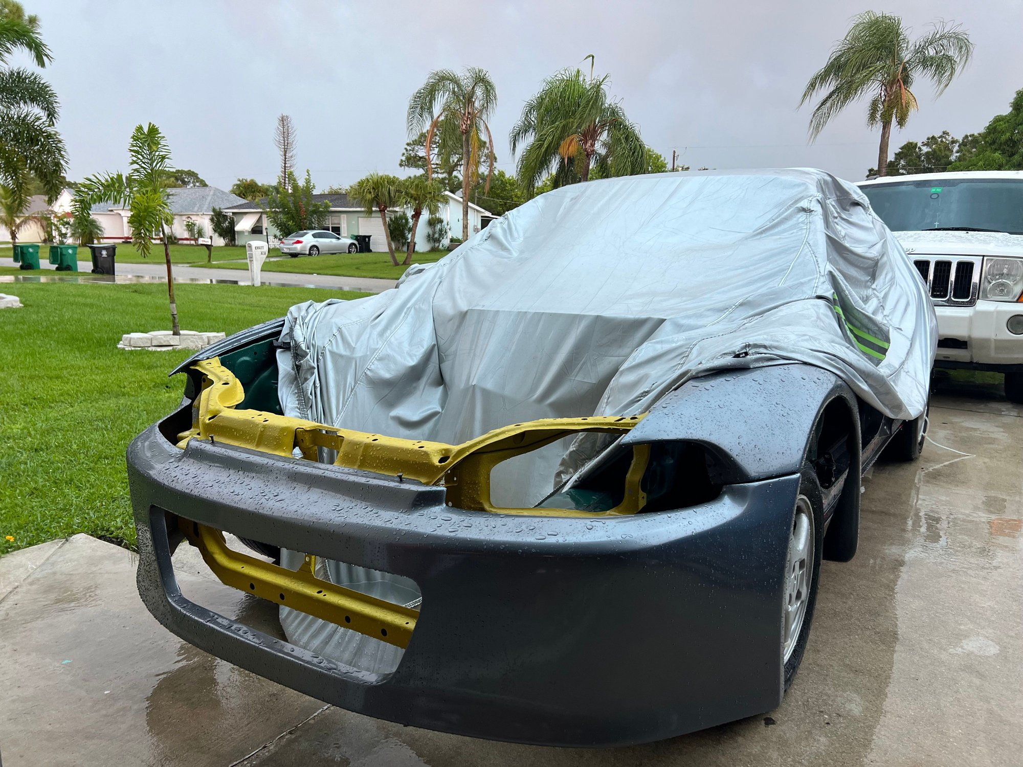

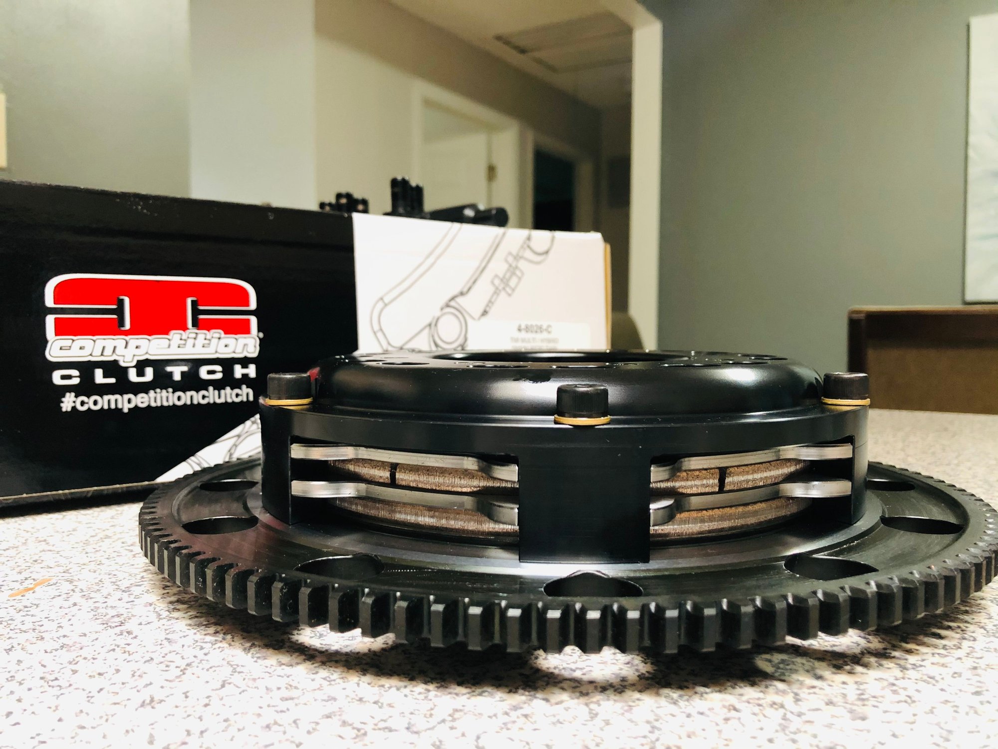

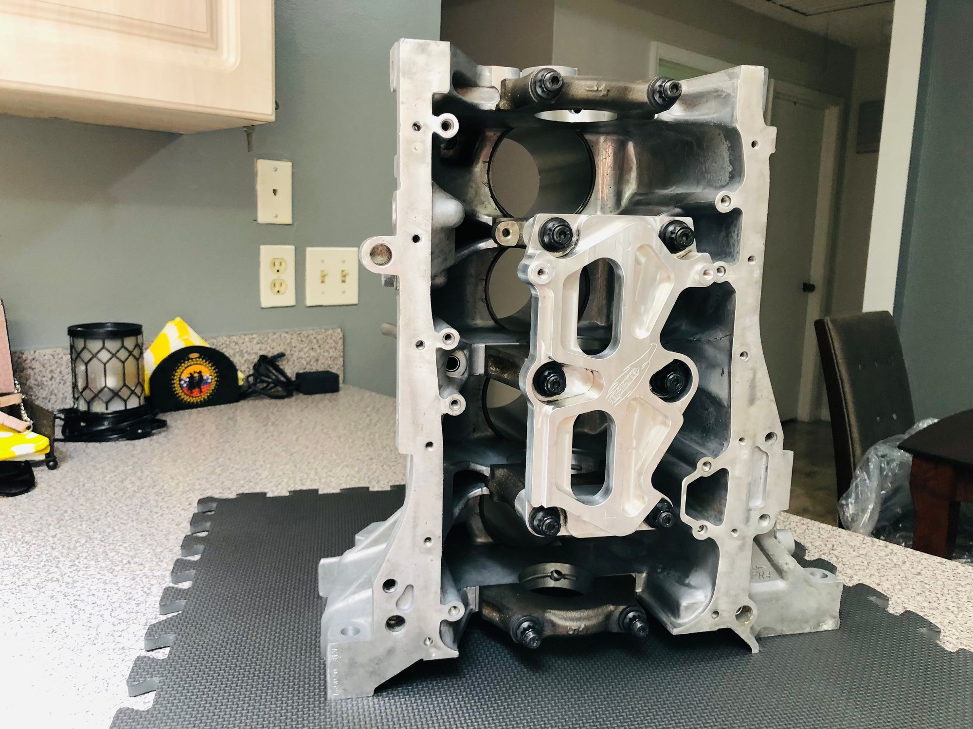

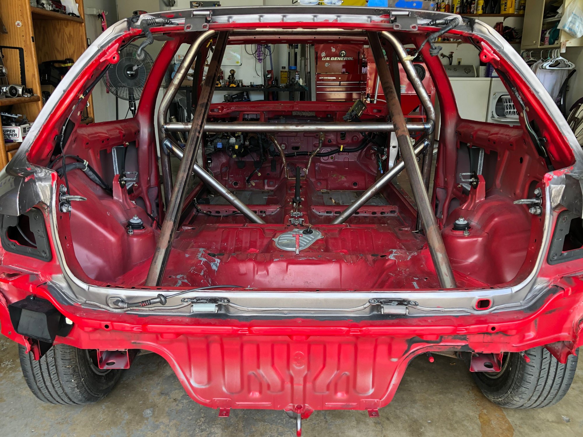

A few pictures, I don’t want to post pictures of everything I got. That’s probably annoying 😬

Looks like a fun build! The Faceplated gears are nice, but anything over 600whp really needs a stronger set of gears. My set of treated gears didn’t last long at all, I broke gears 4 different times under 700hp. At 800hp I would definitely look into some strong gears
I hope those face plated gear set holds at least a few track days while I’m testing the car. Other than that it gonna be at 600-650 the most of the time. After my accident wife doesn’t want me to race again, so you might know what I mean. I told her I’ll be at track just a couple times to set the car up.
i understand, my wife gave up and just wants to make sure I use proper safety gear now, she just closes her ears to the 150mph + speeds

If the car is caged, and you're wearing a helmet with a proper seat and harness then you're most likely safer at the track than you are on a public highway in a commuter car honestly.

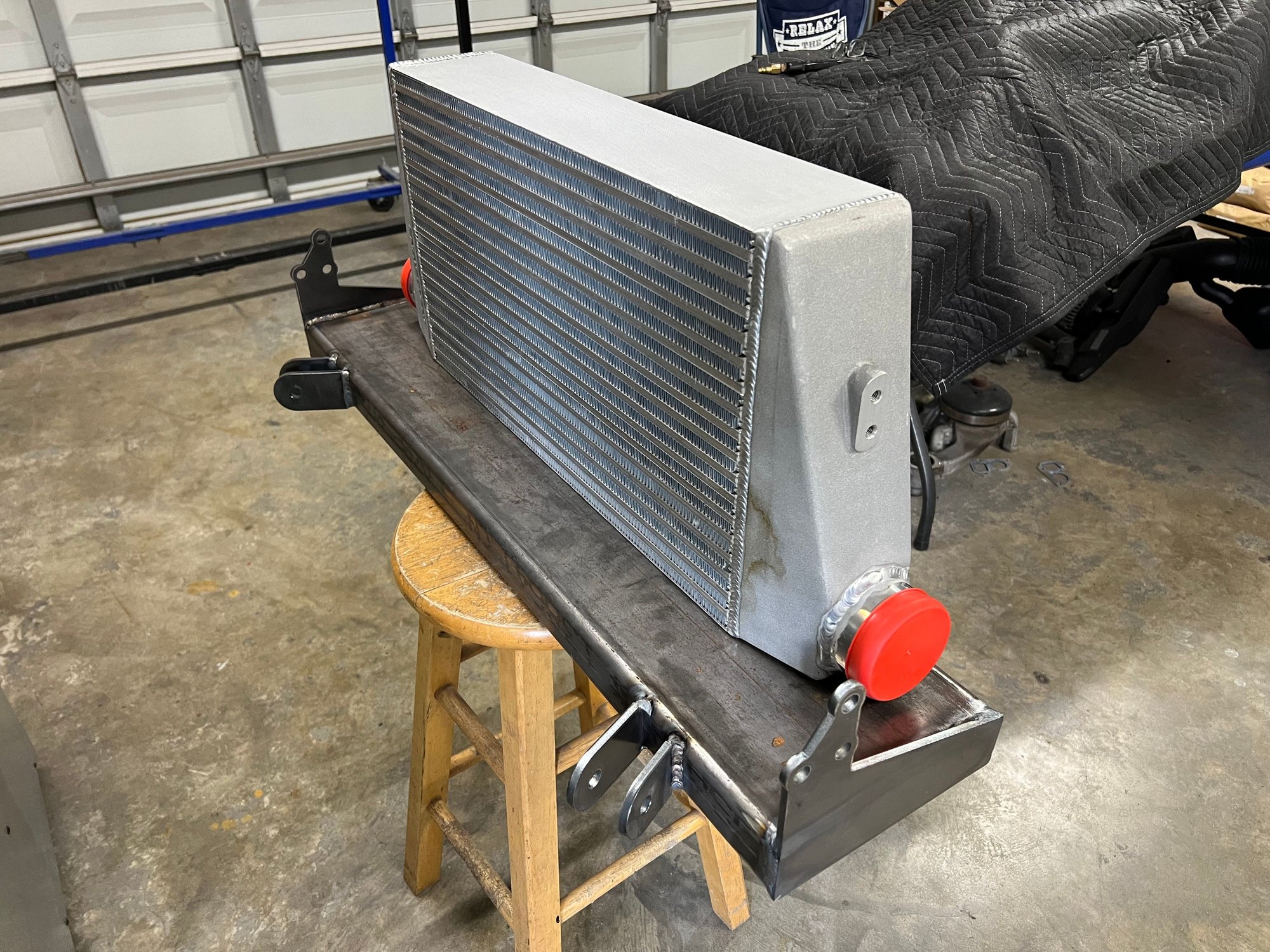

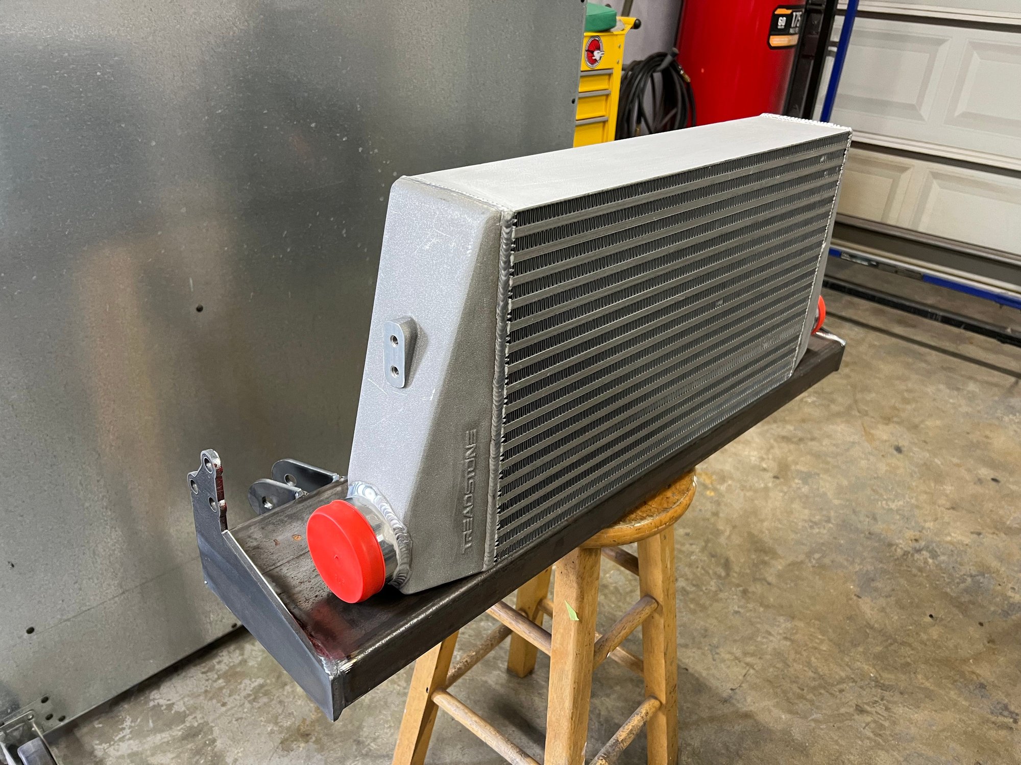

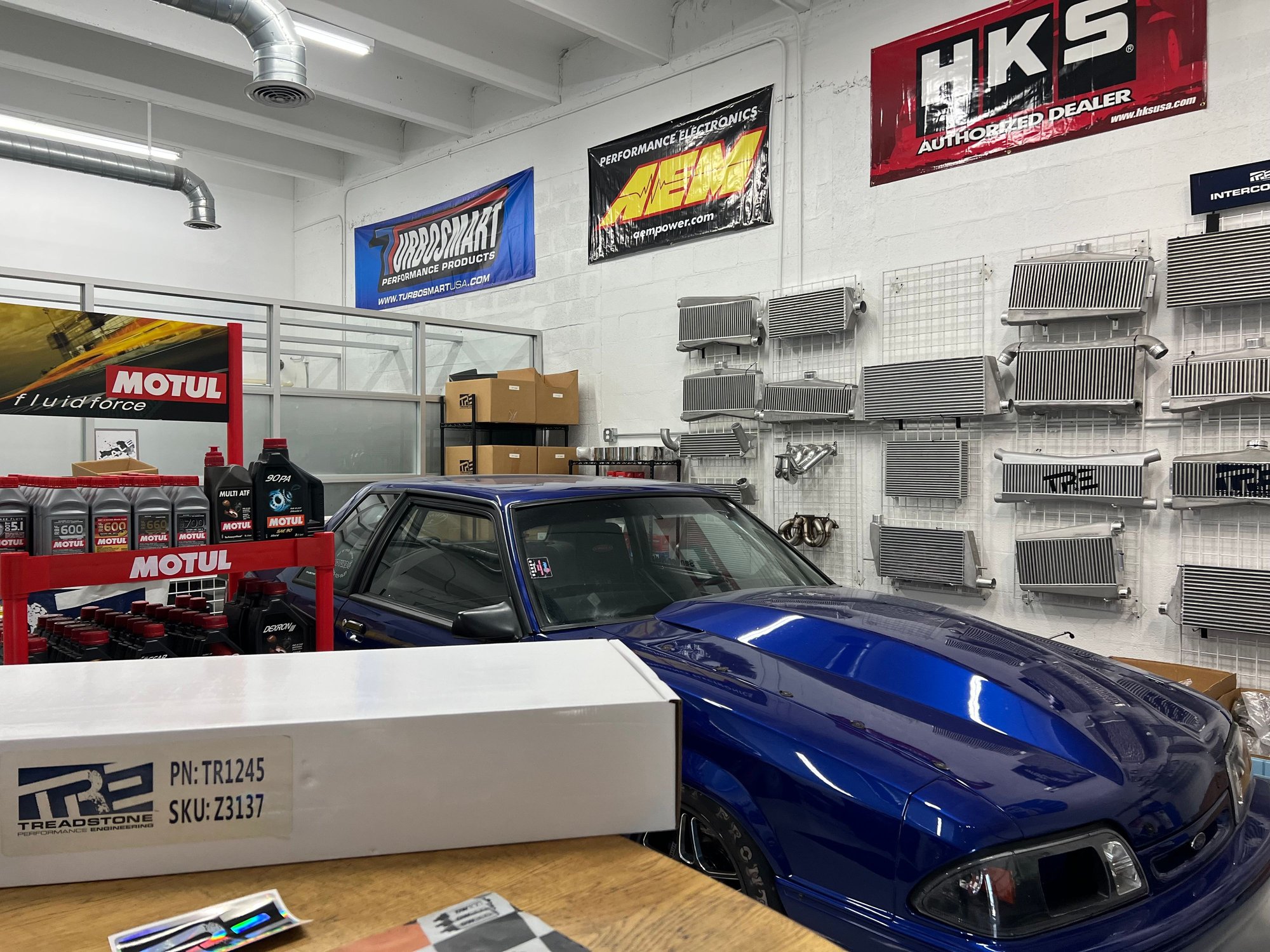

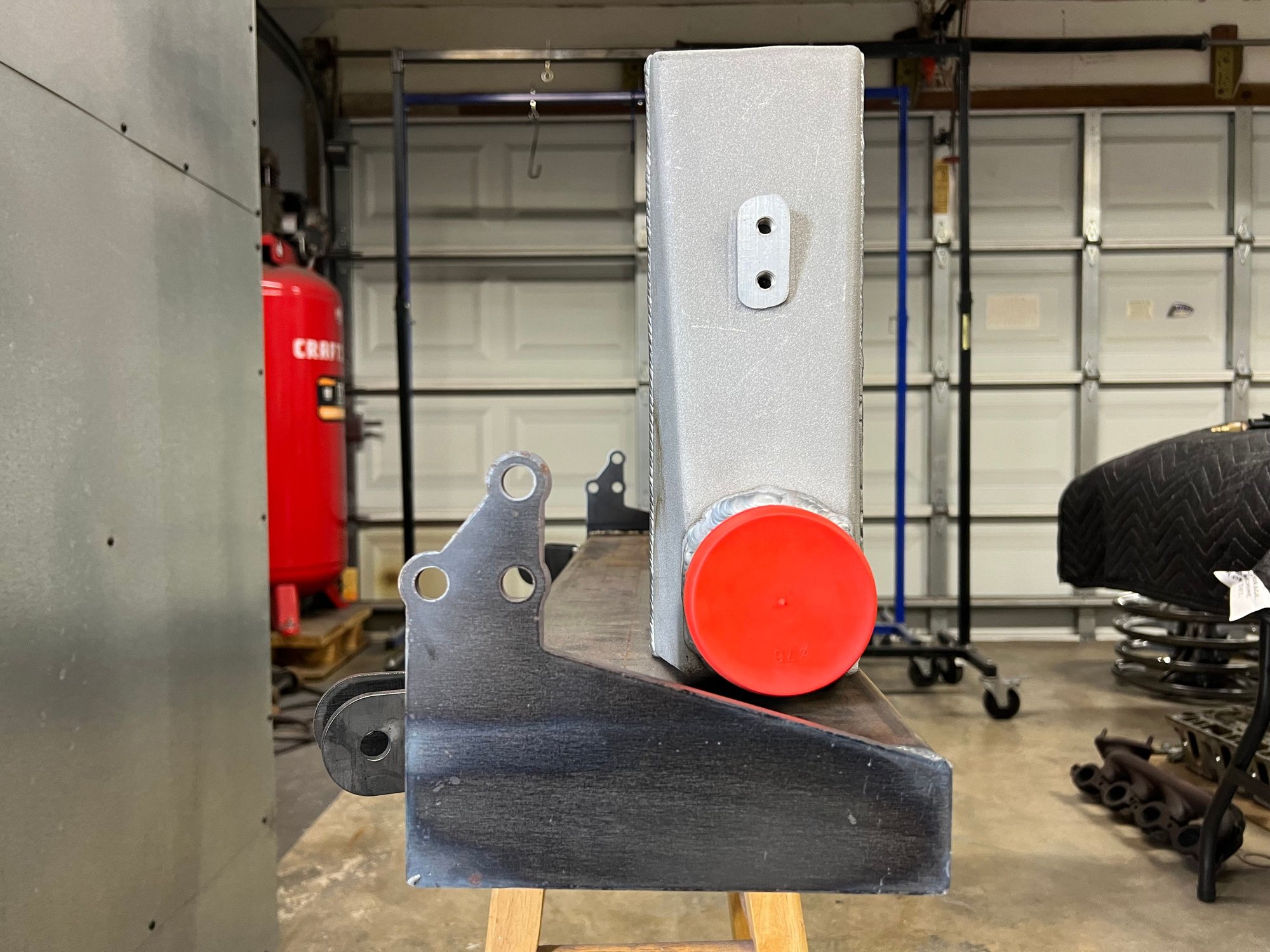

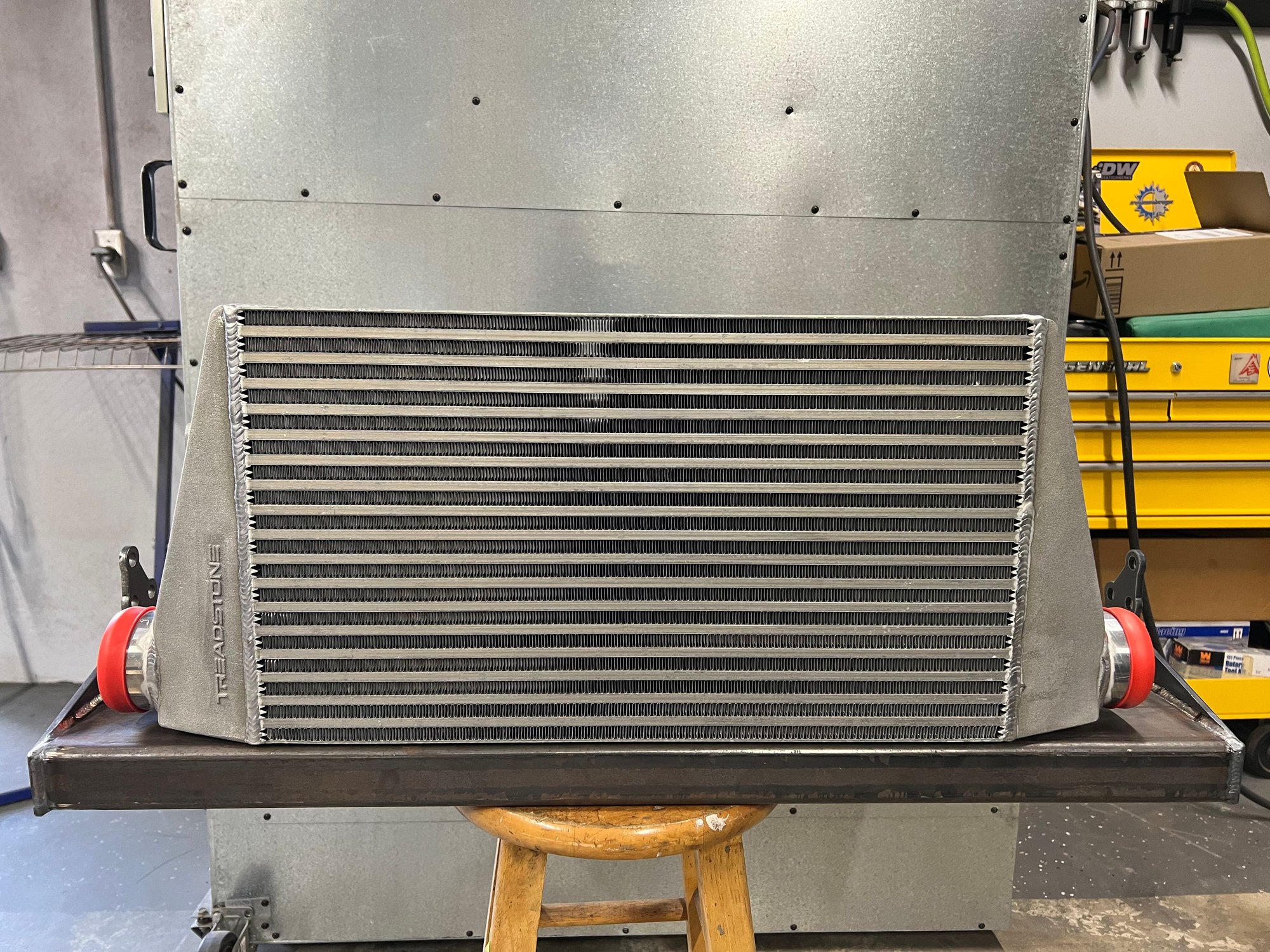

I went today to Treadstone headquarters in Miami, Fl to pick up my TR-1245 (1000hp) intercooler. Core size 22x12.5x4.5. Treadstone’s crew are awesome!!
Next step on the list is the Odyssey Fab 8” weight bar. Little by little 🙌🏽

Nice, I have a TR6 intercooler on my hatch.

Thanks bro! Yeah, I checked out your build thread 🙌🏽. I used the TR11 on my 525WHP built, it was pretty efficient.

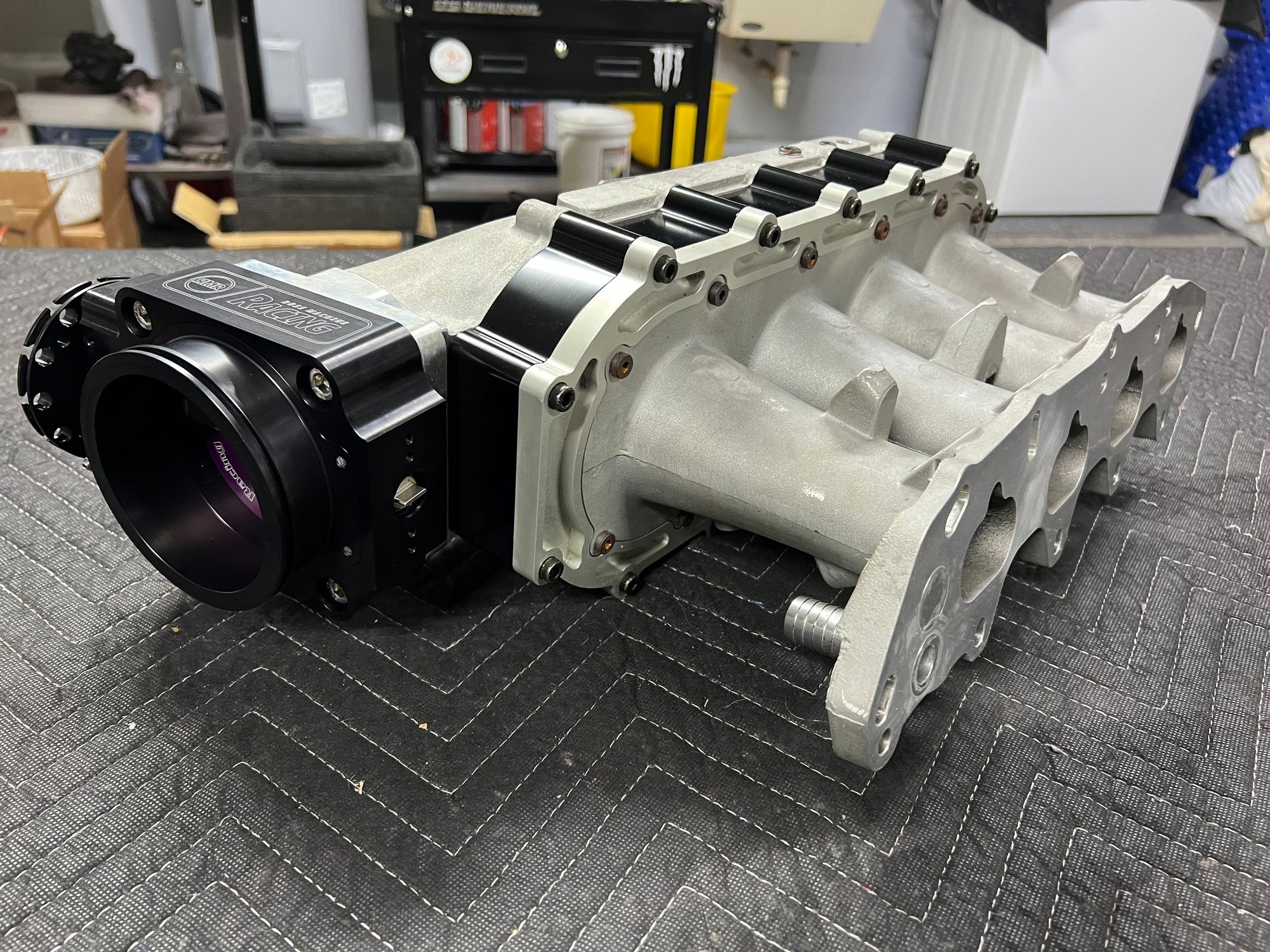

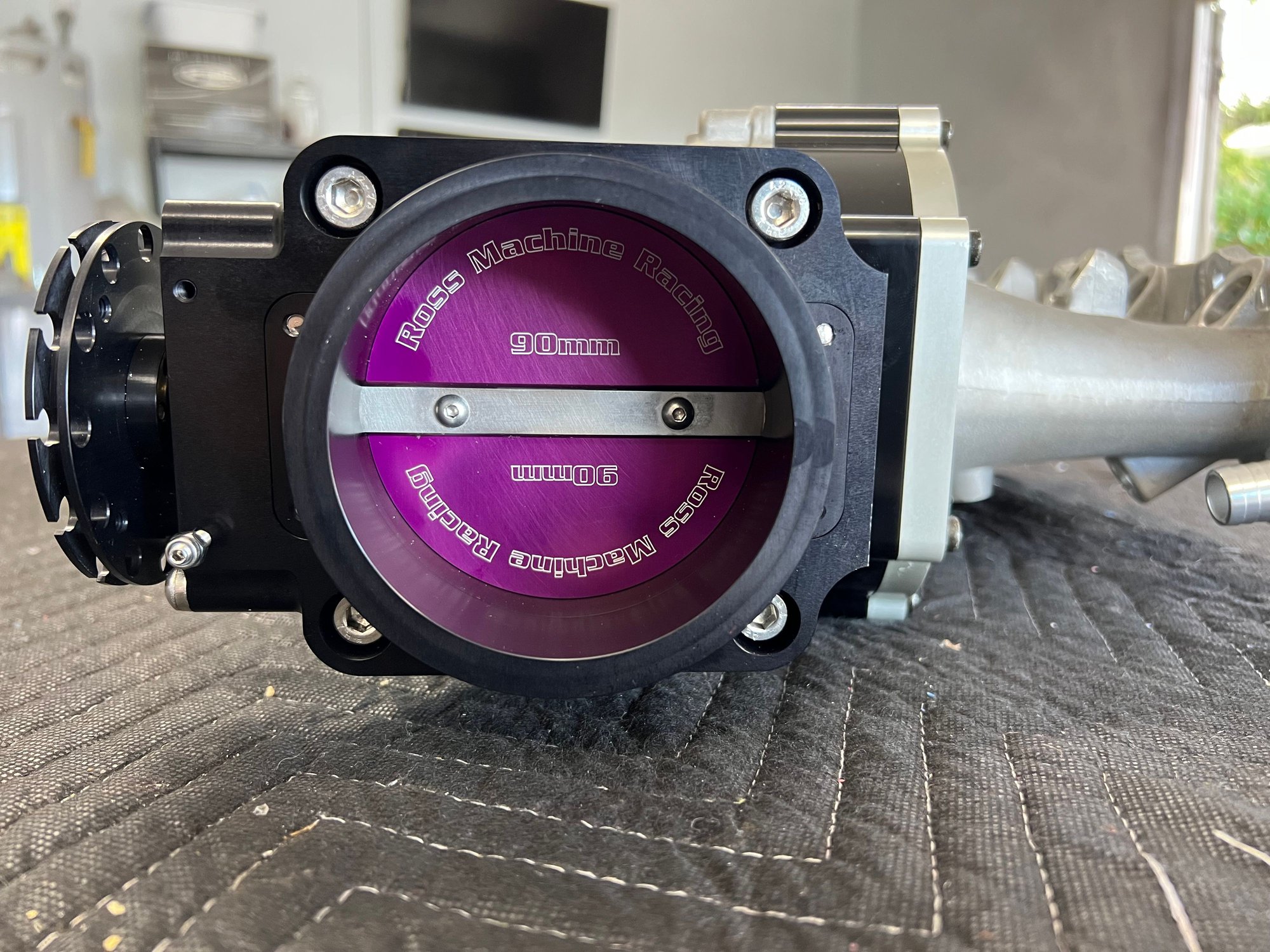

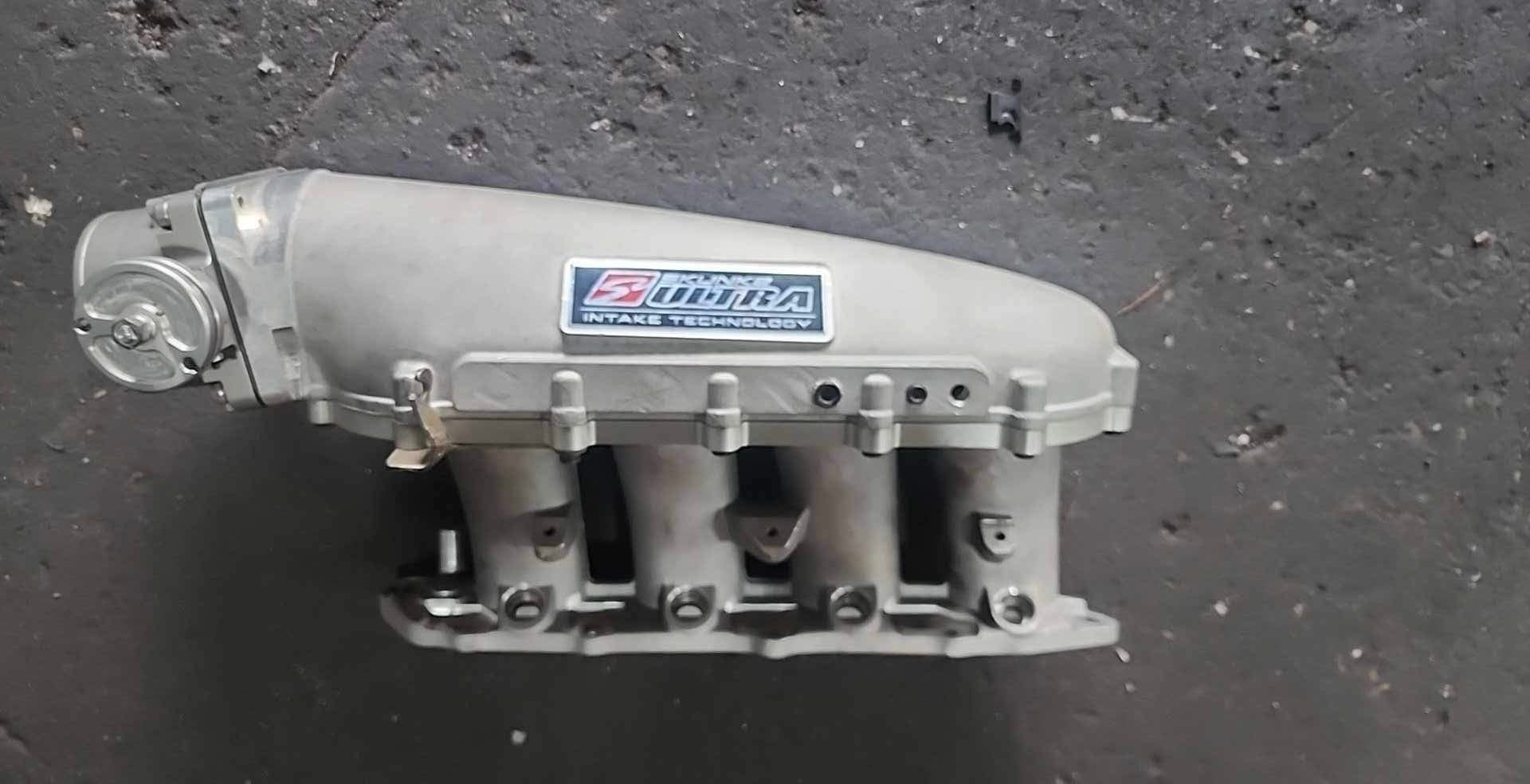

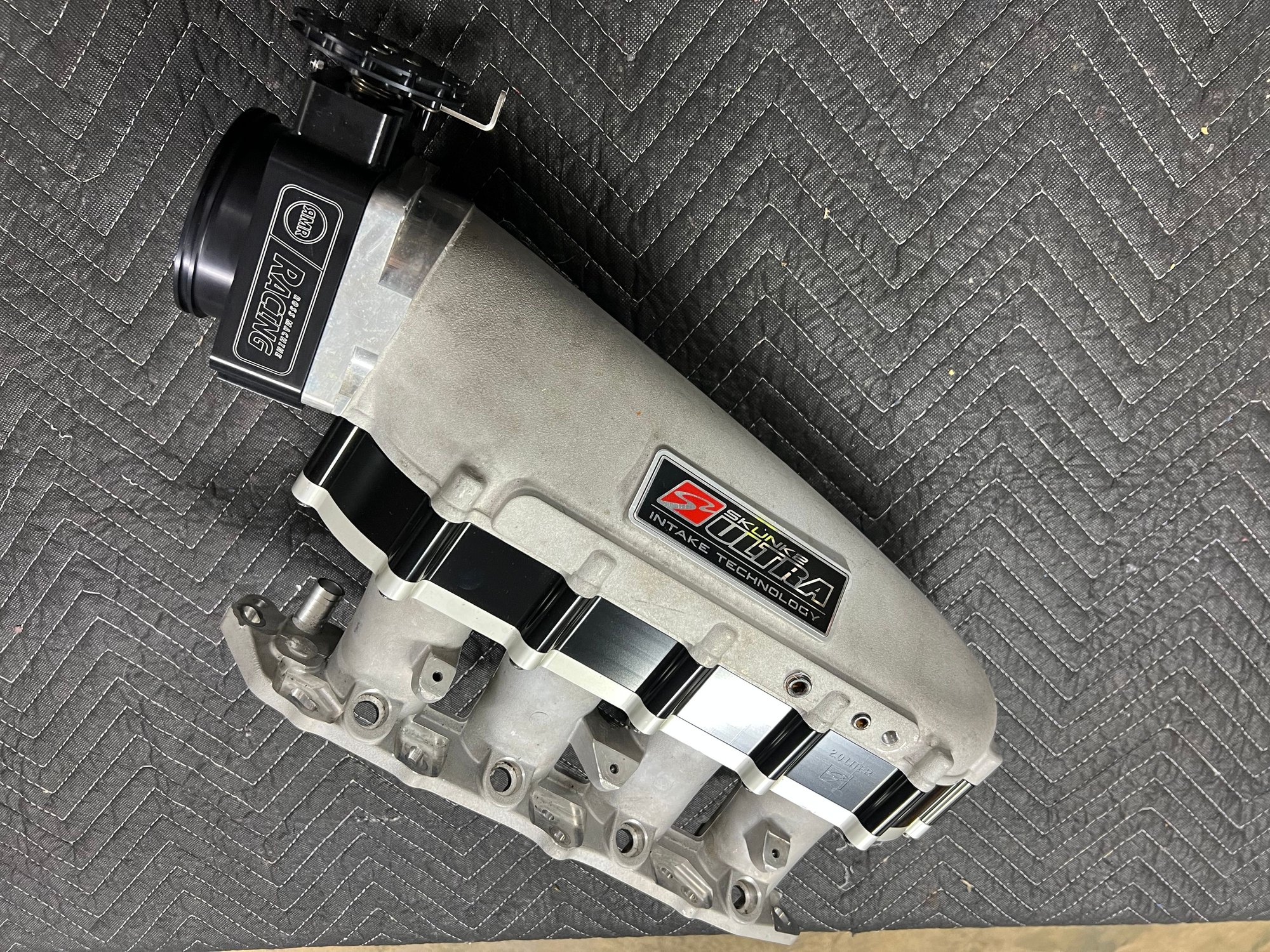

Guys! What size spacer do you recommend to run in my SK2 Ultra Race IM?? 1LT or 2 LT? 🤔 I’m planning to stay around 800WHP (limited for the transmission).
I’ll be running a 74-76mm TB instead the 90mm, I think 90mm is overkill for now.
I have trying to find info about the spacer but I didn’t find anything.

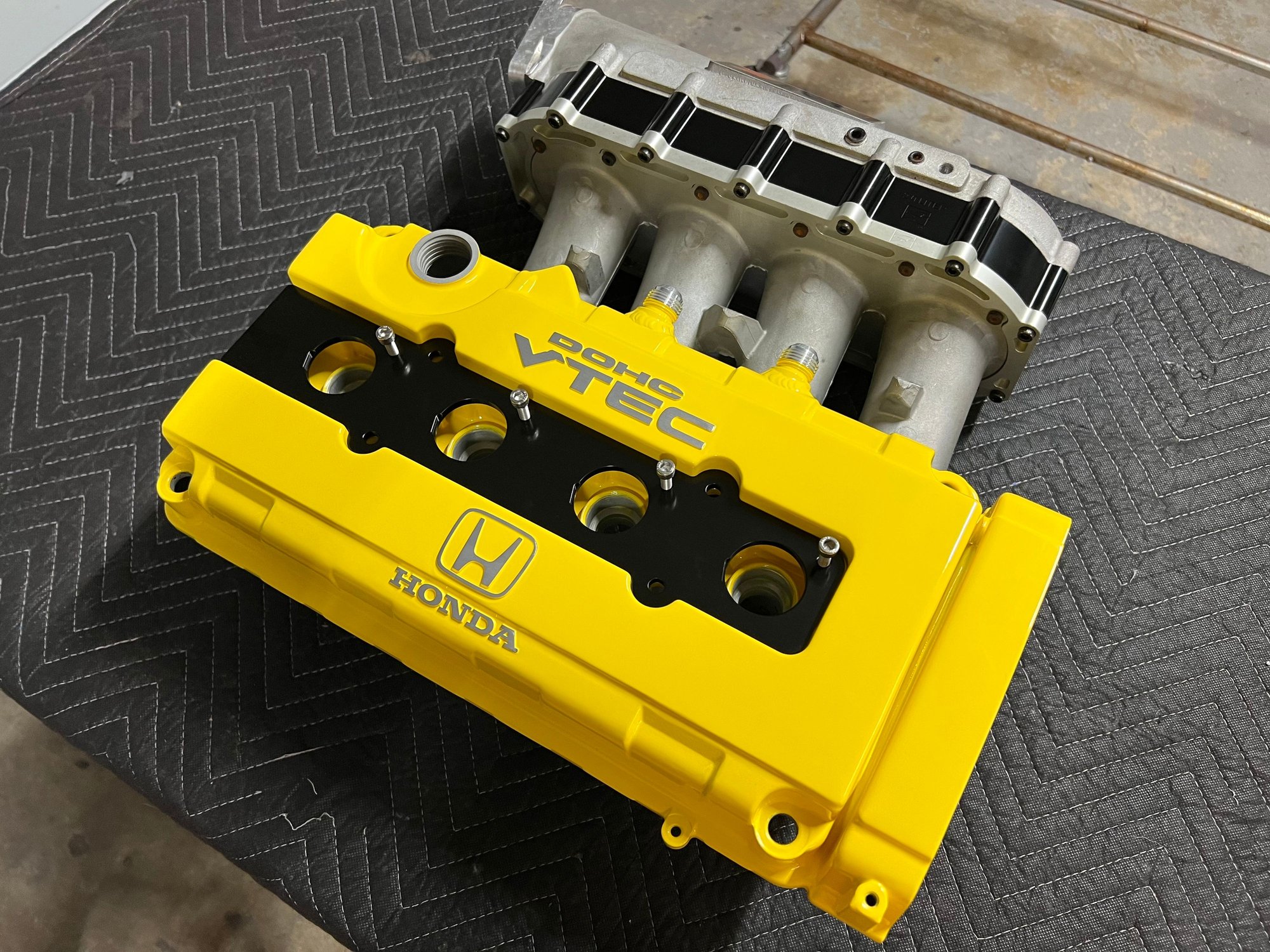

I went with the 2LT spacer so actual volume of the Ultra Race is 5.5 LTS. After reading and reading about the throttle I decided to go with the 90mm Ross Machine Racing. I’ll running a BBK Mustang 5.0 TPS and thinking to go with a AEM 5 bar map sensor attached to back ports of the Ultra Race.
I own a small powder coat business so I’ll be doing a lot of powder and cerakote works on the car. I already did the valve cover. I’ll be doing the IM soon. My IG: @rboost77.

Powerdercoated valve cover looks very nice, and the throttle body looks like a nice piece as well. Not familiar with Ross Machine Racing.

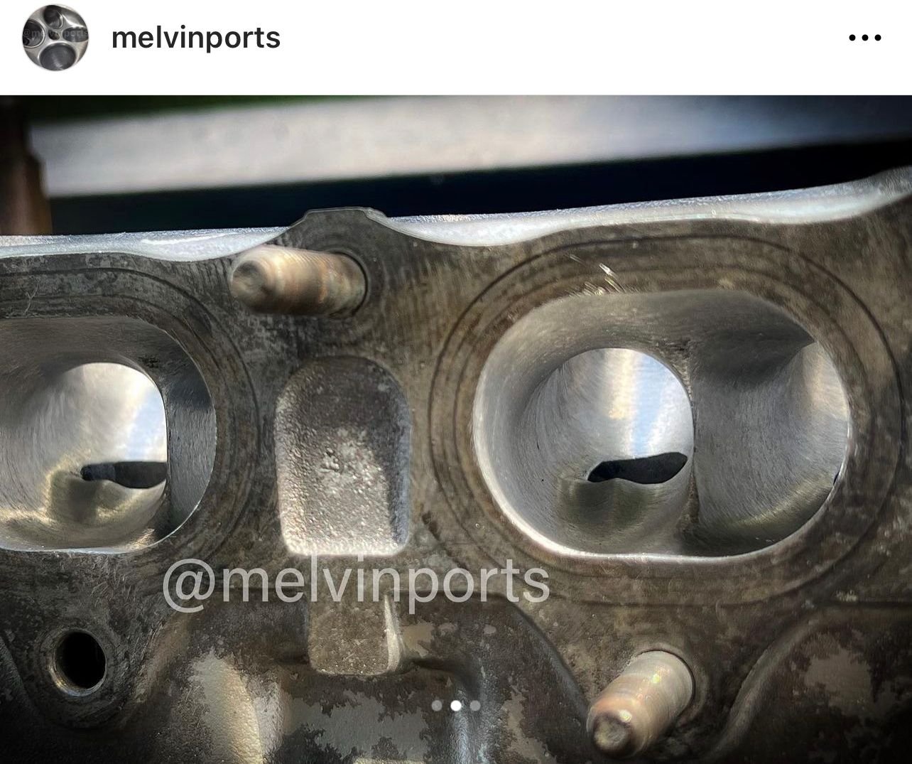

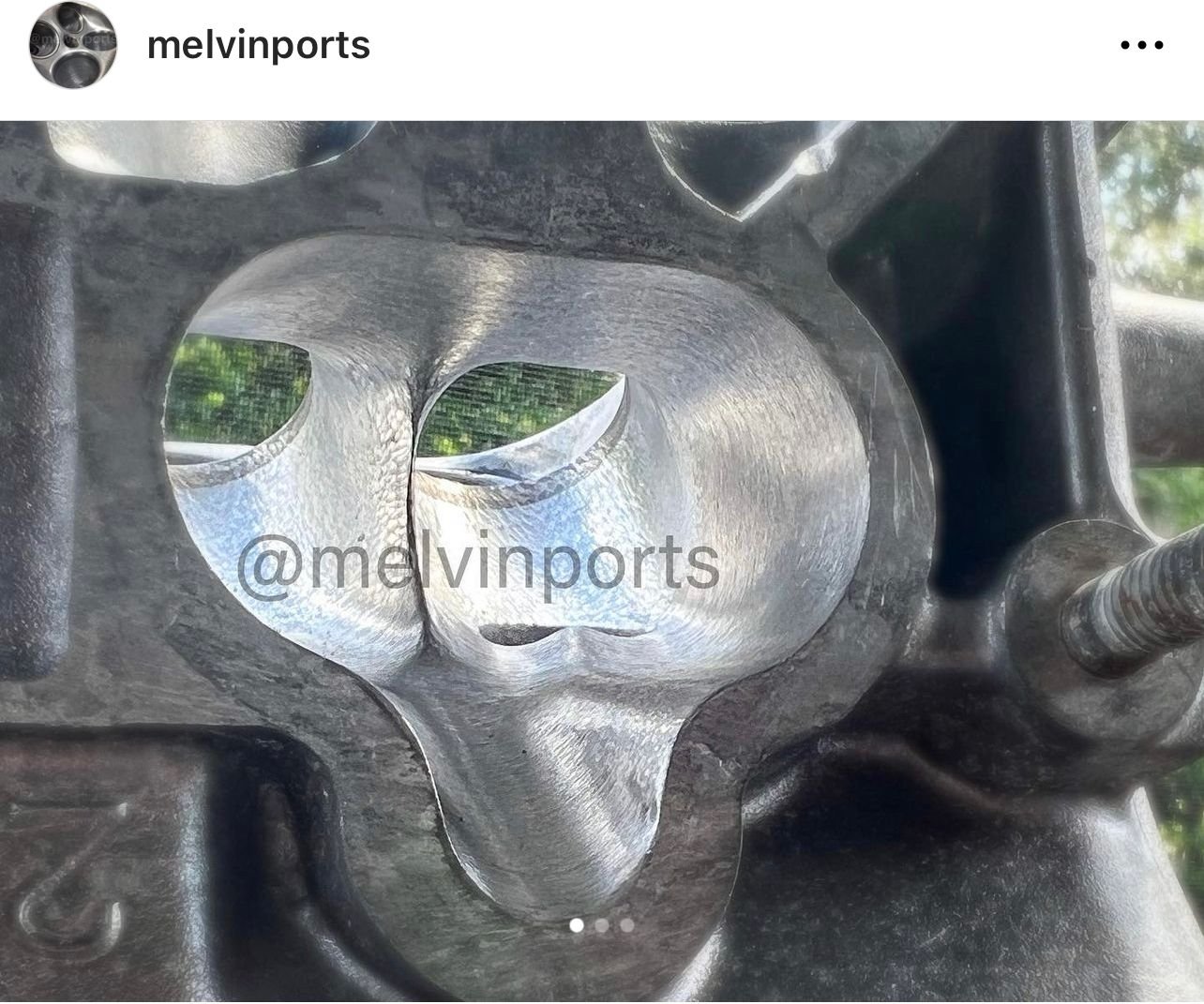

GSR head came back from Melvin’s ports. Ported job looks awesome! I keep moving forward with the build through these hard days we’re living in 🇺🇸 (inflation).

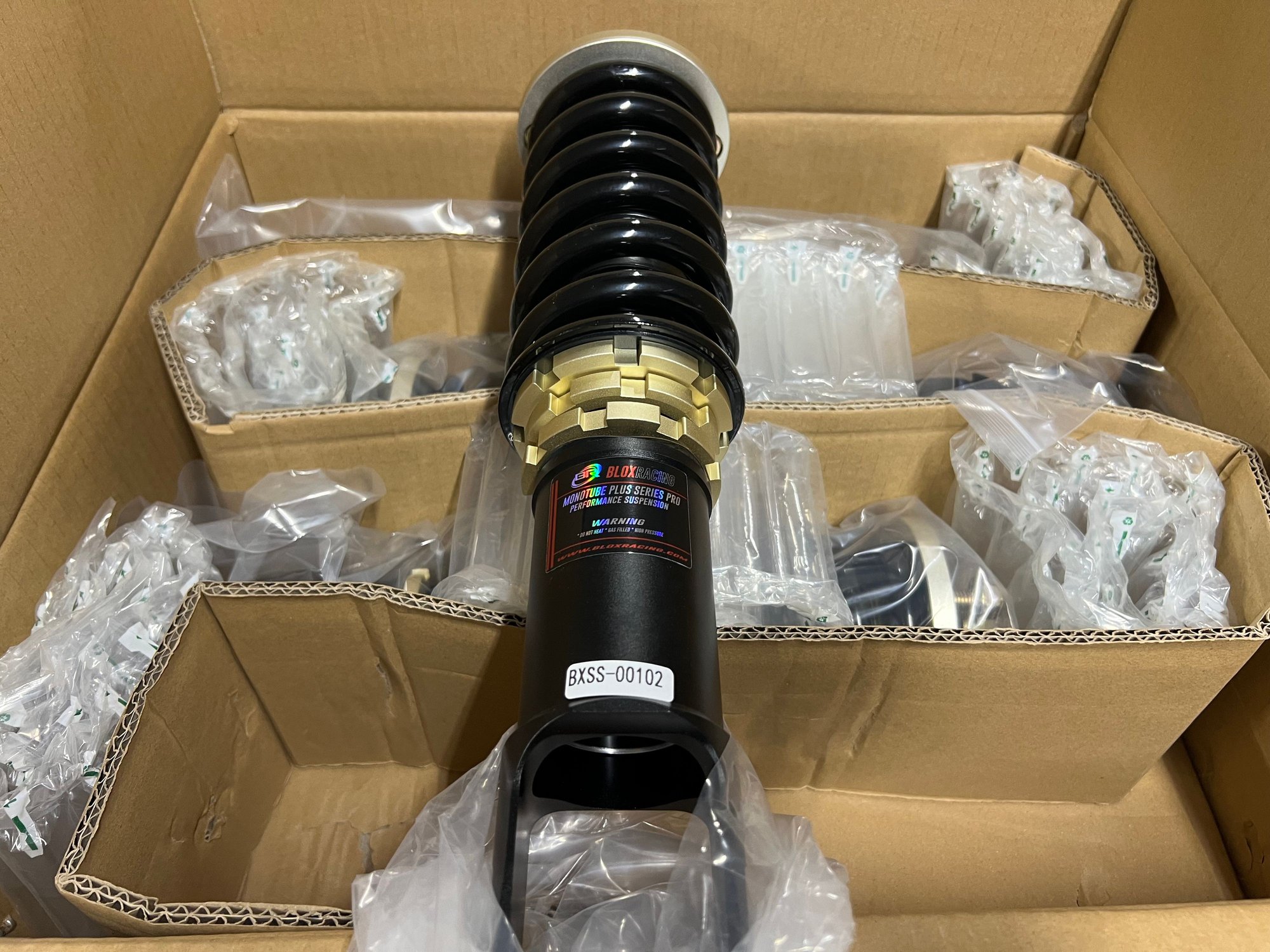

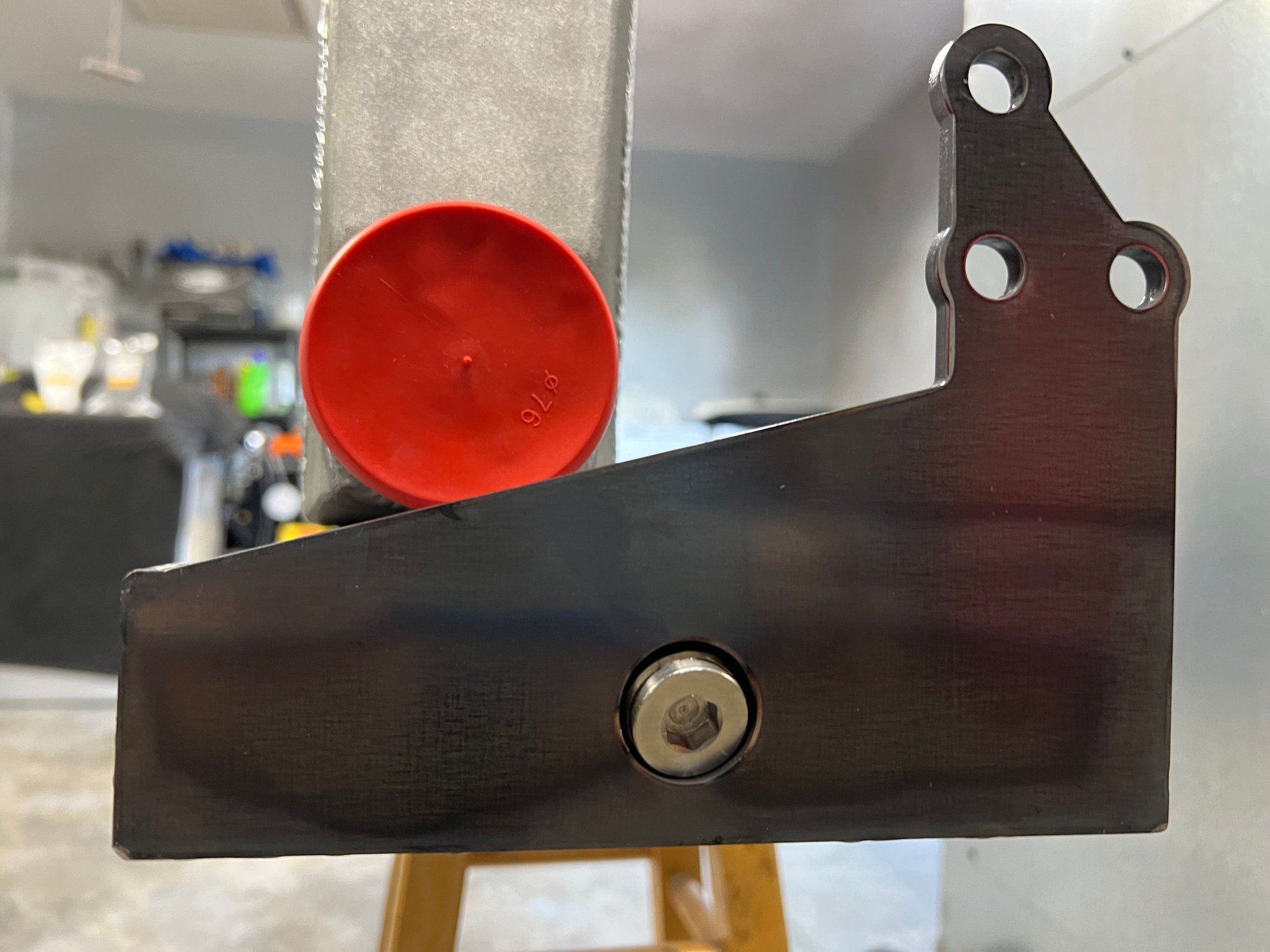

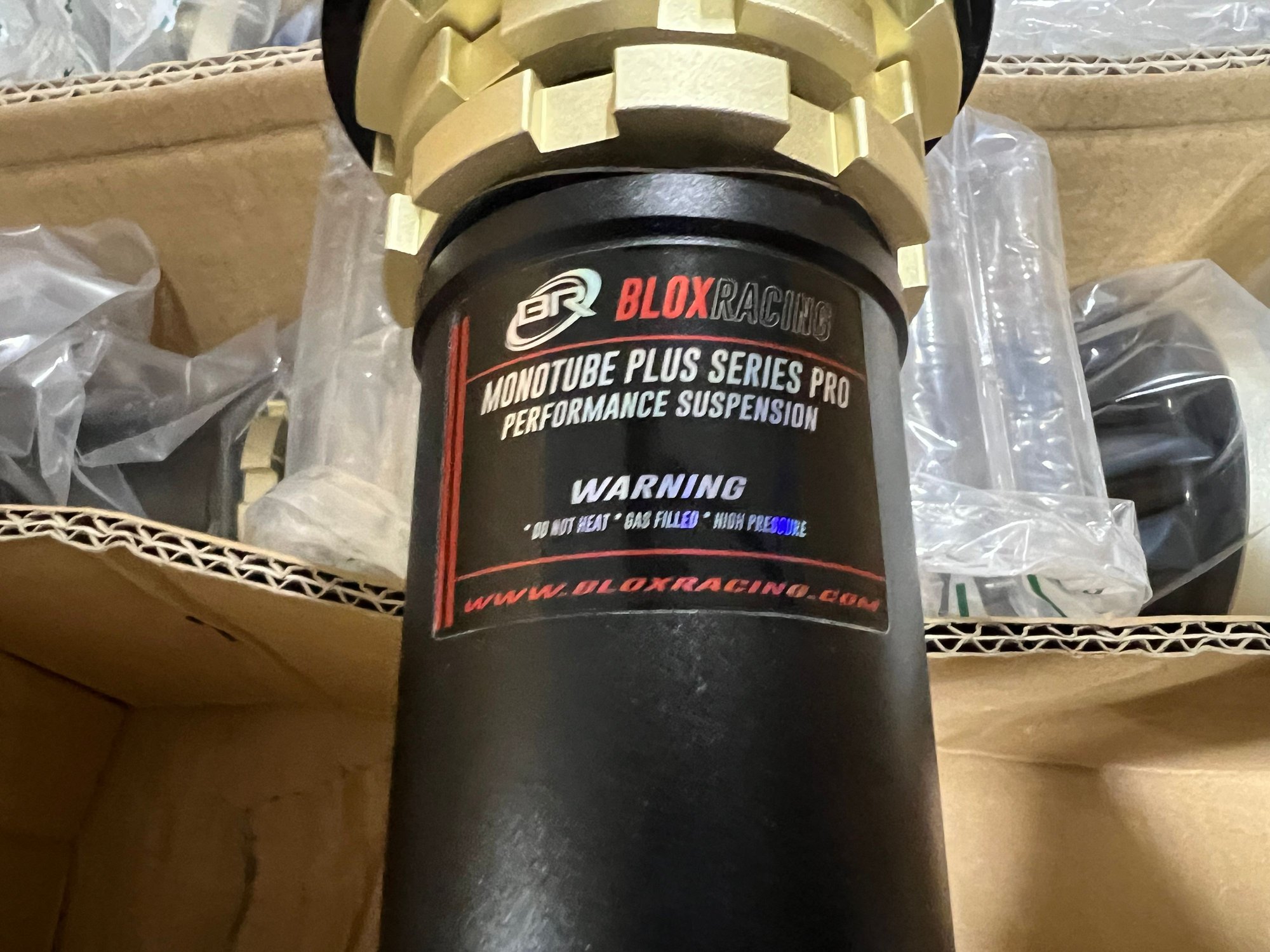

I don’t know if someone cares but here is an update to my thread. More parts for the build 😅
Blox Racing Race Coil Overs
Odyssey Fab Race weight bar. It weighs 40 pounds empty and can be filled up to 140 pounds. Treadstone TR-1245 1000hp intercooler seats perfect on it.

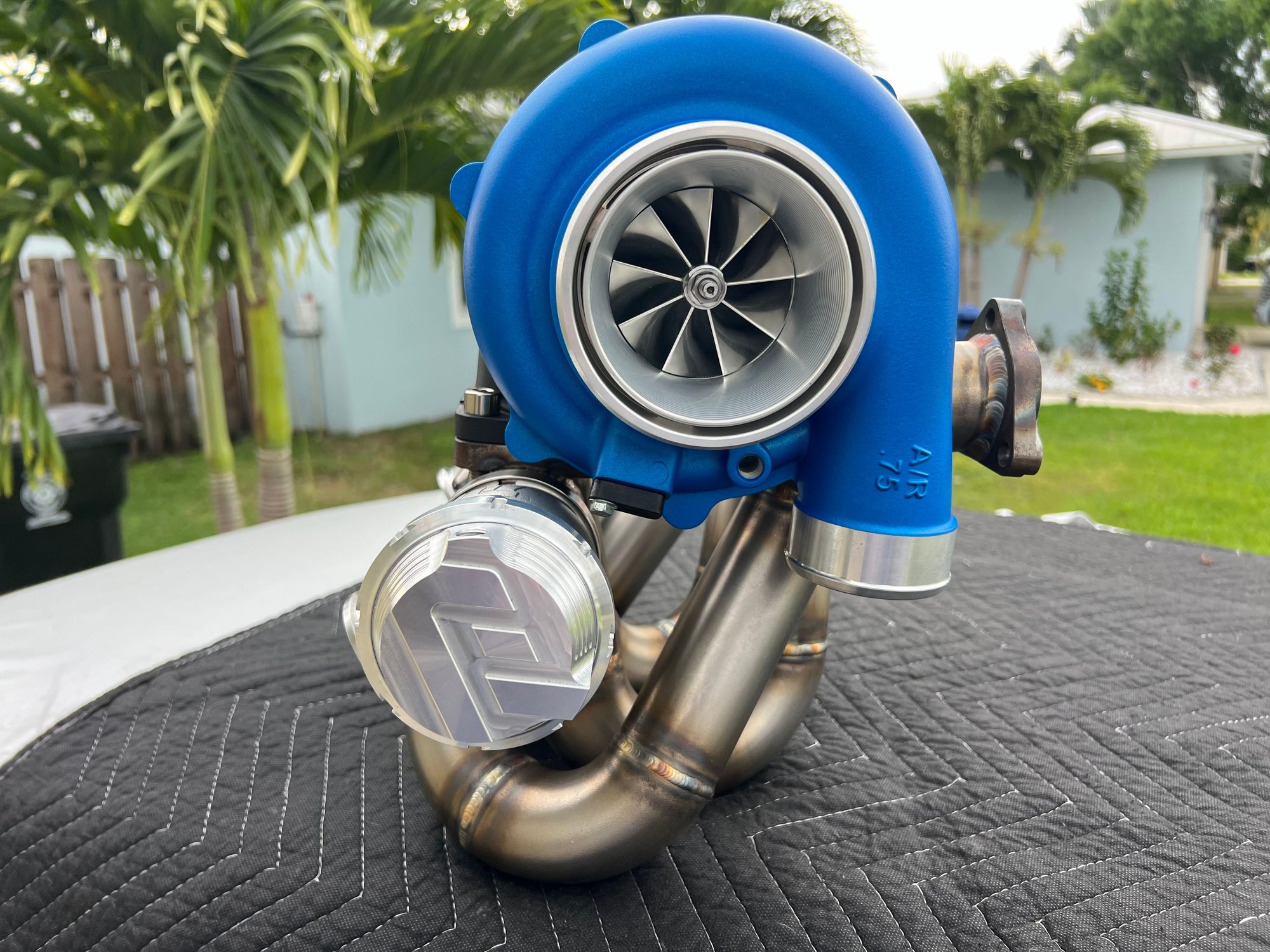

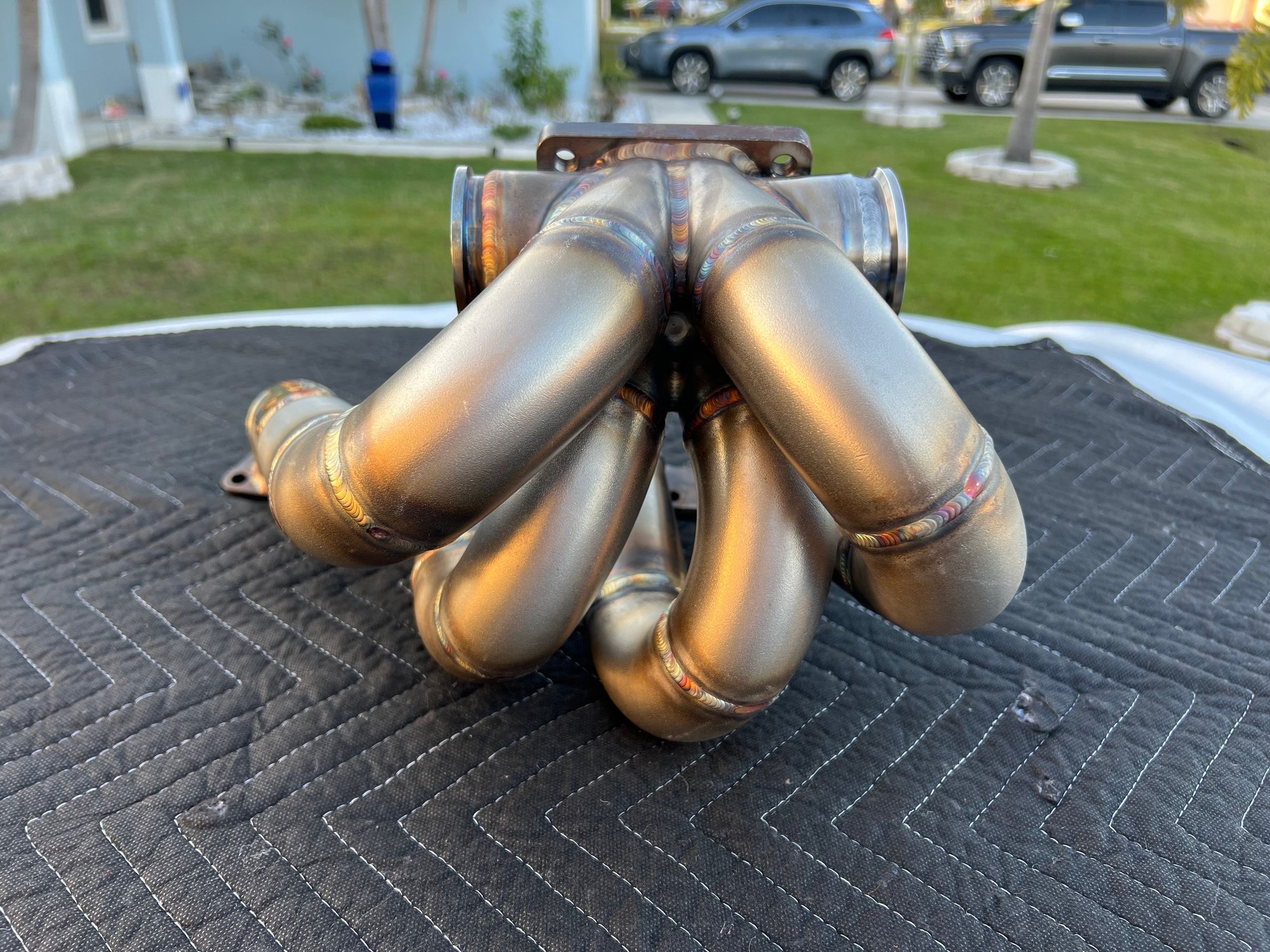

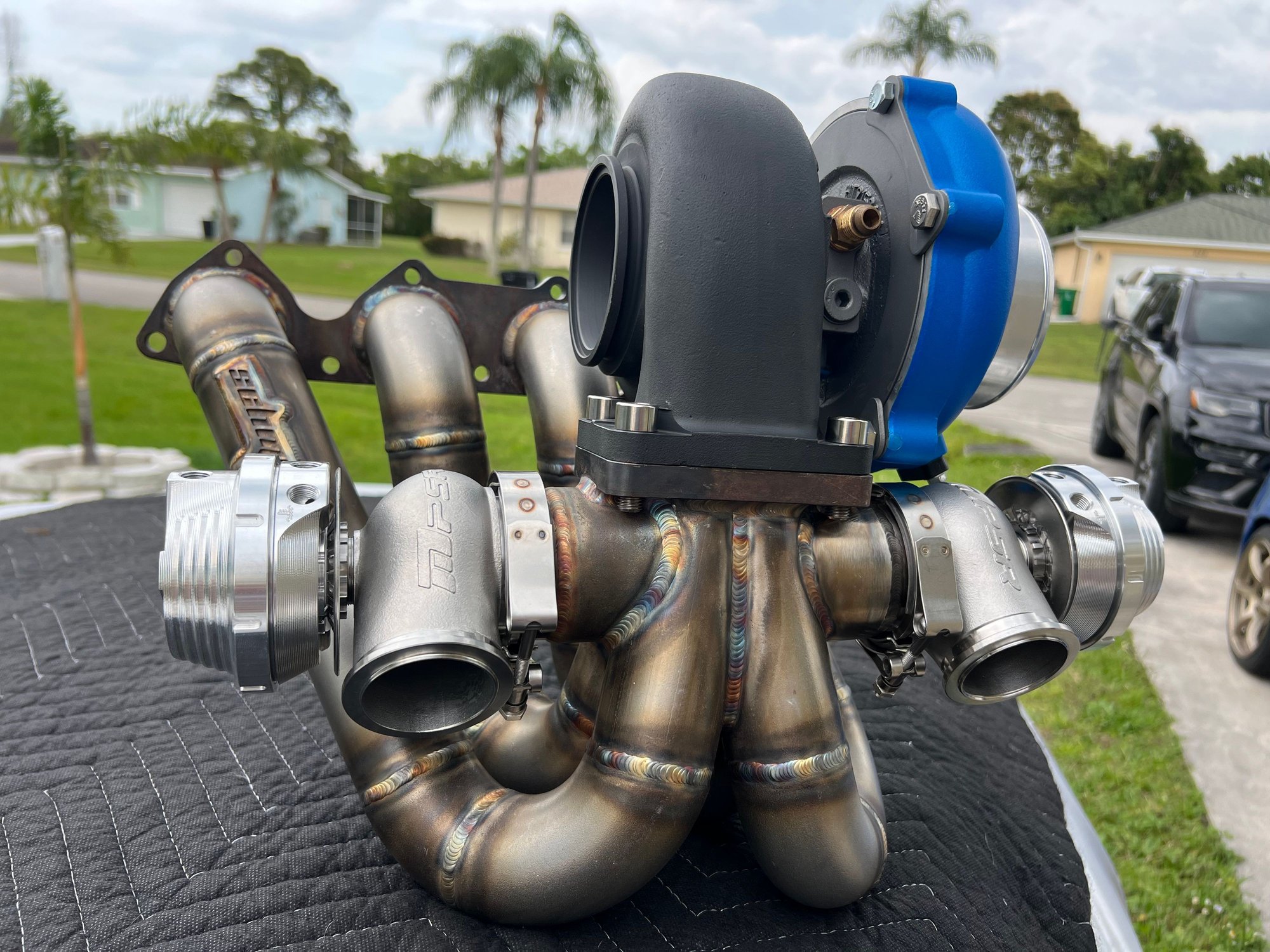

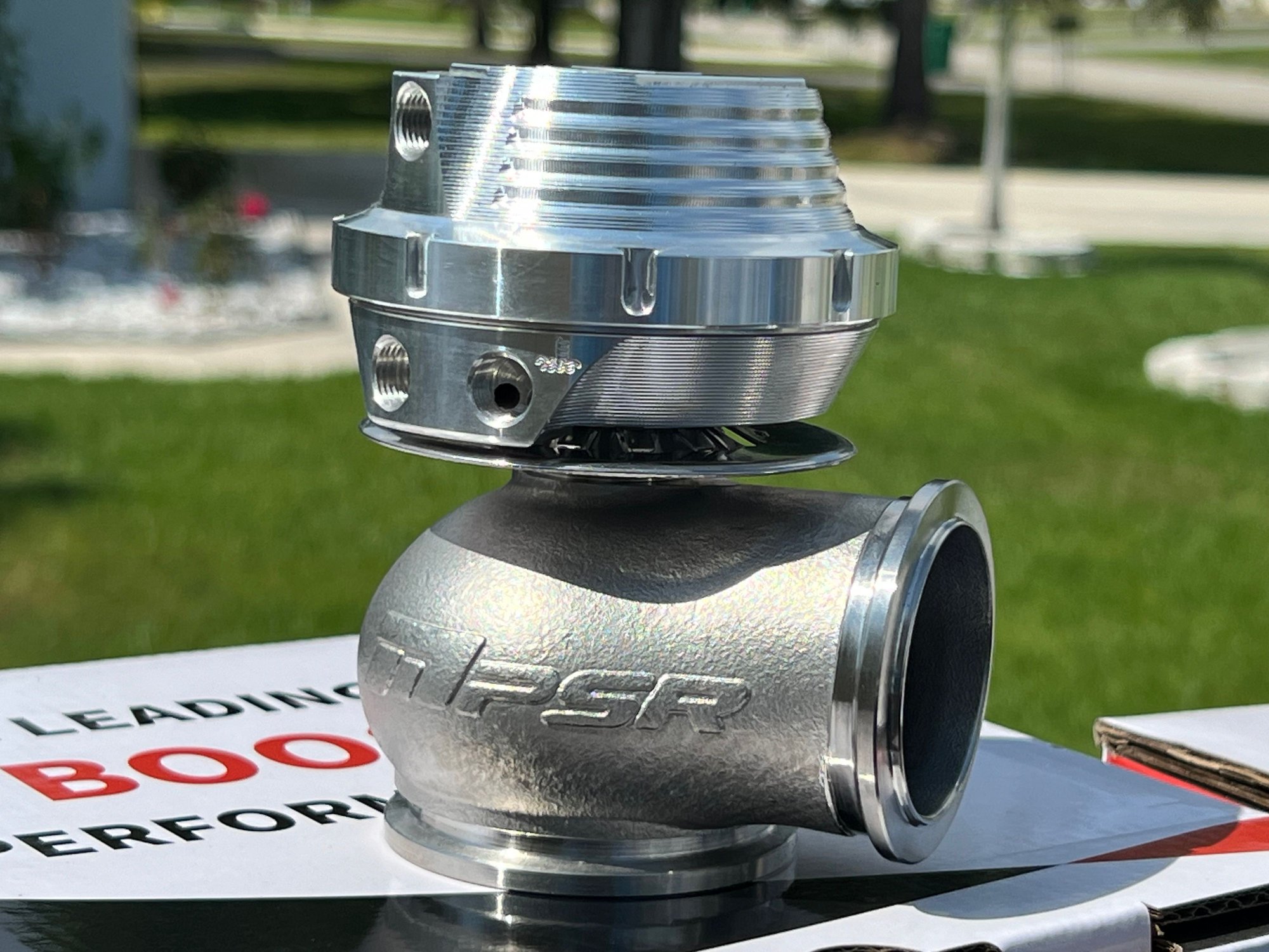

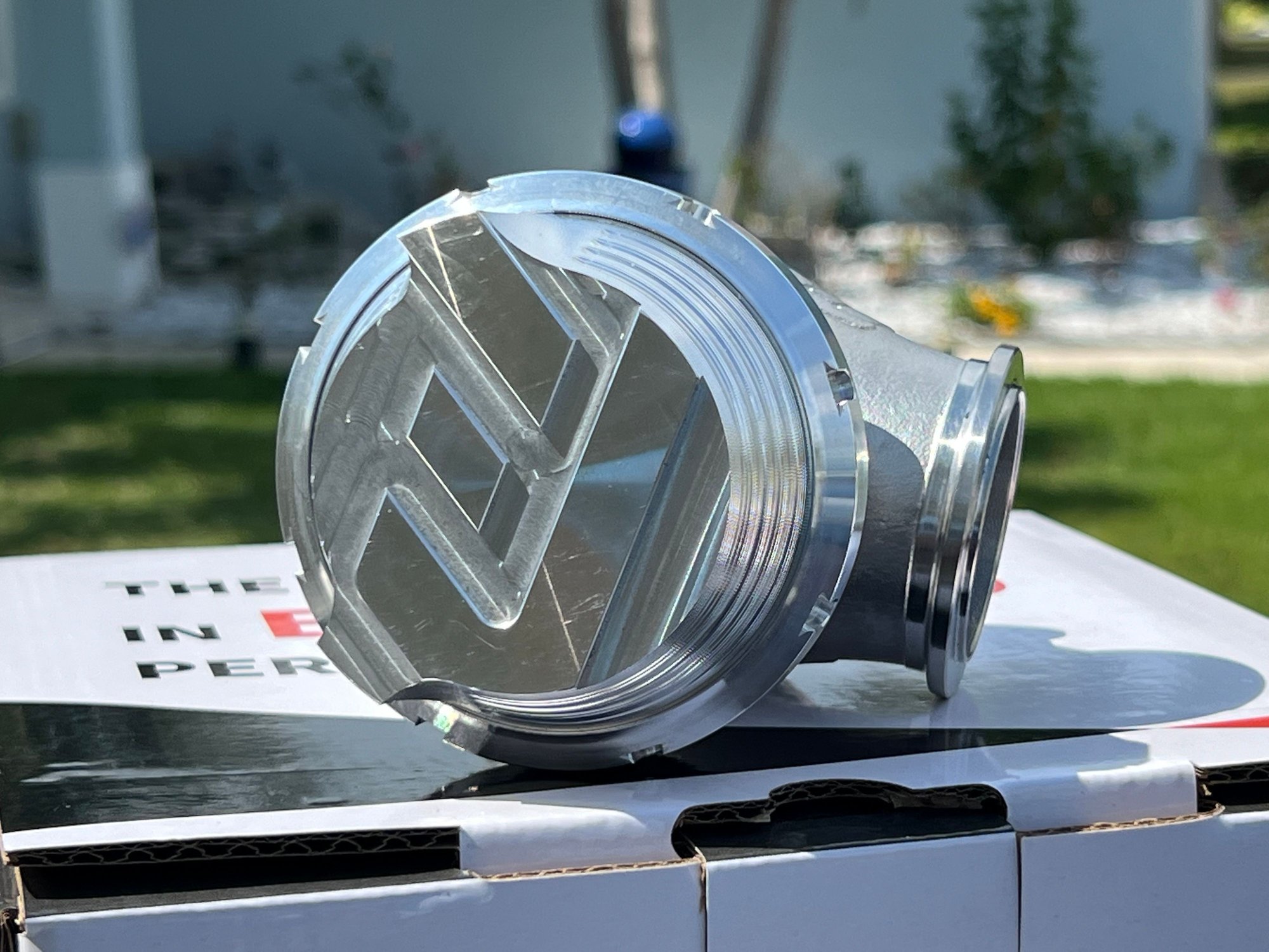

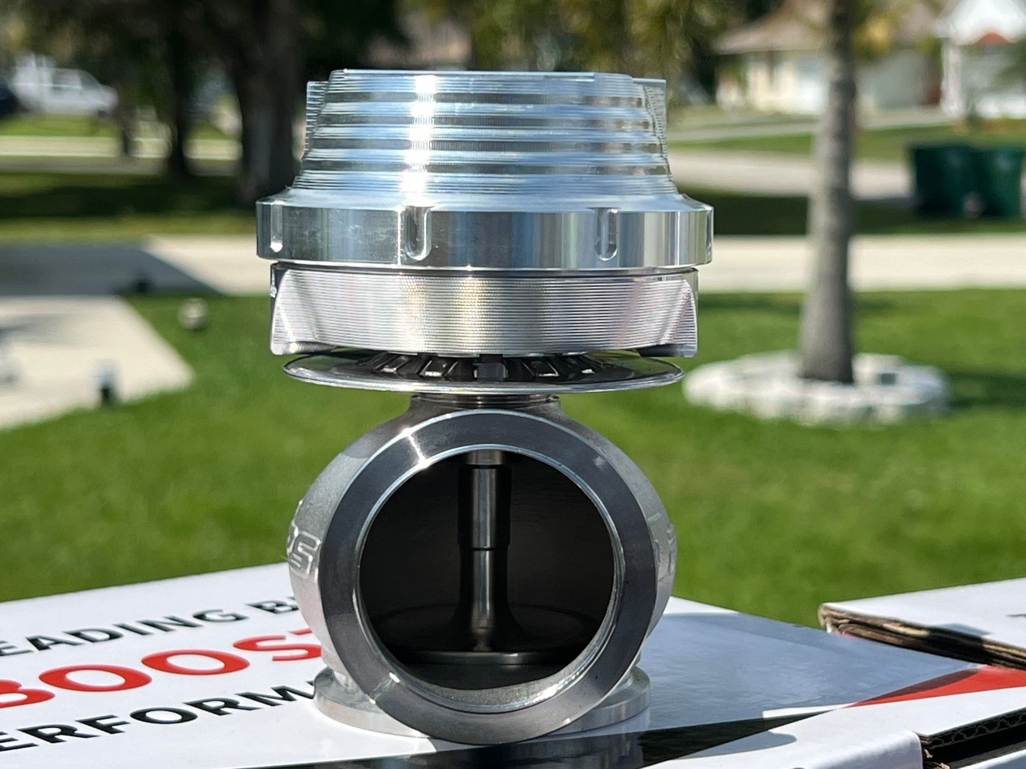

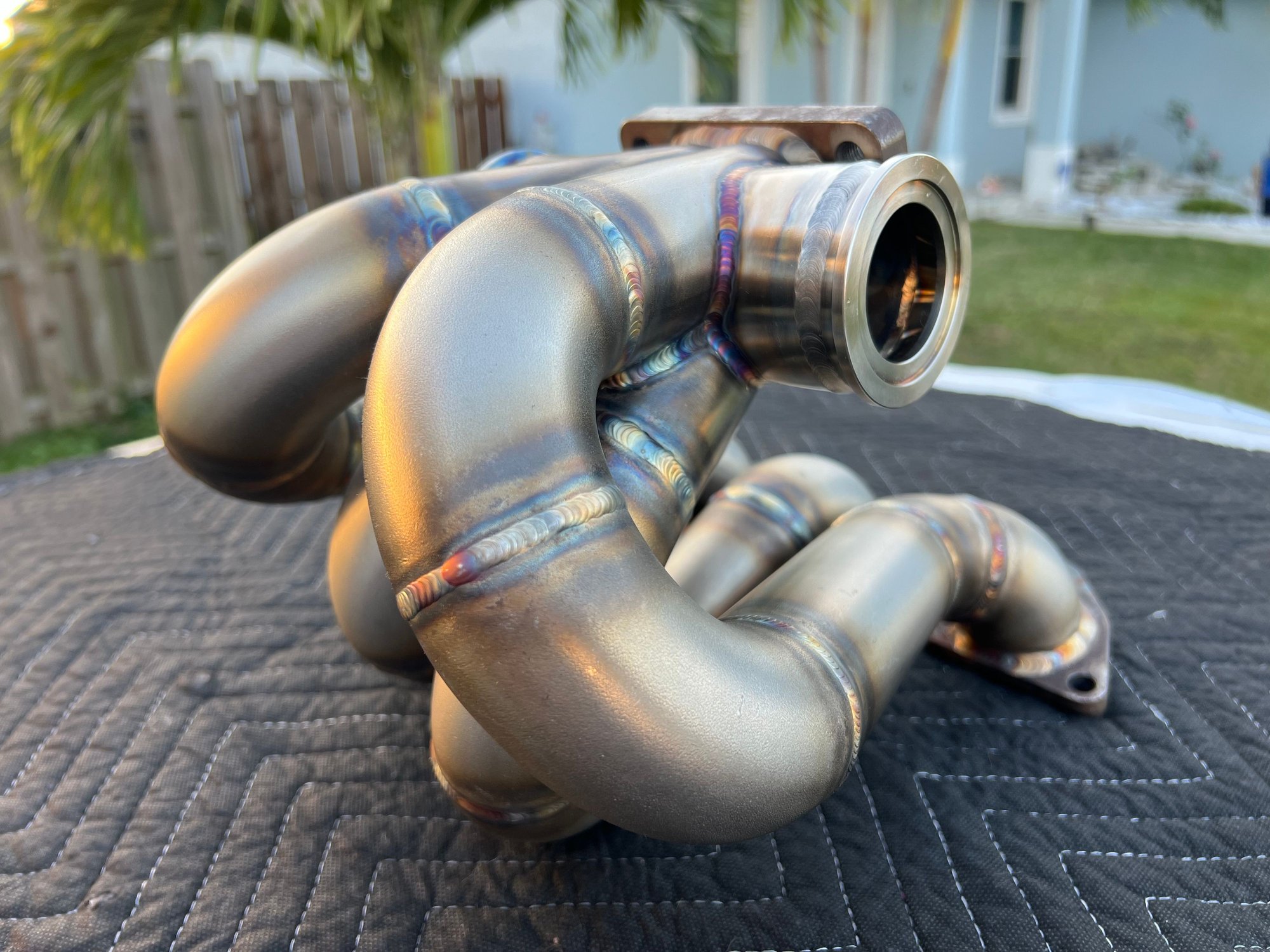

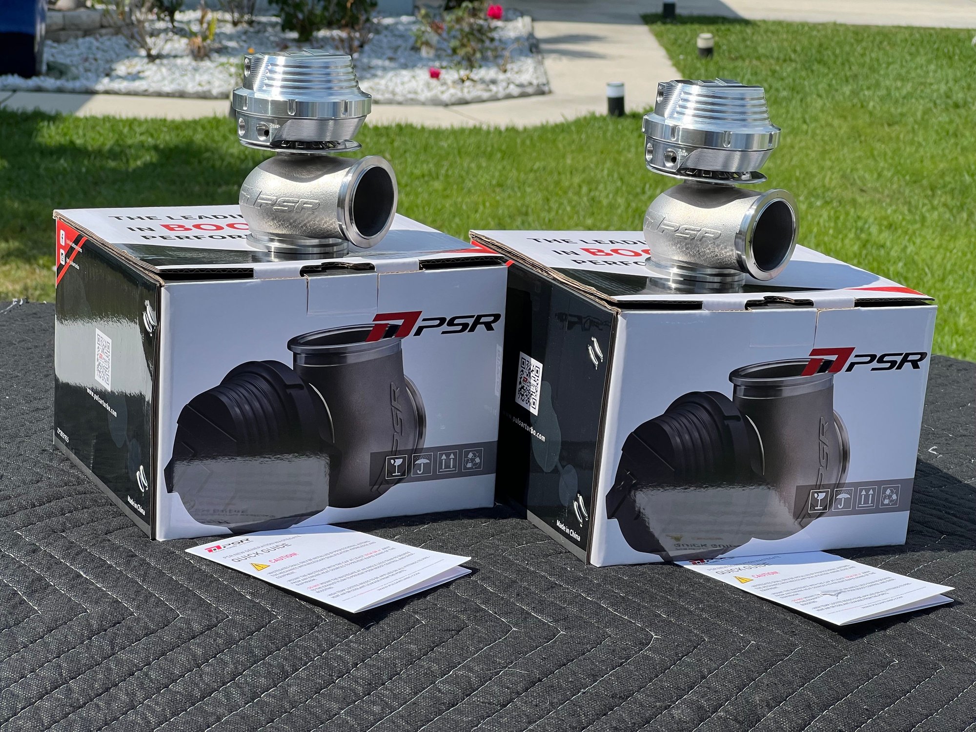

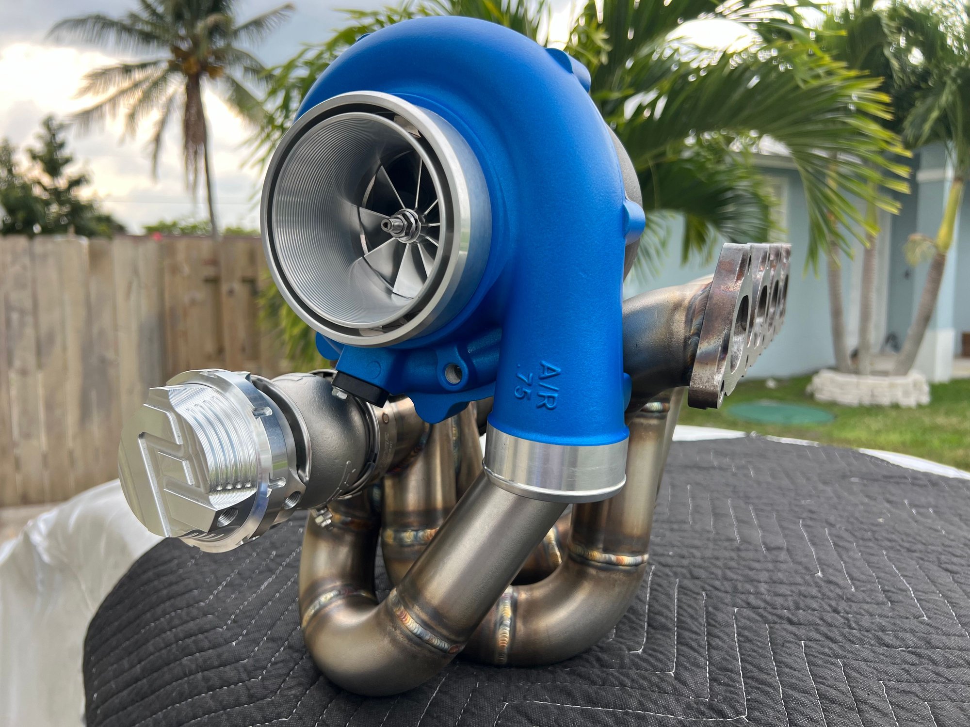

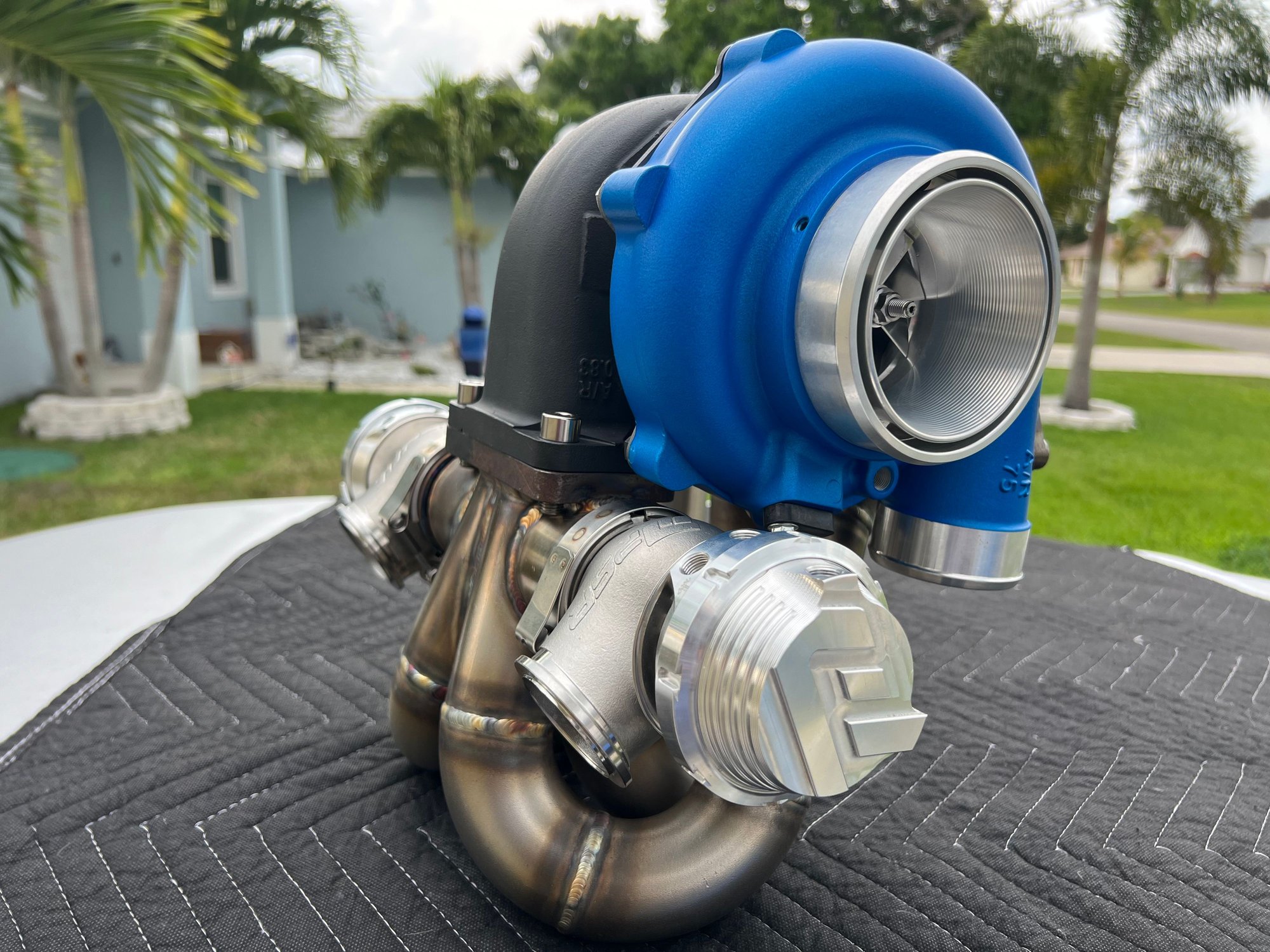

I got the top mount turbo manifold modified to run dual 45mm wastegate valves. My local Fab guy did a great job on it.
I also got the New Generation 45mm wastegate valves from Pulsar Turbos. I have friends using them with excellent results.
I really would like to hit the 800WHP mark with this 6862G Pulsar turbo. I know it is possible 🤞🏽.

Setup is coming together nice!! As much as I hate knock off turbos I have to admit Pulsars seem to be holding up for cheaper brand turbos.
