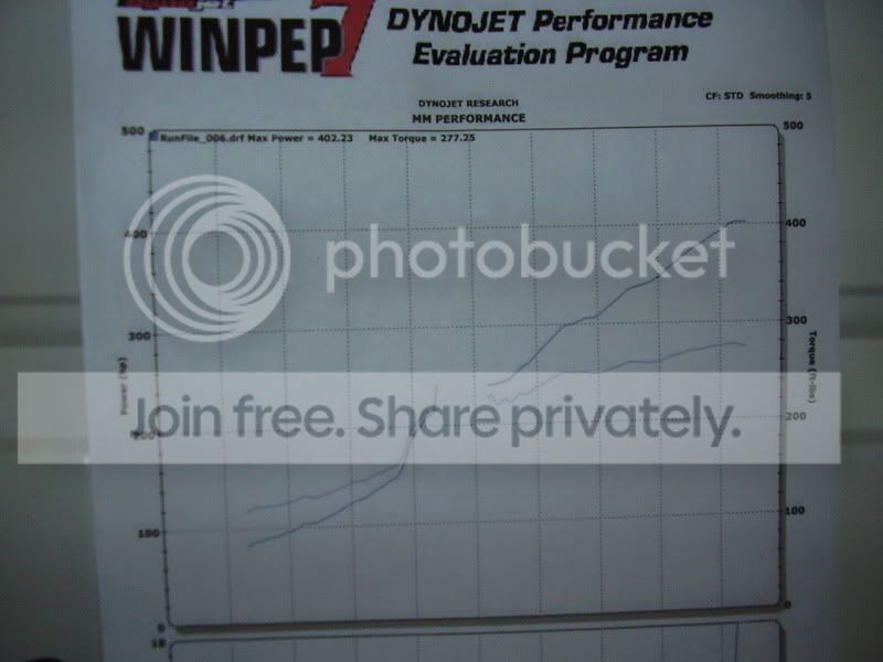

did 401whp on pump gas and 1 bar with a T3/60-1 with .63 hot side, stage 3 wheel and S comp cover. on 23psi race gas street tune the times are in my sig. that is all on the old 81mm set up. new numbers this week.
