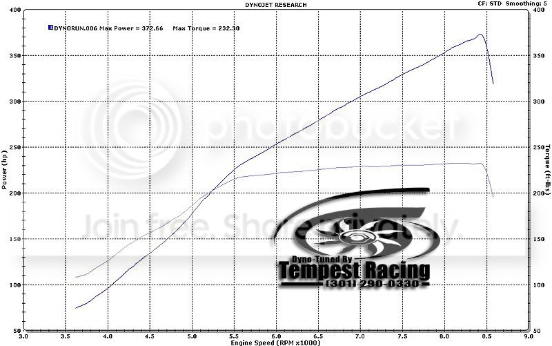

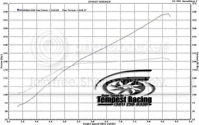

here is another car

Default Re: 57 trim turbo question (Turbo-charged)
were these dyno graphs done with the 57 trim t3to4e or the 60-1... and no one has said how they like the t61 just incase i wanted to run 500hp
