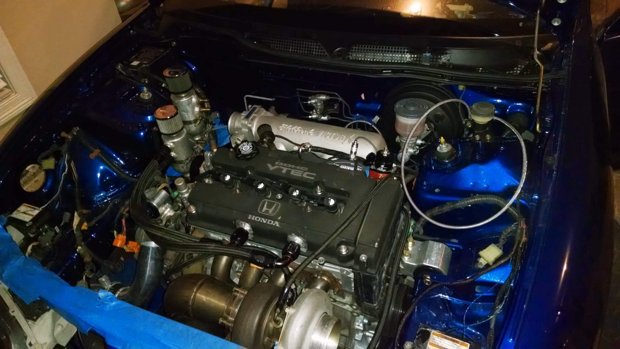

For all you folks running a top mount with a 4” downpipe how are you cooling the radiator? Pusher fan or puller fan? Car now has a pusher fan on it but it kinda heats creeps. I was thinking of getting a SPAL 13” pusher and giving it a shot since there isn’t much room for a pulled unless i may go to a 12” fan. I also will be wrapping the downpipe to keep temps in the bay down. Thanks for the help.
