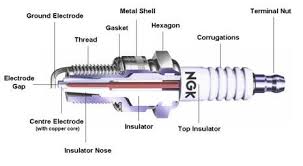

Spark plug construction
A spark plug is composed of a shell, insulator and the central conductor.
It passes through the wall of the combustion chamber and therefore must also seal the combustion chamber against high pressures and temperatures without deteriorating over long periods of time and extended use.
Parts of the plug Terminal
The top of the spark plug contains a terminal to connect to the ignition system.
The exact terminal construction varies depending on the use of the spark plug.
Most passenger car spark plug wires snap onto the terminal of the plug, but some wires have spade connectors which are fastened onto the plug under a nut.
Plugs which are used for these applications often have the end of the terminal serve a double purpose as the nut on a thin threaded shaft so that they can be used for either type of connections.
Insulator
The main part of the insulator is typically made from sintered alumina, a very hard ceramic material with high dielectric strength, printed with the manufacturer's name and identifying marks, then glazed to improve resistance to surface spark tracking.
Its major function is to provide mechanical support and electrical insulation for the central electrode, while also providing an extended spark path for flashover protection.
This extended portion, particularly in engines with deeply recessed plugs, helps extend the terminal above the cylinder head so as to make it more readily accessible.
