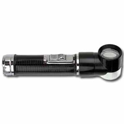

That magnifying glass above isn't any good. You need the right tool to do the job.
This will actually allow you to see the base of the porcelin.
Thanks that post will be edited with the right tools and links too.
Anybody who has actually used that one knows it isn't good unless you are a cave (pitch black). The light is so weak, I tossed it in the trash the first time I used it. Not as fancy looking, but the Moroso one is much better...
