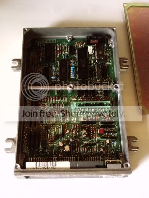

What kind of ECU is this?

TIA.

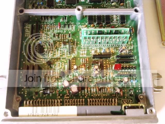

Looks just like a chipped OBD1 P28 (VTEC) ECU ... or what information do you need?

oh, I was just curious what kind of ECU it was since I was told by the previous owner that it is a Hondata s100, obviously not. I am in need of a retune because the tune in the ECU isn't perfect. How do I find out what kind of programming is used on this chipped ECU?

This is not a Hondata S100, for sure.

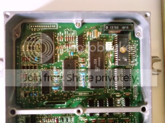

You need to pull the EProm, read it with a EProm Programmer and view/analyze it with a rom editor. With a little luck Crome can read it.

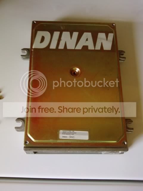

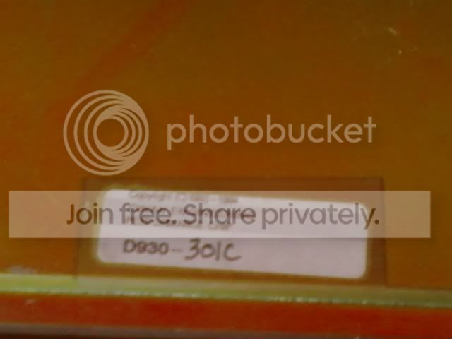

From the look i would think it's more or less a gerneric "chip" installed. (from the label on the ECU "DINAN") If you need a retune and you don't even know what's on the chip, i would say it's better to start a fresh tune. Than you have the free choice of system and tuner.

bummer. guess I'll start saving for that s300 now, hahah. thanks for the help and info.
