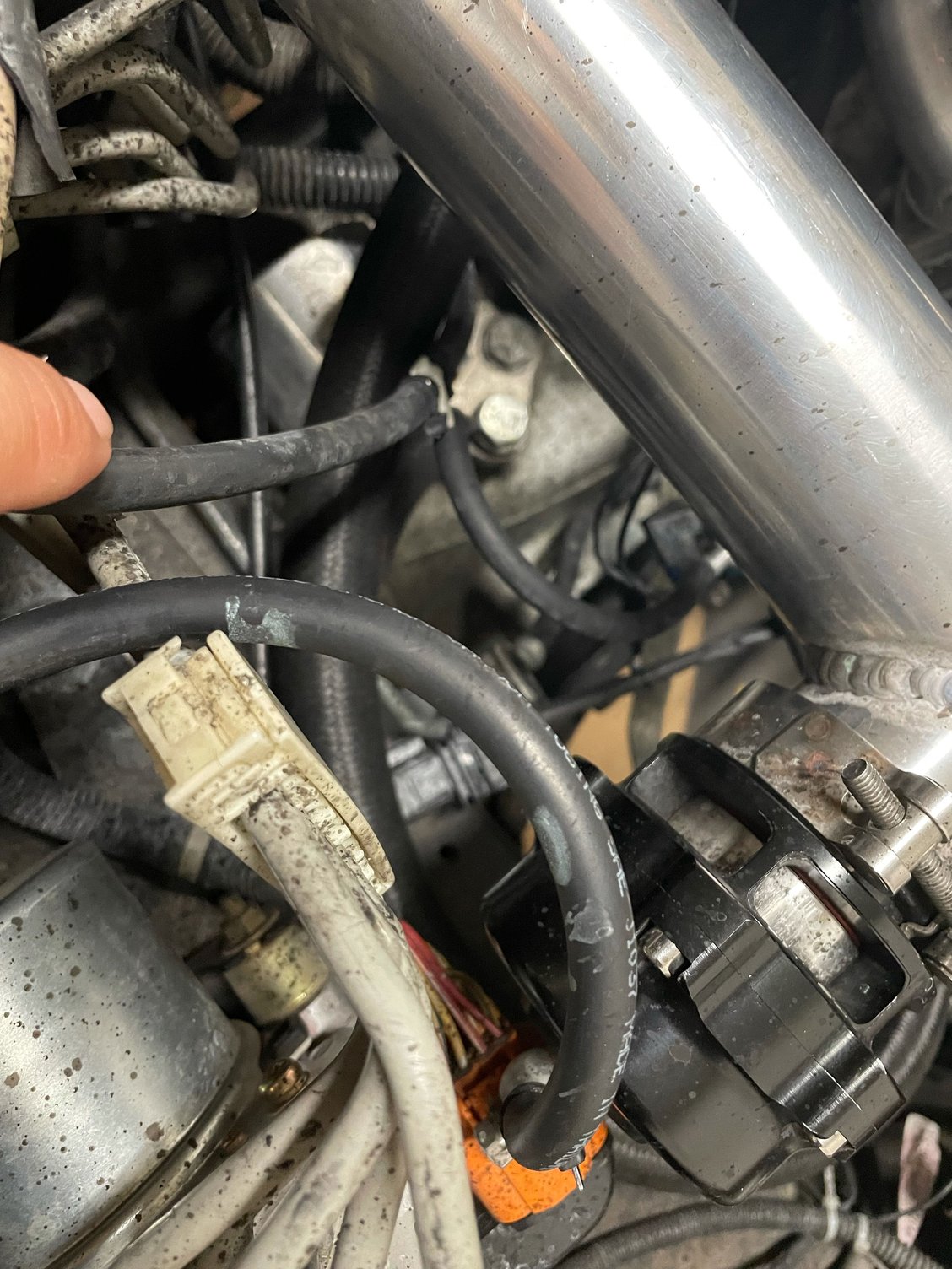

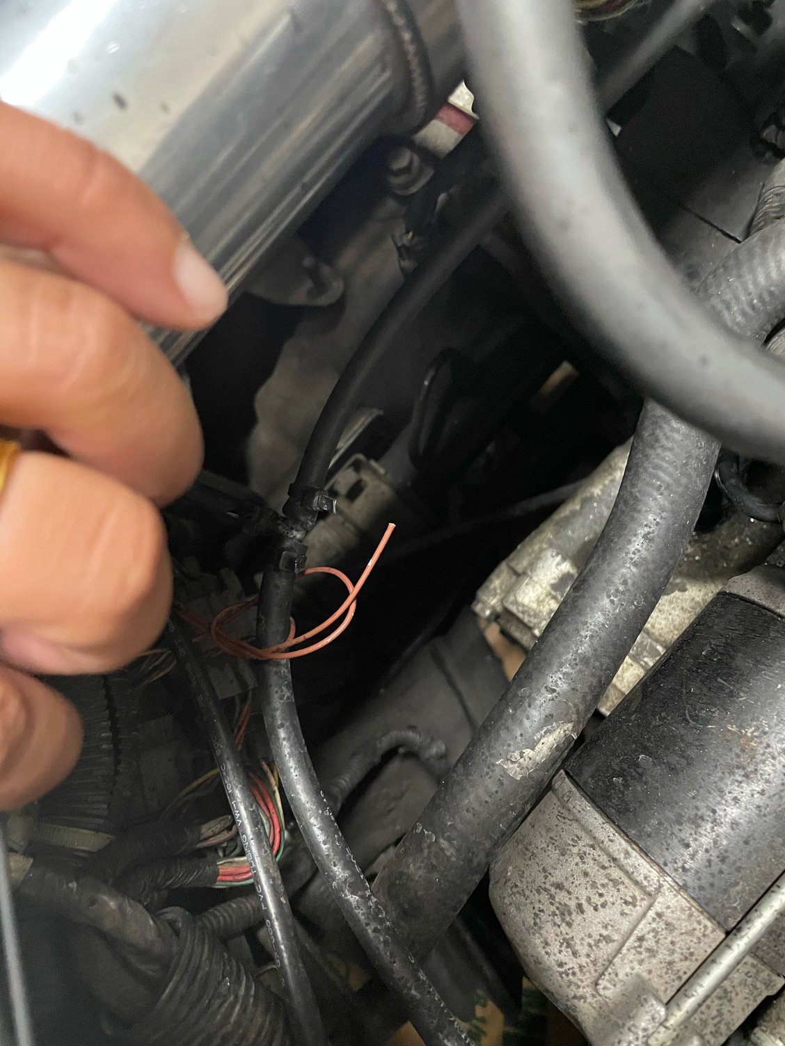

So I'm having some issues with my vehicle not being able to build any boost past 3ish to 7 and some change psi. The car is a 2000 Integra with a b16a2 turbo.
My tuner has absolutely been no help so far so hopefully you guys can help out a bit. When I am driving the car I am unable to build boost past 3/7psi it seems like it hits a boost cut. The car is on boost by gear: 1st is gate, second should be around 13/14 I believe, and 3rd and up is like right around 20. The car has a new distributor on it (an obd1) cheap mostplus with the wire harness conversion to obd2. 7e plugs on e54 gapped to .19.

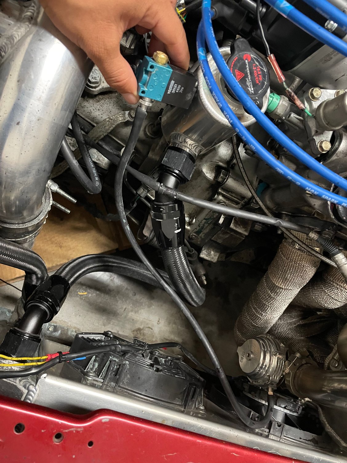

At first I thought it was an issue with spark blowing out but no longer believe that to be the case. Currently, my cluster rpm gauge doesn't work due to the distributor I currently have (I would like to get an obd2 one so if anyone has any suggestions where to get it please let me know also car makes 446whp) and my speedo is also not working. At one point while driving the car it gave me a VTech solenoid circuit high voltage code. I have a single wire running to my vtech solenoid straight to the ecu. i saw that it had become pinched so I freed the wire and the code went away. well, I got the code again and thought that this could be why I wasn't building any boost so I pulled the solenoid checked to make sure it was clean it was and the plunger operating properly put it back code went came back. so what I did was went into Smanager and turned off vtech thinking this would help solve the issue seeing as boost and that come in around the relatively same time. well, that didn't help. I pulled the mac valve and checked it on the battery and it pulsed so I believe that is in working order. I'm a bit lost here am I needing to get it retuned I couldn't expect that to be the issue out of nowhere. so now I'm going to check all the vac lines concerning the mac valve and wastegate to make sure they are clear and not clogged. any pointers or next steps would be greatly appreciated. I'll attach some pics so you can see how the vacuum lines are hooked up. It won't let me upload the datalog for some reason, but if anyone wants to see it I can email it.

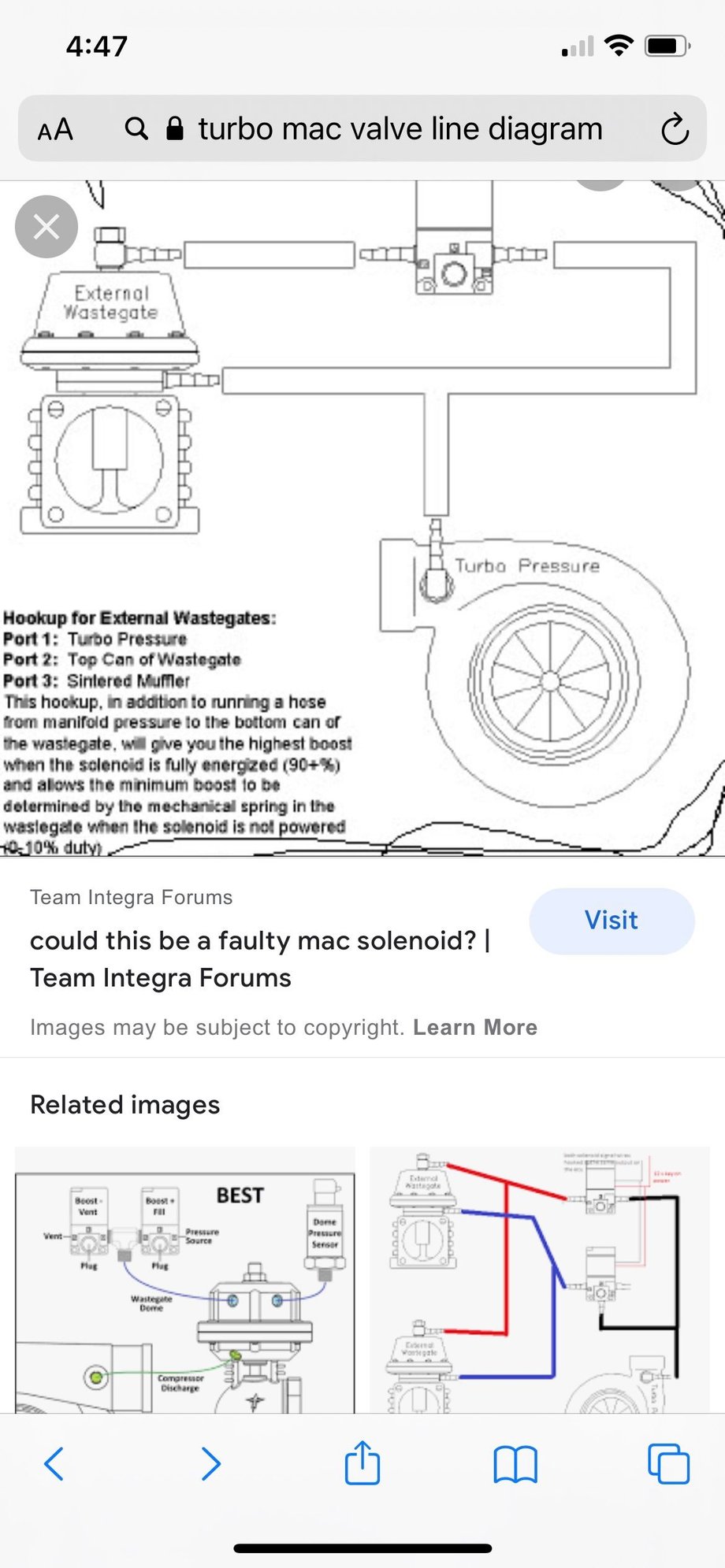

I just changed it and hooked it up how the hondata instructions said. So we’ll see if that works

I connected everything like this and I wasn’t able to build anything last like 4-5 lbs. I also tried it without the compressor housing and it still didn’t work.

What do you get for boost without the boost controller? Just wastegate to compressor.
Old Sep 27, 2021 | 10:11 PM
alhara23's Avatar
Joined: Sep 2021
Posts: 18
Default Re: Unable to build boost

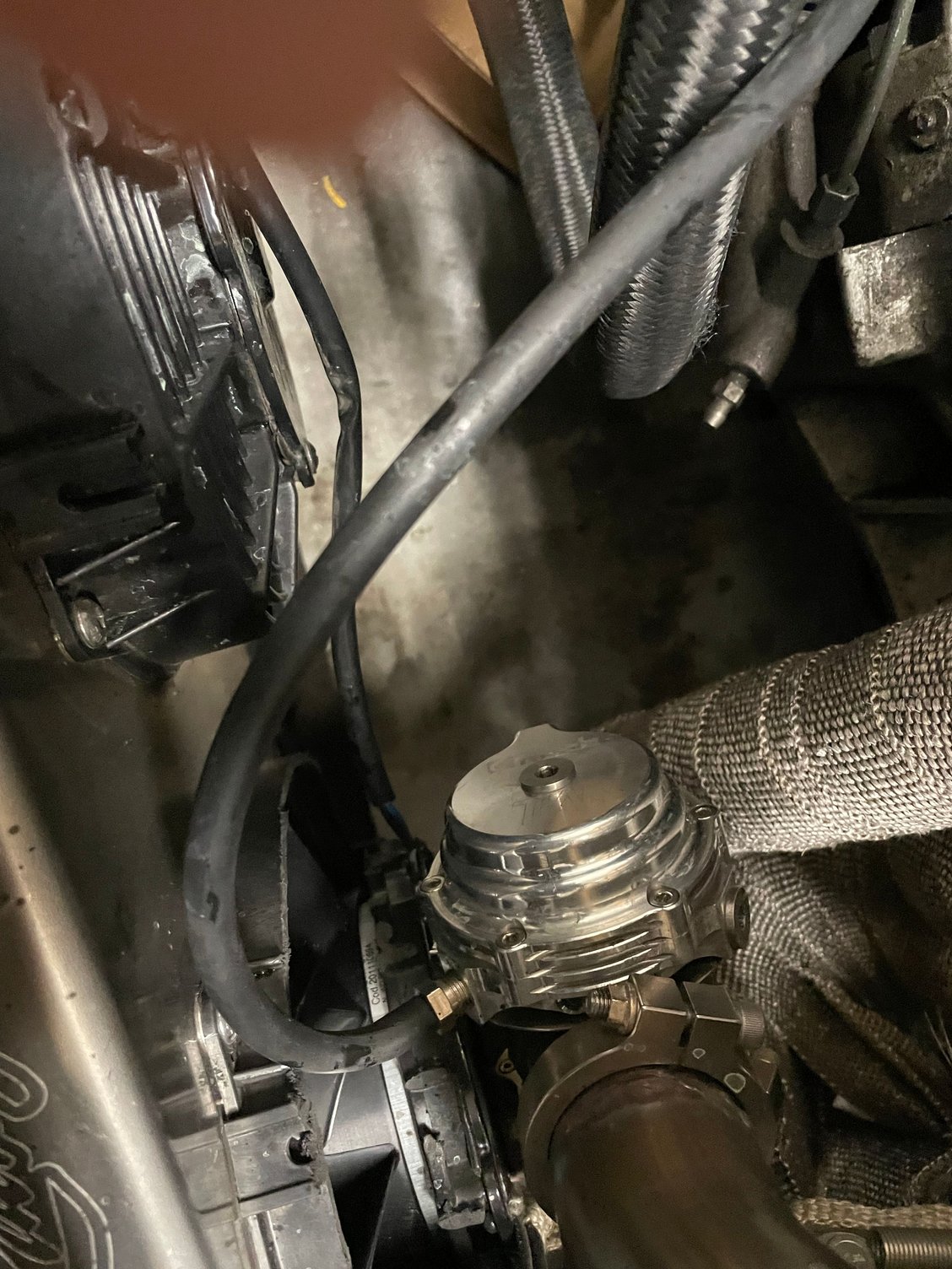

I may have hooked it up wrong. Which part of the wastegate is supposed to go to the compressor? I did it with no vacuum lines going to it and got like three lbs. Do I go from the top or the side of the wastegate?
Old Sep 27, 2021 | 10:21 PM
Ryanthegreat1's Avatar
Posts: 3,589
Likes: 505
Side.

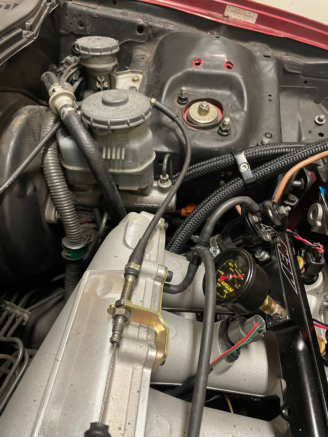

So when I drive the car it feels fine n pulling "good" when it starts to build boost then it doesn't necessarily fall on its face but it really seems like a boost cut. So i re-checked the i/c piping no rips and it's all on and tight. I tried to run a vac line from the turbo compressor housing to the side (bottom) port of the wastegate (i put a slightly heavier spring in it last night) i went from roughly 10 to roughly 13 and took the car for a spin about 10 min ago and it hit 3psi in 2nd gear and 5 psi in 3rd. the ebc is not hooked up its just sitting there the vac lines for the bov and going to the intake manifold are all hooked up with the one that would have gone to the mac valve being plugged. So i believe my tuner originally used the wastegate for a boost reference it was set up originally how the pictures up top showed. the biggest difference from when it was running correctly is I put that skunk 2 intake manifold on. but I don't believe it to be a boost leak seeing as the wategate wouldn't even reach gate pressure? car is also still on the boost by gear tune. I don't know if that would have something to do with it. but I had also tried a different tune and that one also did not work. the afr seems to be in line with what it should be I wasn't able to load a data log on here Idk why my wife tried to help lol most I can do is email them if someone is curious. I also wanted to say thank you for the help thus far I really do appreciate it.

The turbo sounds fine- no weird noises or anything. I hooked up the wastegate to the turbo compressor housing to the side of the wastegate with the top port VTA. I start to see boost probably around 3000 rpm and then there’s a cut around 4-5000. It usually builds to around 5-7 psi but yesterday I got 3 psi in 2nd gear and then 5 psi in 3rd, but then 0 when I went back to second
