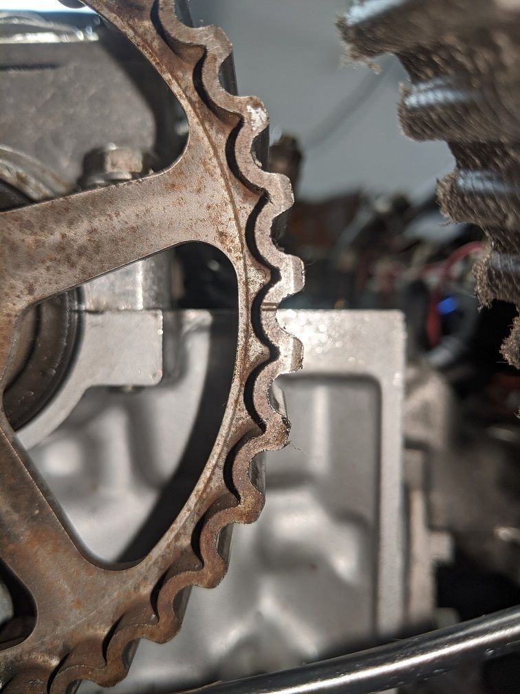

Then I set the camshaft sprocket to TDC and matched up the marks with the edge of the block.

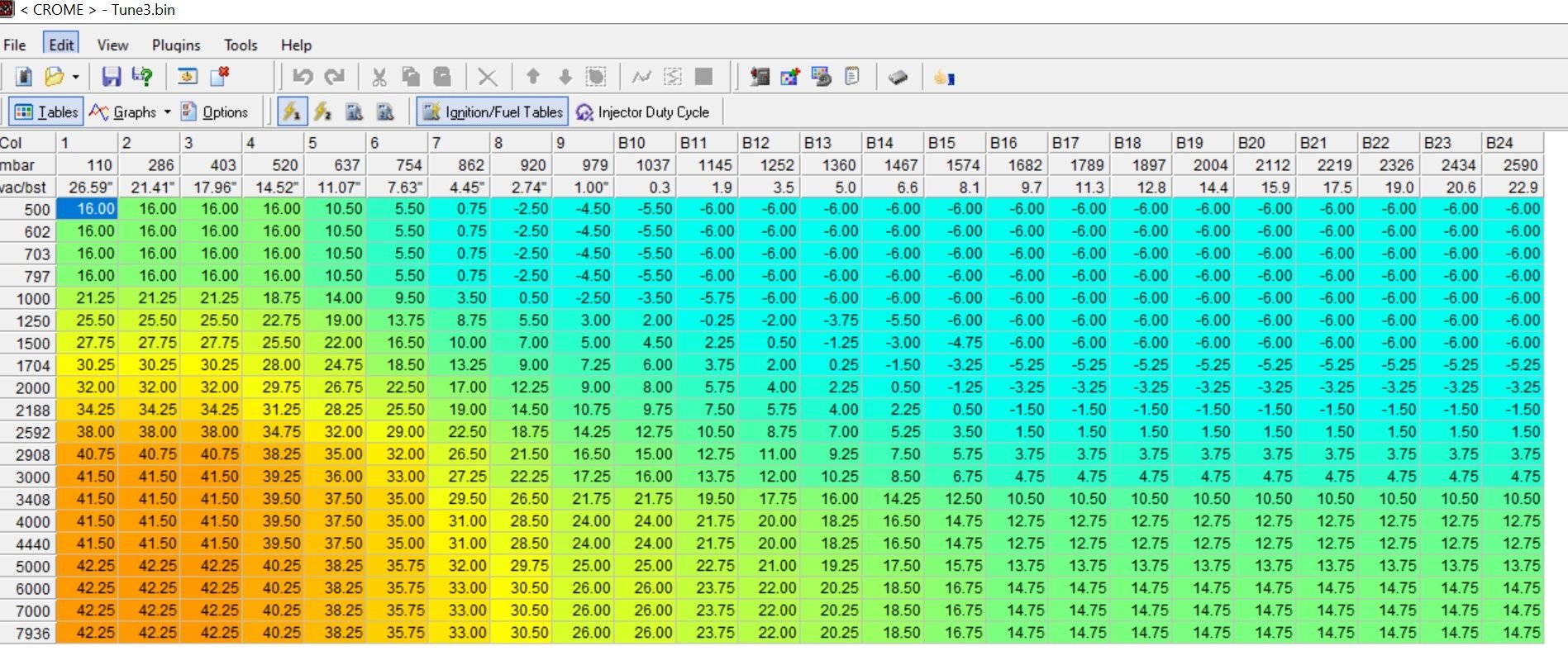

EDIT: Here is what my tune looks like in Crome as far as timing goes

Well to start, you have a D16Y8 so your base timing is 12°, not 16°. You can idle at whatever you want to in your maps but the marks on the pulley are at 12° so that is where you need to lock the timing when you connect the jumper or whatever you do in CROME. Is your distributor original or aftermarket? Any head milling done? Your mechanical timing looks fine from the pics.

Okay yeah 12 degrees is right for the y8 which is what I have. I think the z6 block is 16 dunno why its set like that. Good call. And no I have a cheapo dizzy on there now - I replaced it before I did the head I just haven't put any miles on it so it very well could be faulty. The head was not needed to be milled as far as I know.

Yeah man that's me haha both of those are set correctly even took pics to verify - timing still way off with the light. Betting my faulty MAP was making things go haywire. Soon as I replace that I'll try the light again! I KNOW the mechanical timing has to be correct - it fired over really well and didn't hesitate when I revved slightly
