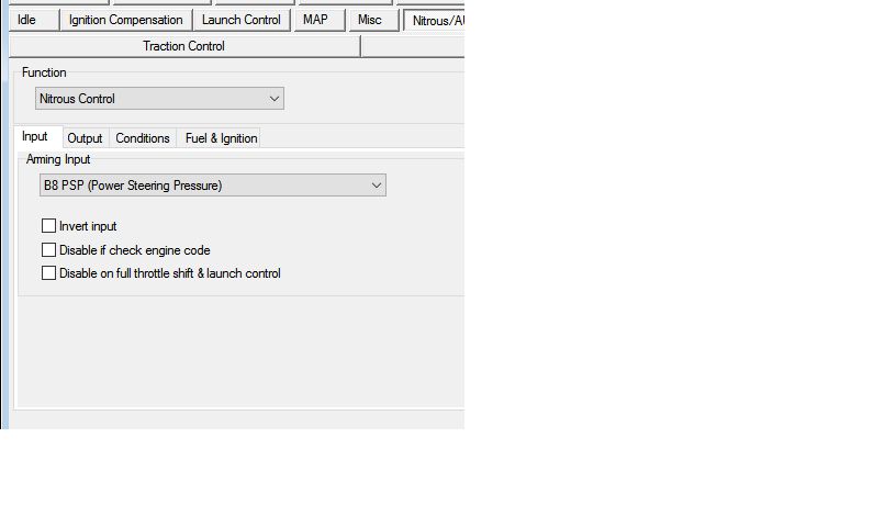

I wired the relay and switch according to the wiring diagram per hondata but I can not get the nitrous the activate after arming.

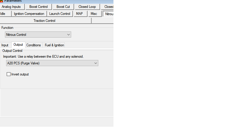

Output side: I tested the output via Smanager and the solenoid clicks when the output is tested. Nitrous discharges as it should.
Input side: When I flip the toggle switch to arm the nitrous system, I can see the psp switch on and off in hondata along with N1arm. When I invert the input I can see N1arm switch on/off.
When I invert the output the solenoid clicks to open and stays open. It seems like the wiring is right. I just don't understand why It's not activating the solenoid.
What am I doing wrong? I tried the default settings too and nothing. The input switch is grounding like the instructions say to do.

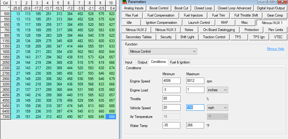

In your settings, are your pressure and vacuum units set to absolute or atmospheric? Your load conditions seem suspect to me there, and are the only thing you haven't really tested. I would set the max to a number just higher than you highest load column and set the minimum to your third highest column value. Then try again.

My units are setup to represent atmospheric.
I was just trying to set those parameters to activate low (with nitrous off) where the solenoid would click and my timing and fuel map would change to see if it would work. I have a feeling the conditions are the problem as well but I can't seem to get the load parameter met. I have put it on PSI, Mbar, Inches. I'm not turbo or in boost so I figured that putting it on inches and 30" vacuum as the min. so that it clicks over the the sub map easy.
I'll play with it again today and see if I can get it to work. Thanks for the suggestions!

Here, I just created a new cal and set it up kind of like yours.
Try something like this:
I don't have access to an S300 car to try it on right now, but it seems like this is the only parameter you haven't been able to meet yet.
What does the data say about it? have you looked at a dataset to see if you are meeting your conditions? What are the values of all of these parameters at the points where you want the nitrous to work?

Again, have you looked at a datalog to see if you are meeting all of your conditions? Or are you just throwing darts at it? You have the tools to figure it out.

Sorry I didnt update yesterday but I got it figured out. I had to invert the input. I thought I tried that before but maybe I have the conditions wrong for load.
