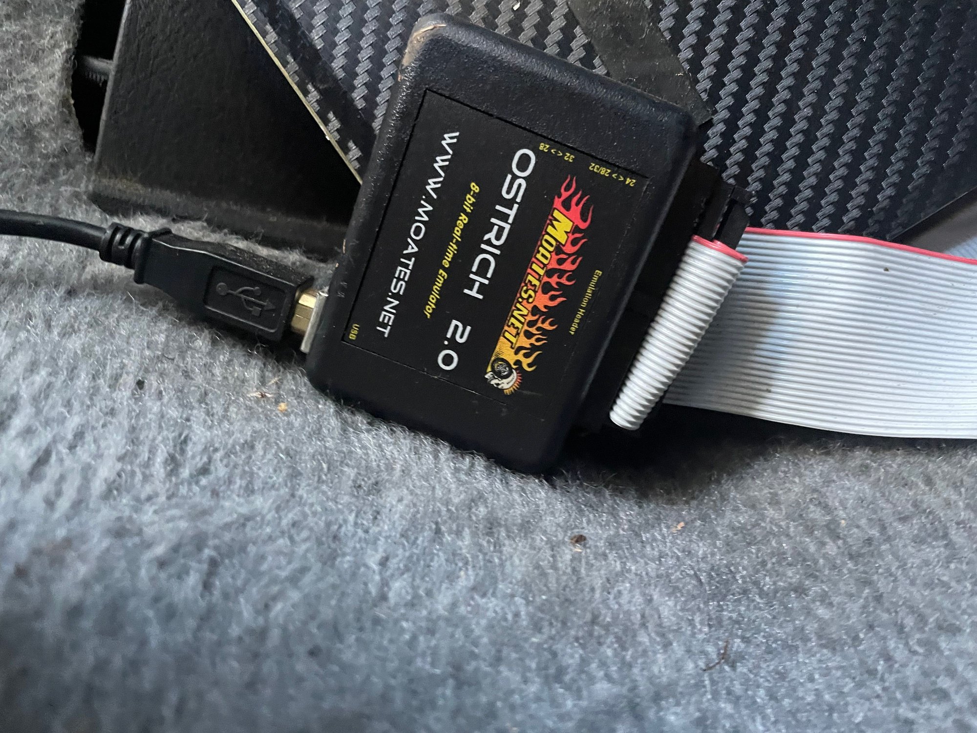

Hi I have a pop tune with 2step added and I really want it to be removed as it pops in every gear at every rpm al the time and it just draws too much attention and dumps fuel in just looking to get some help on how to actually revert it as I was not the one who did it. So I’m just wondering if I can plug it into a laptop and disable it
Has a p28 chip from ostrich

Load up Crome and go to town. Probably need to add timing back in to the ignition maps around high RPM high vacuum areas of the map. You will probably see a super obvious hole in the ignition table where some bozo retarded the timing to a negative value. Also check the box to turn decel fuel cut back on.

Thanks for that I’m just a bit sceptical since I have never even done anything like this and have no clue but I’ll search some more on it
