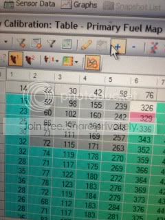

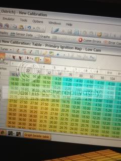

I was too scared to raise the idle, but at one specific point the car died out because I thought timing was the issue. Following my buddies ideas, who for some reason had great success with a megasquirt standalone, tuning his miata, I advanced the timing to be set at around 13.00 BTDC going across the horizontal rows/columns right before boost at about 500 to 800 RPM. (Here is the stock non adjusted picture for reference that I used later on to crank the car which significantly showed improvement, and I think I should've just stuck to that!!) Sorry that I am making this more confusing than it already seems.
In Addition, the low fuel values already pre-assigned to the low cam fuel map by default when the basemap was created had to be the main restriction as to why the car didn't want to start in the first place.

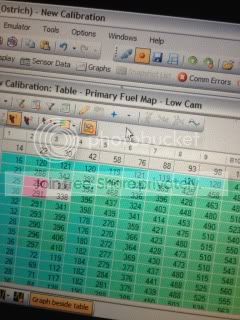

After figuring it all out after about 4-5 hours of messing around with it, I am hopefully hoping to god that nothing more than a blown head gasket was brought to the massacre table through these inexperienced hands by trial and error. For the car to have the potential to even idle at a steady 700-800 RPM, I noticed that the fuel units had to be increased like so...
opposed to the "DEFAULT" Settings...
Starting the car at a fully warmed up temperature(210*) is another problem that I experienced. When I ran the adjusted fuel map for cranking during a cold start. It seemed the car had no problems starting when the 500 RPM row right before boost(which im guessing is cranking) was adjusted like so ...

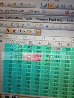

.. I create a basemap, on 890cc for new Injector flow rating(Like you stated Bugermass), and on a very stone cold start, this is what the new fuel values are, when adjusted from the actualy default p72 settings on a 890cc flow rating setup for my ID's.
If you compare the picture above(1000cc) flow rating with the one in this post, I have lowered the fuel values by a lot. Maybe I should lower the flow rating down to 770-790cc, and see what happens from there, with the default gsr basemap. It seems like the car has a much better chance starting, since the fuel multiplier has jumped quiet the gun in parameters.
