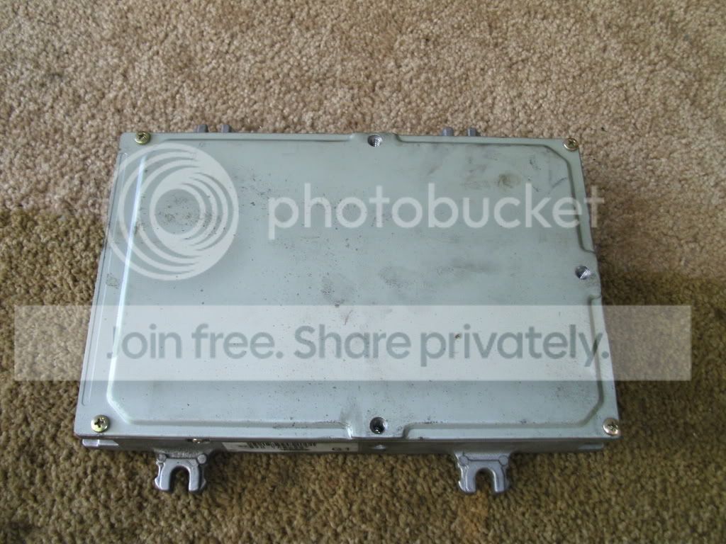

sorry for the hotlinked images...
OBD1 P28:
OBD1 P72:
OBD2 P72:

I can see right off the bat that the OBD1 IC12 switch that is braced to the case wall of the ECU is in a different location between the two. The OBD2 P72 doesn't look like it has room for it at all. It seems to have two switches braced against it's case.
Your image of an OBD2 P72
My image of an OBD1 P75, same case configuration as the P28.
I'm guessing that it's not going to work just from comparing the two pics. There are a few key components that would be in the way. What are the dimensions of your P72 case anyway? The OBD1 P28 case is 9 1/2" x 6 3/8"

The holes look like they may be in the right spots, however, the mount for the regulator is not, which means it will have no proper heatsink. This may cause problems down the road. All and all, I don't see why you didn't just try it already.
