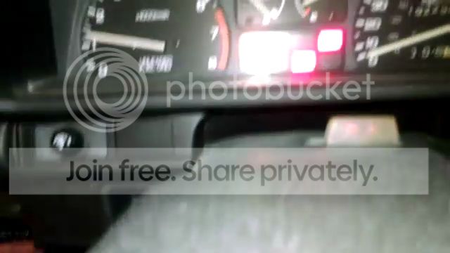

I've tried a new ECU. Same solid CEL HOWEVER, the car started. It is in 'limp mode' though. It won't rev past 3-4k and the idle is shaky as hell.
I couldn't pull any codes via the RTP either, so I assume this is limp mode. I'll try searching but most threads on limp mode don't seem to help me. I want to trouble shoot it, not throw parts at it.

Yeah, $1500 vs my $300 unit just isn't going to happen. Shoot, there isn't one thing on that car that is worth $1,500. I'd run a stock P30 in it right now if I could find one.
Can someone confirm that this is 'limp mode'
http://vid39.photobucket.com/albums/...psubavvkgd.mp4
Rather long video (

Even powered by USB with the laptop hooked up, it is having issues. The video I posted in my last post was with the lap top connected and a fresh ROM installed prior to turning the key.
