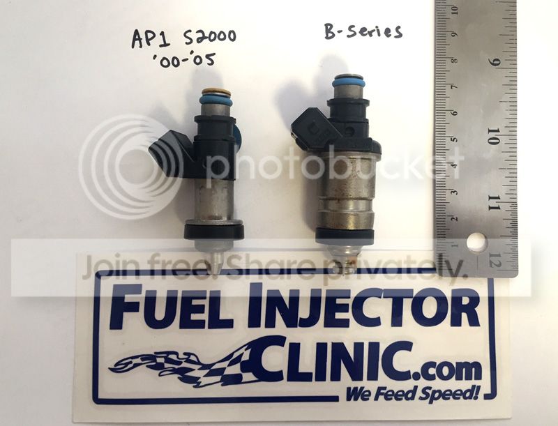

i just spoke with bryan on the phone, he was very helpfull, however we have yet to clearly Identify what part i missing, or what injectors will be the proper fit
here are some pictures to help illustrate what is happening

Is that an injector off of a b20z? They are an oddball of Hondas from that era. Pretty sure they are the typical 240cc, but they won't work off of the stock manifold and rail.
Assuming that is a P75/LS manifold and a typical aftermarket rail, you just need whatever your chosen company's standard civic/Integra fitment is. For some that will be an injector of the correct length. For others, it will be a shorter body with a set of "top hats" to make up the extra length.

I just responded to Mike via email but wanted to follow up here as well in case it helps anyone else in the future.
"I think we found your issue… the injector pictures you sent are for an S2000, not a B-Series. There is a height difference there (47mm vs 55mm, center of upper seal to center of bottom seal) which is creating the issue for you. Please see the attached image to show the difference."

Thanks for that pic Bryan. Those are also the same style that came on the b20z, which I suspect is where the OP got them from since he is running a B20:
Note the completely different method of fuel rail mounting compared to the LS manifold pictured in his previous post.

Thanks for adding that, I did see your last response before posting, seems that the B20z must fall under the AP1 S2K injector fitment instead of the standard B/D/H injector fitment that we commonly see (excluding D17).

im not sure what designation the b20 is, (since im new to hondas) however i do know it was from a JDM 99-00 CRV, and is a high compression motor. I am happy to know i just need to order a new set of injetors (needed anyways) i just didn't want to order the wrong part
