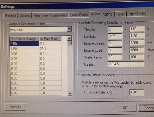

Hi
I need help here... Im trying to set correctly the LM-2 wideband values into Crome to datalog afr. Right now im using these values but they differs a bit from LM-2 readings.
Anyone can share his values so i can copy them on my Crome to datalog correctly?
Thanks

The LM-2 manual states that the voltage scale is to be set as shown in your image. Don't change that!
Where you are getting different readings between Crome and your LM-2. That is where you have to calculate the difference between the two and put that number in the lambda offset (+/-) box in the bottom right corner. You may have to make slight changes to the offset number until they read the same.
Here is a startup link for ya to read through, it discusses voltage offsets and how to set them up;
http://www.xenocron.com/install/Xeno...etup-Guide.htm
