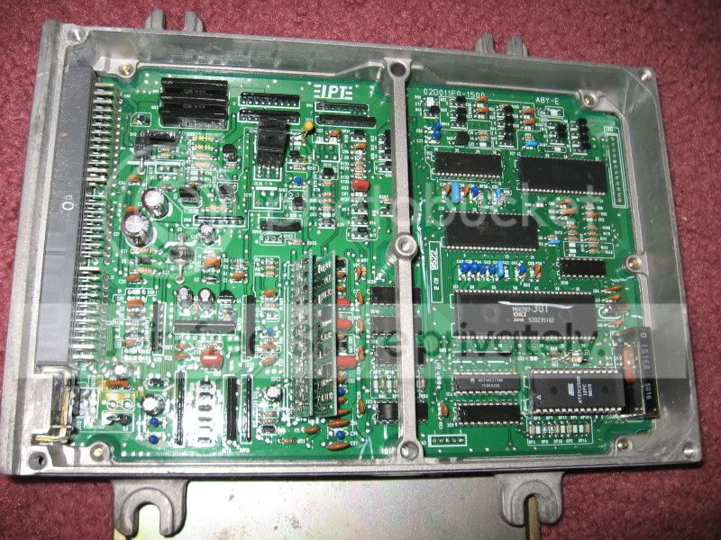

My friend traded me this ECU and told me it was a chipped P72. However, there are no stickers on it, and I'm not sure if it's a P72 or not. Can anyone ID it by the board? It does appear to be chipped (bottom right), and it is OBDI

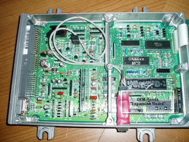

Not 100% sure. This is the best pic i could find. Found some slight differences but I don't know if all years are the same or not. I'm not a ECU board expert by any means but hope it helps!

Nope. It's a P06 that's been converted.

notice the way d11 is sticking up and theres a jumper in j10 thats a dead giveaway.

That doesn't mean it's a P06 though.

The dead give away is the use of the 64 pin MSM66207-301 chip.

no your right but it shows it wwas converted to vtec so it was a nonvtec ecu at one time.
