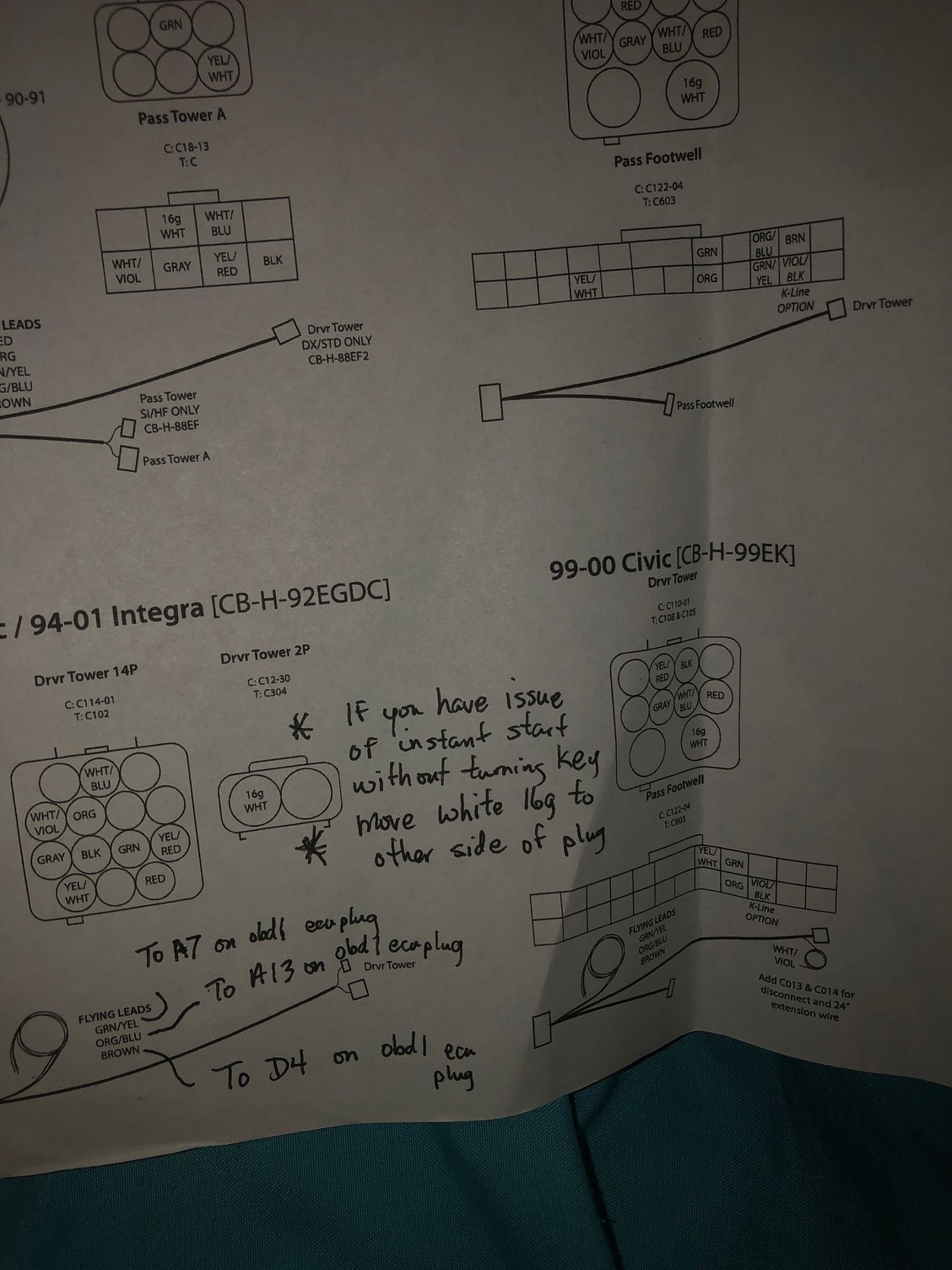

Default Re: Code 16 jdm h22a swapped EG hatch
I didnt get what those flying leads means
