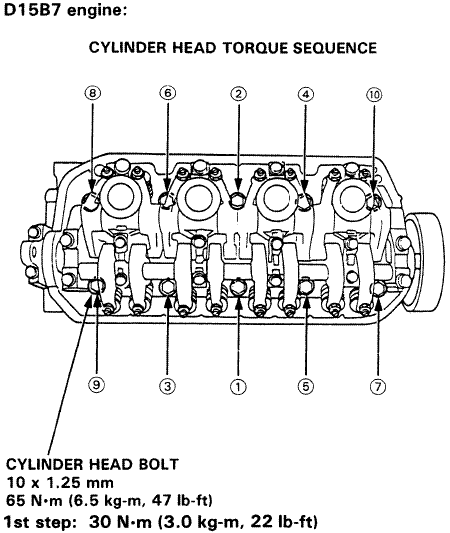

Tell me the exact procedure you used to re-torque the head bolts, this shouldn't have been necessary and if not done properly could warp the head or cause head gasket sealing issues.

I tightened down the right side of the motor in a criss-cross style, following the book, but I just checked the other bolts on the left side of the head and went a little bit more on the side that was leaking. Do you know anything about "stretching" head bolts? I heard that could be the case and it wouldn't seal right after that. Granted these are the original head bolts from 94, so I ordered new ones to be sure.

I would seriously consider having that head checked at this point. I dont know what book you looked at for this but Honda heads are tightened from the center out....See Below
Any other way and Id be afraid the head may have warped. Or if your very very lucky just caused massive sealing problems and immediately blowing your HG
