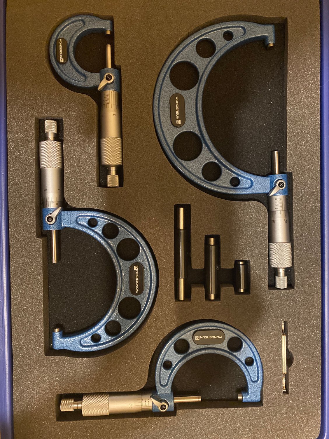

I was wondering if my b18 b crank is within spec
crank mains
1) 2.1647
2) 2.1646
3) 2.1642
4) 2.1647
5) 2.1648
crank rod
1) 1.7958
2) 1.7956
3) 1.7955
4) 1.7957
these are the measurements I got using my micrometer. This is the first time I’m doing this. Does anyone know if it is within spec? I bought the acl race bearings for my build. I will be micing the block soon I will post up with that too when I do it.

Did you use a ball micrometer or attachment to your micrometer?

No ball micrometer I used this set I bought on amazon. And also what is a fsm is that a manual for the b18? if so I do not have. Are these micrometers not good for measurement on a crank

Sorry, I was thinking about measuring the bearings. Your micrometers are just fine for the journals of the crank.
