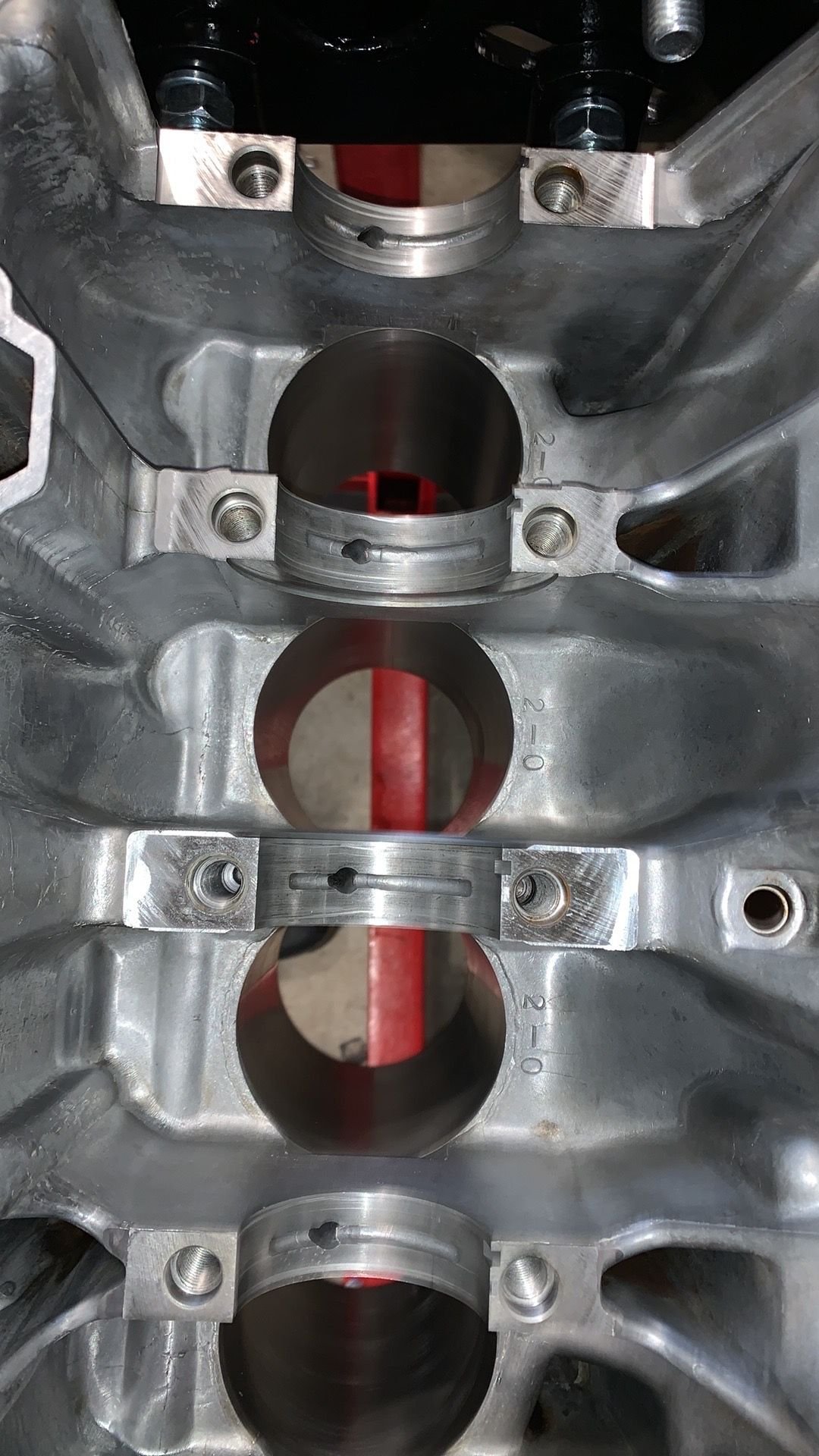

So I have a css b18 block that has some scoring that barely catches finger nail should it be line bored?

I would send it to the machine shop with your mains and have them check it. But I would go on the side of caution since it’s about catching your finger nail and say go ahead and plan in doing it.
