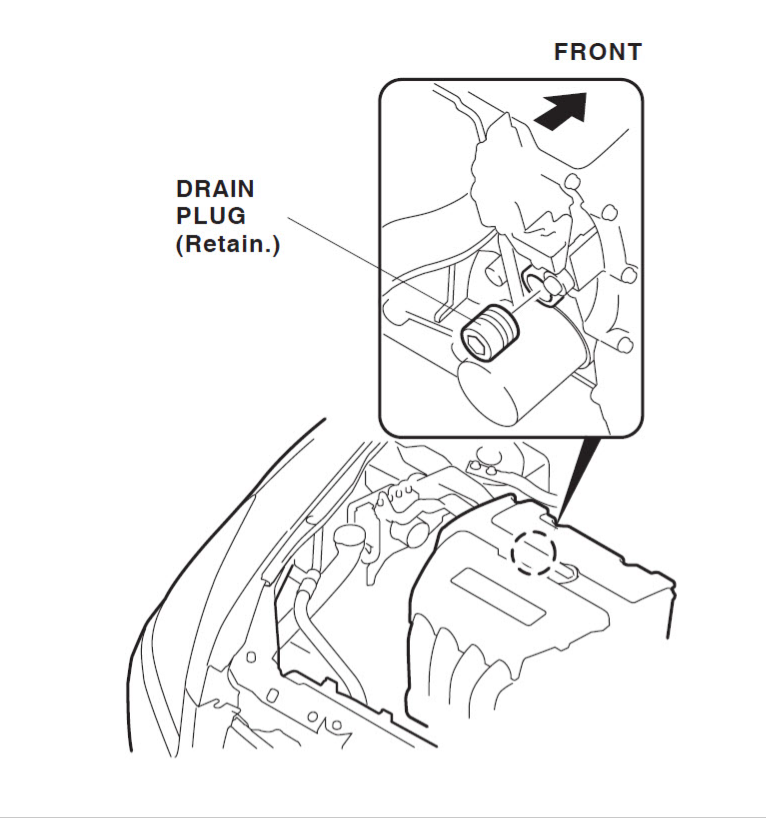

Strange the picture calls it a drain plug?

Originally Posted by Ryanthegreat1
That's a blind theaded hole on every K series I have looked at. It's where the block heater would go. No communication to the coolant passage.
That’s funny because I just removed this drain plug on my Aunt’s 2005 2005 Honda CR-V and a bunch of coolant came out. There’s a plug with a 10mm Allen hole. It was really easy to get out from above with a 6” extension. I filled the radiator with distilled water and eventually it started draining again from the block drain. I let it all drain out from the radiator and the closed the radiator drain and filled with coolant until it started draining out the engine and then I put the plug back in.

Originally Posted by chidog
If I ever have to do an overhaul on one of these engines, the first thing I do is machine a proper block drain plug, or two.
You might want to check because mine was a drain plug. You need a 10mm allen socket. just take a photo with your phone if you are unsure
