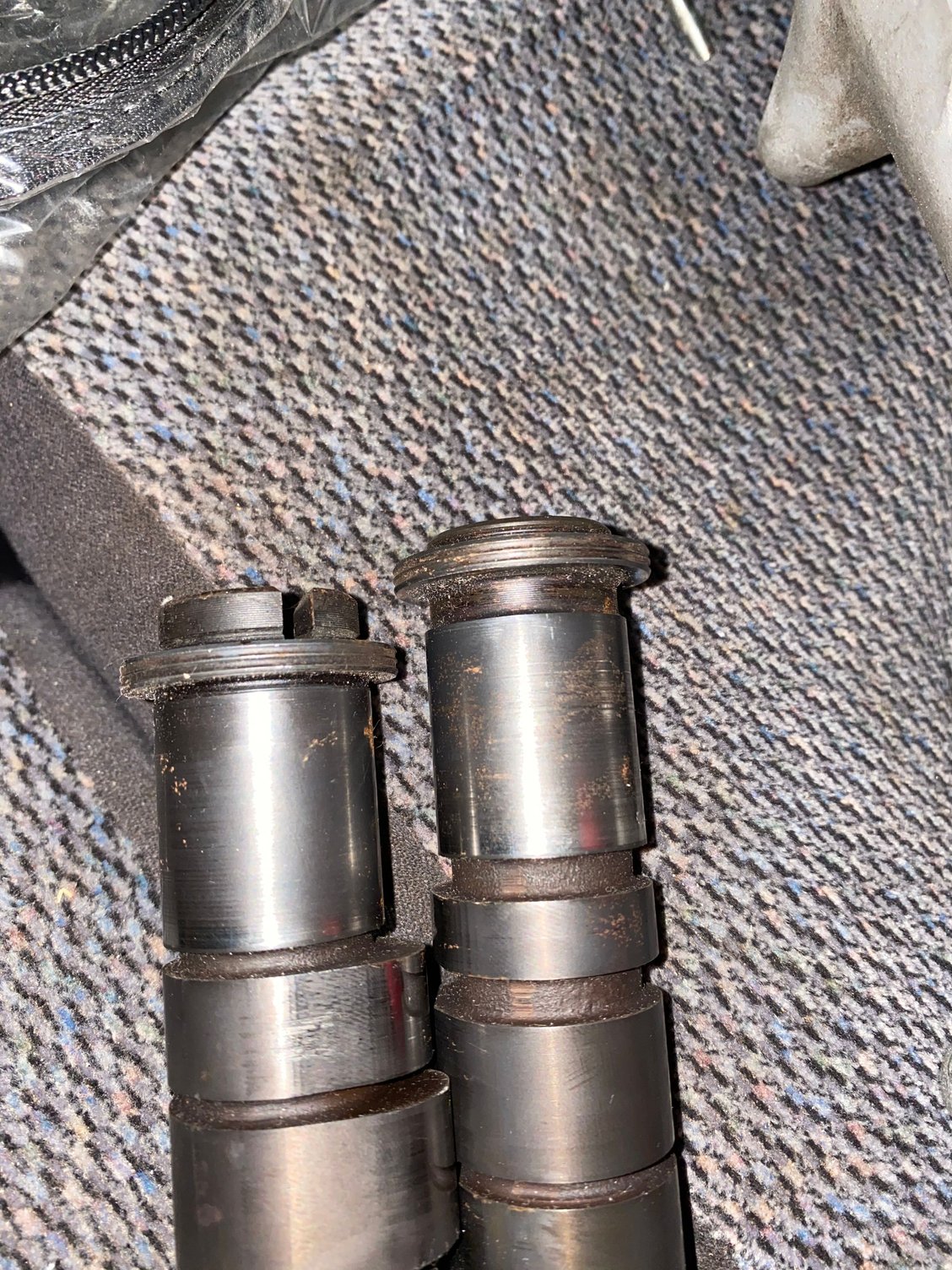

I got some camshafts for free a friend had laying around , he doesn’t know what engine they go to and I don’t either. If someone could help it would be much appreci

those are 95-00 jdm type r / 97-99 us type r intake cam
and 98-00 ctr exhaust cam.
You got some rare Oem cams and on top of that their f*cking FREE!!! Lol 👍
I paid $280 for my ctr cams.

What ?!? The camshafts pictured above are '94-99 USDM GSR... not Type R cams.

Whoops!!! I take that back they’re not type r’s I did not see that middle mark.
