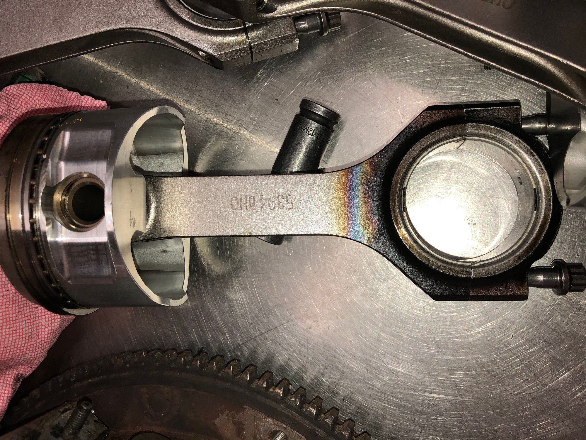

Not sure if the block can be saved, crank is done and this rod is shot.
Already picked up a new crank and going to see about the block being saved when I talk to the machine shop tomorrow.
Originally Posted by JRCivic1
Assuming the extra crankshaft is in good shape, you will lay this into the existing block and replace the main and rod bearings with proper ones to match the block and crank markings. If the original knocking rod is discolored or the bearing has damaged the bearing surface, you will need to re-size the rod at minimum... you may want to replace the set of rods if it is too damaged. Post a pic of the rod big end here and let's take a look.
What do you think man?!

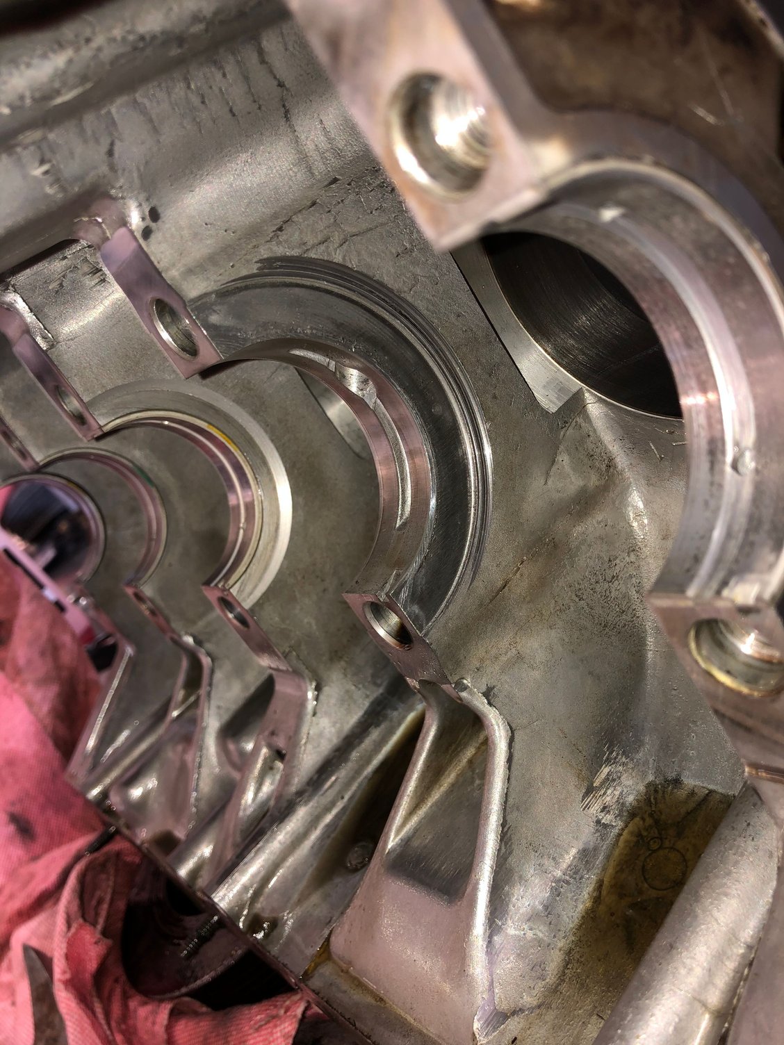

Were there thrust bearings in the engine ? The deep gouge in the flywheel side of the #4 main bearing journal doesn't look good. The first thing I would do is see if you can get the correct free-play measurement in that block using the replacement crankshaft and a fresh set of OE thrust shims. If so, then the block is OK. If there is too much movement/thrust... the block is trashed, unless a machine shop can weld up and re-machine the thrust shim pocket to get the gaps correct.
You might be able to re-size the rod, but that would change the rod length a few thousandths and reduce compression in that cylinder a bit... not optimum for an engine you want to run proper. Replace the rods (Eagle **** is cheap anyway... there are plenty of $375 rod sets to get you back in the game correctly), use OE Honda bearings and get it right.

Dropped it off at the machine shop today. They said the block can be salvaged, they also said I could re use the rod if I was on a budget but ima get a new rod, found one for $100 new.
they are gonna polish the crank and balance it and hone the block and clean it up and measure everything. Then Ima get it back and assemble it.
