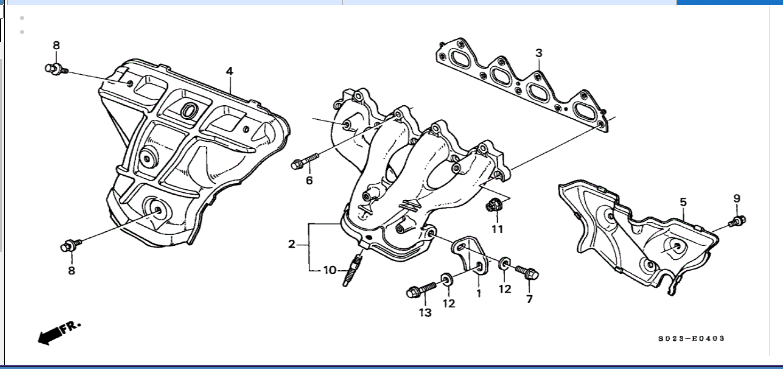

Example - Let's do an exhaust manifold bolt for your B16, for an EM1 Civic. Part 6 in the catalog:

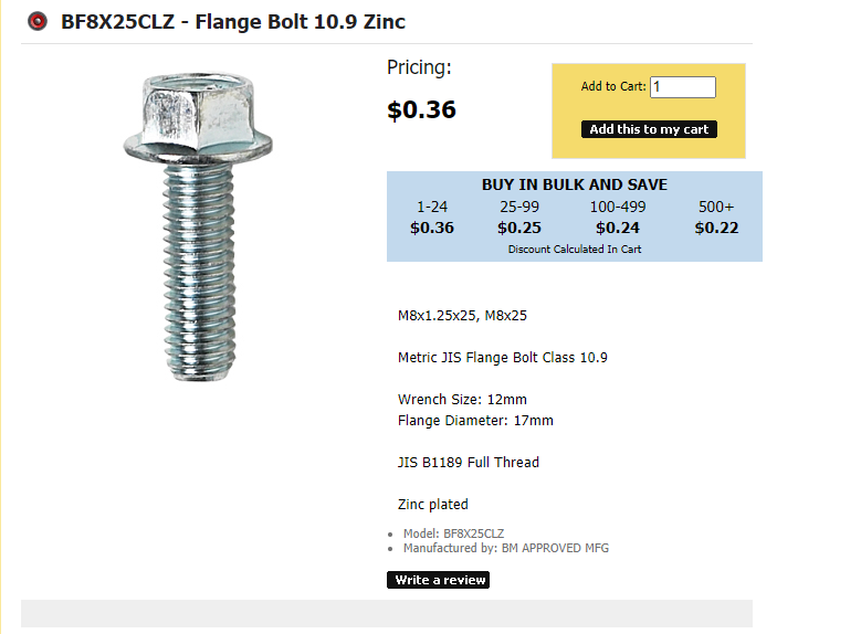

is an M8x1.25x25 flange bolt. Probably an 8.8. You'll have to use your own judgement on thread pitch, they only list by diameter and length, Most are pretty typical threads but you should always check. This is why you look at what you already have. Bonus tip - anything labeled as "special" you need to just get at a dealer.
Most of the typical bolts will be JIS small wrench type as outlined here: https://www.engineeringtoolbox.com/m...ze-d_1458.html
JIS small wrench hardware is usually easy to spot as it should have the indented head, much of it is also embossed with the classification as well, or at least some sort of marking that indicates it.
Here's your bolt:
Should look just about the same as the bolt you pulled off of the car. The difference will be in age and plating type. Modern Honda fasteners are silver zinc plated. The older stuff was cadmium plated, which was a better plating but uses a highly toxic process and is hardly used anymore except for aerospace where it is really only called out out of tradition. Zinc is mostly universal now.
